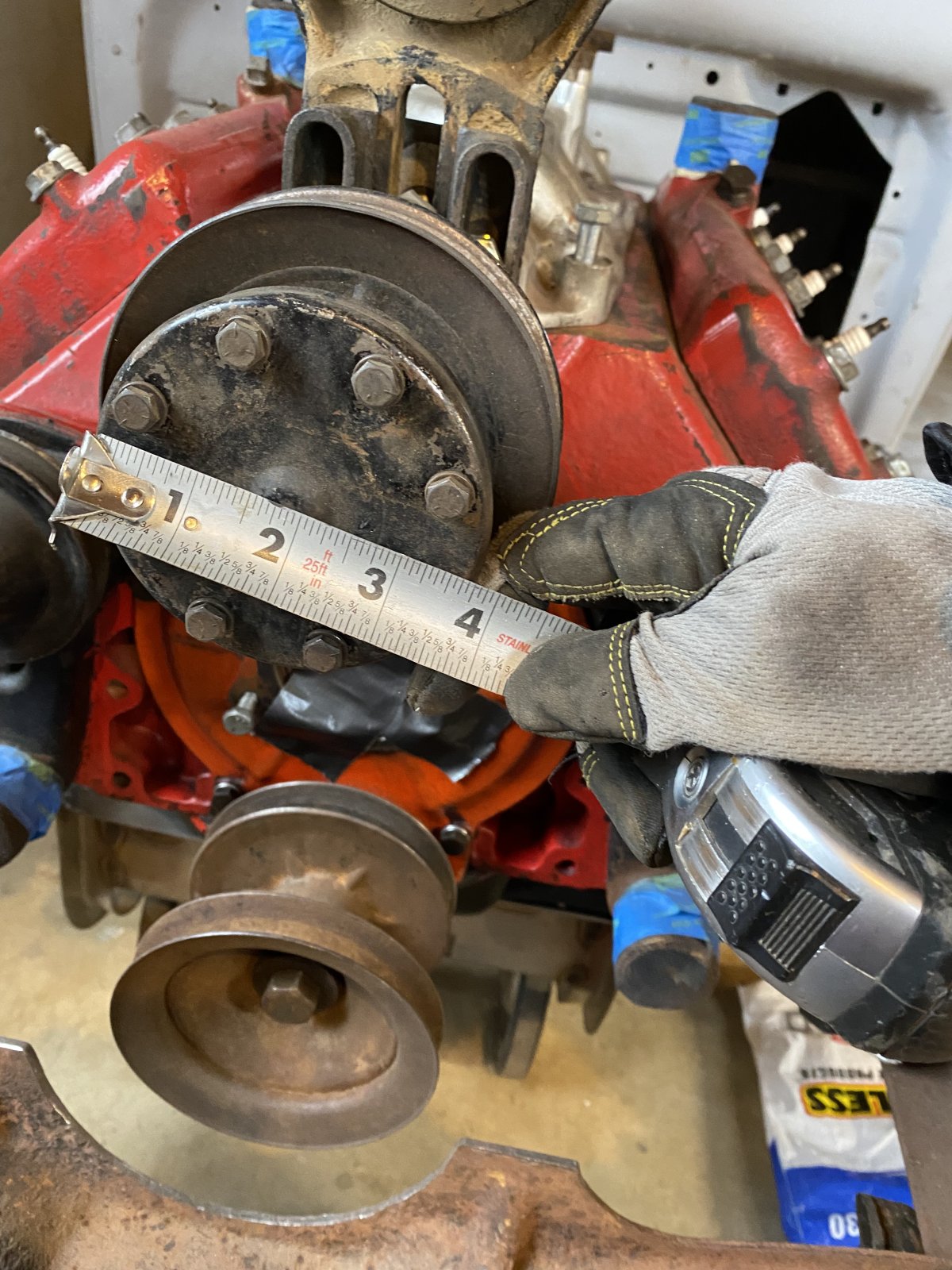

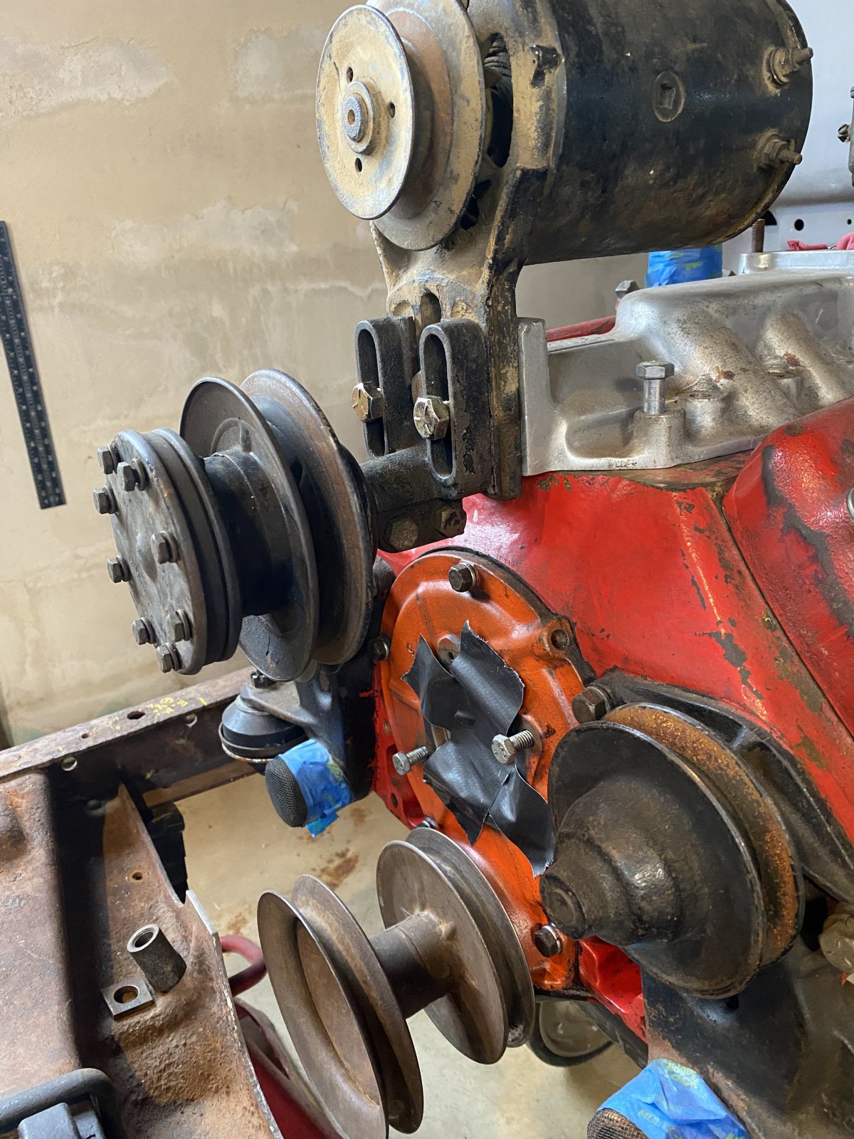

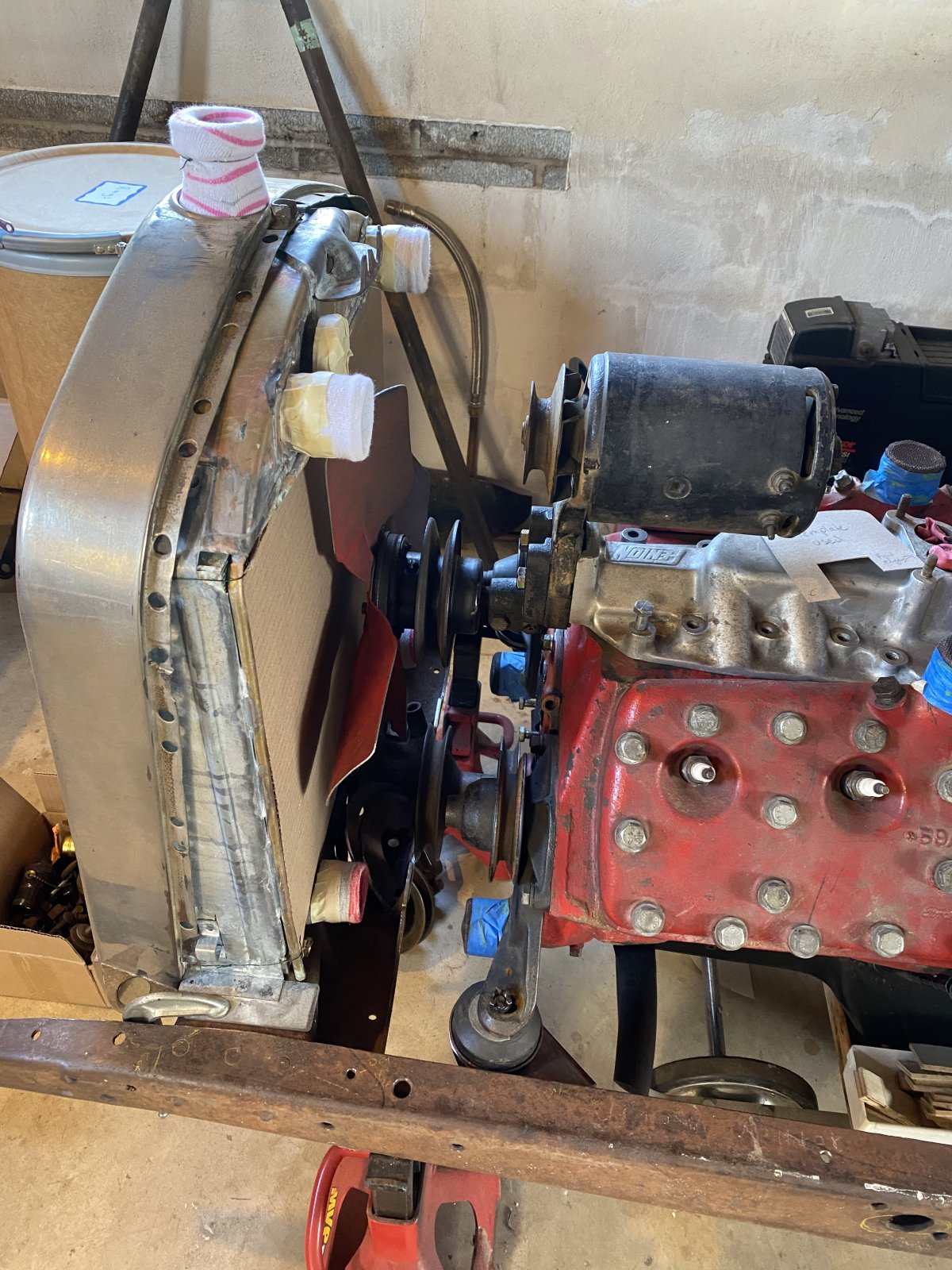

    I am stumped on fan selection for my 59AB flathead on my Av8 T roadster. I was wondering if the more knowledgeable could point me in the right direction.

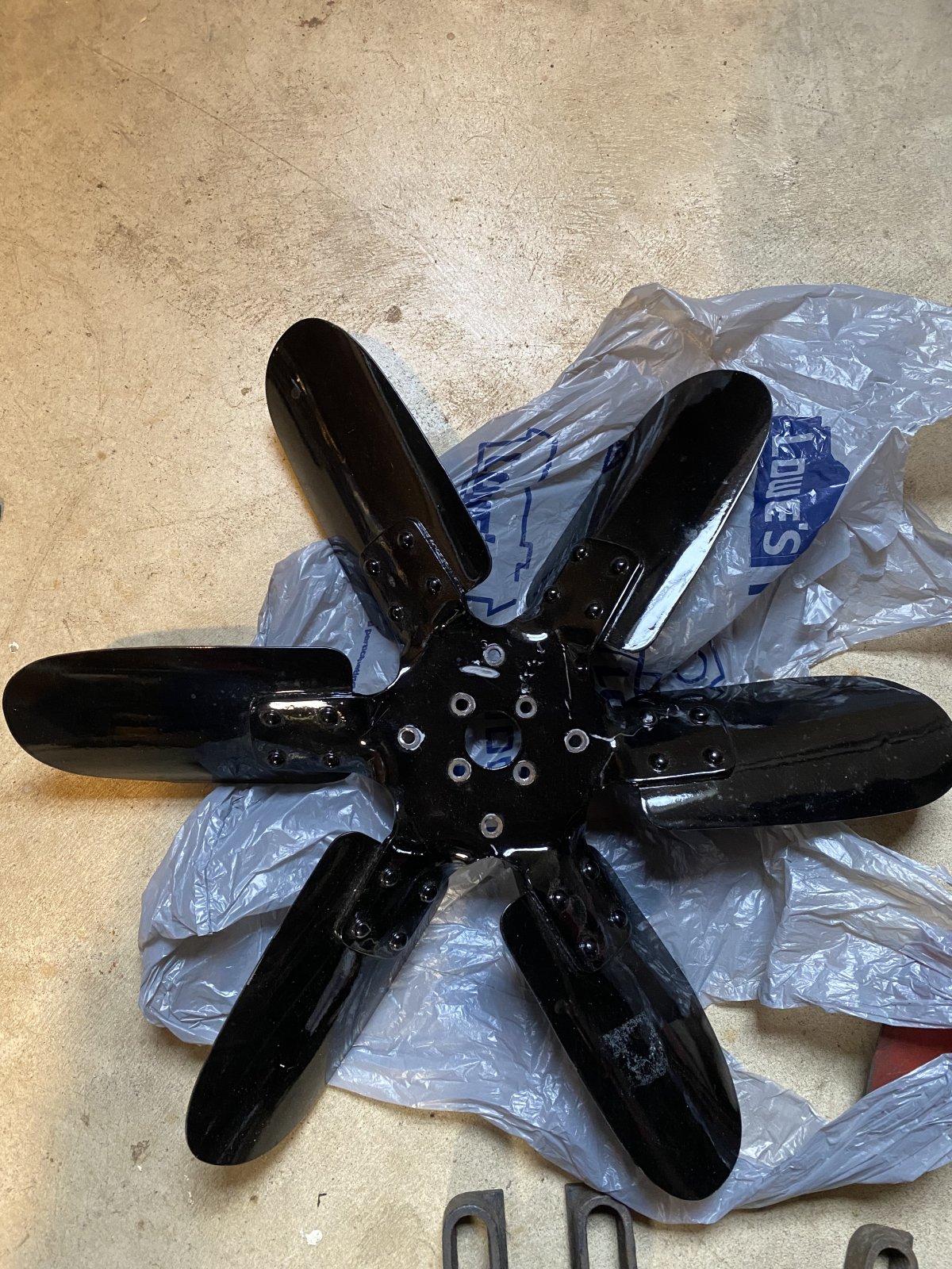

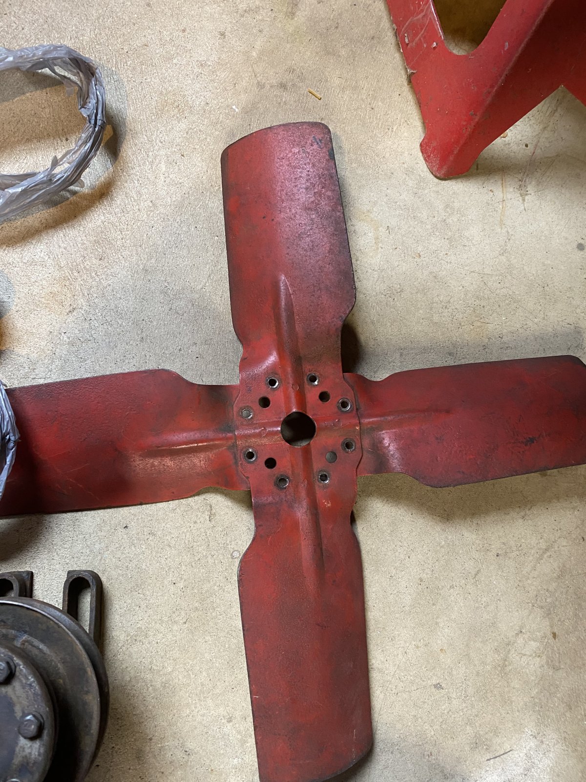

    The car is 26 roadster, 28 un-altered model a frame. Engine is 59AB with the intake mounted generator. Small and compact fan is crucial for the build. For this I am going with a fan hub that mounts below the generator but above the crab trap and has up down adjustment. My trouble is the original 4 blade fan is too large at 18.5”. Did Ford have any other smaller fans that bolt to this style hub size and bolt pattern ? For example, I have a handsome 15.25” 40 ford 6 blade fan that would be perfect but bolt pattern and the small size of the fan center prevents it from mating with the hub. Thoughts?

    Thanks, that would put the fan too high on the rad… into the top tank. This is a model T body and a model t rad/shell.

    Make a template and trim blades down.

    Yes t******* the 4 blade is plan B. It’s going to be open engine car so I prefer the look of the 6 blade over the other 4 blade… but trim to fit is certainly on the table…

    I had a 6 bladed fan on my flatty and it sounded like a ******** jet engine. I couldn't hear it when it was running and because this one runs somewhat to the cool side I changed it out for a 4 bladed. Now I can hear it. Still runs cool. I wouldn't run the 6 blade unless I had cooling issues and had to.

    I run a 6 blade 18 in. stainless steel flex I bought from Super Shops years ago on my 8BA with no noise.

    This. I cut my blades approx. 2". Balanced out fine and works great. Make a template and use it to mark out each blade. I used the center hub as my "true" point. Cut the blades on low speed band saw.

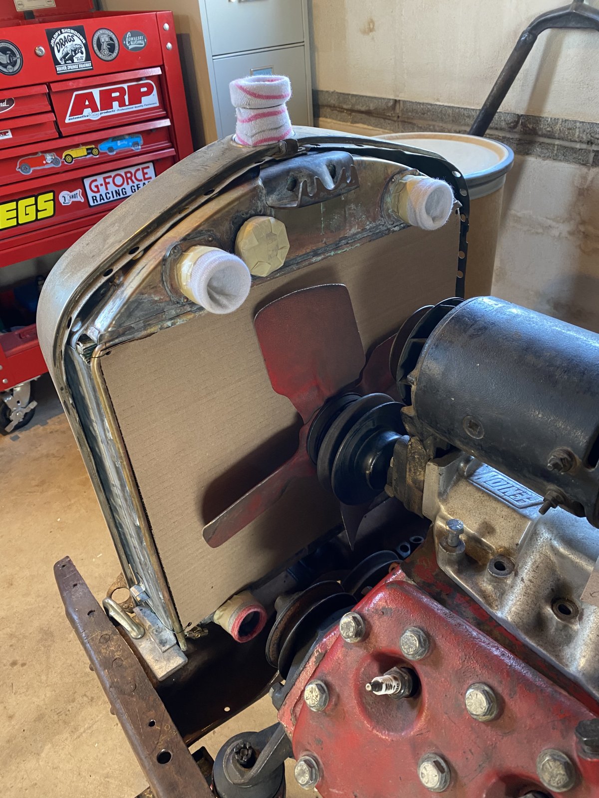

    I ended up cutting down the original fan. Turned out nice and it is certainly lighter. I left it a hair over 15” in length so I can balance it to width. Thanks for the recommendations. I will inspect it when I blast it.
    For a non-flex fan, what is the recommended distance between the fan and radiator? Mocked up it is 3/4”. Trying to keep it close so I do not have to notch my T firewall if possible for the breather/fuel pump.

    That fan turned out perfect man, that 3/4 in your shooting for should be awesome to pull the air through that radiator.

    Thats about where mine is 3/4 to 1" away. Seems to do a great job.
