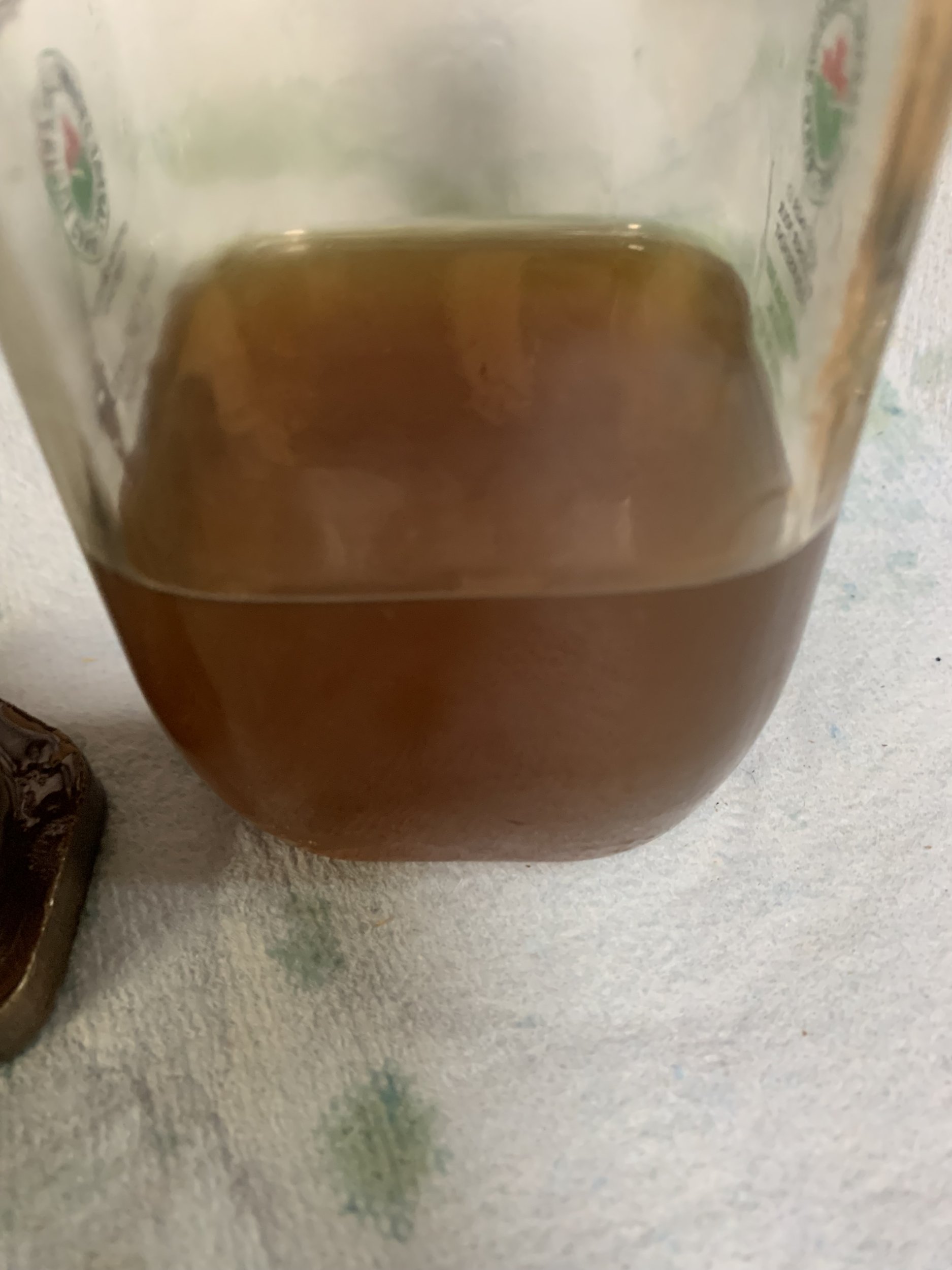

  4. Ziggster
    Joined: Aug 27, 2018
    Posts: 2,947
    Ziggster
    Yep. Will do for sure. Will have to wait until tomorrow though.
  5. Ziggster
    Posts: 2,947
    Ziggster
    Don’t know. I ***ume there is no way to tell really unless I pull the exhaust

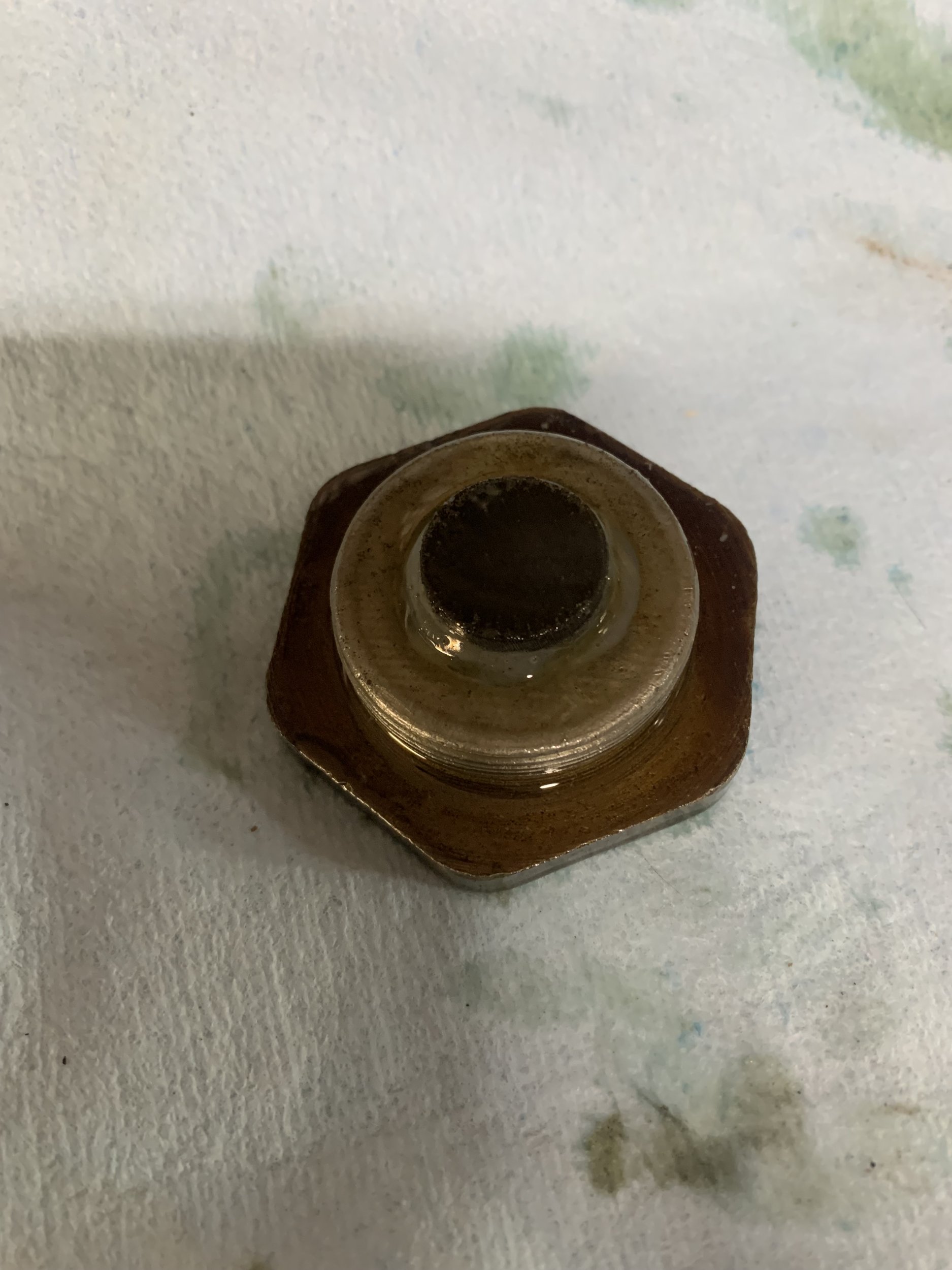

  6. Ziggster
    Posts: 2,947
    Ziggster
    Just drained the oil. Looks almost good enough to try a sip or two…
    Forgot I had added a magnet to the drain plug.
  7. Ziggster
    Posts: 2,947
    Ziggster
    Looking down the breather tube, I don’t smell any gas, but who knows at this point.

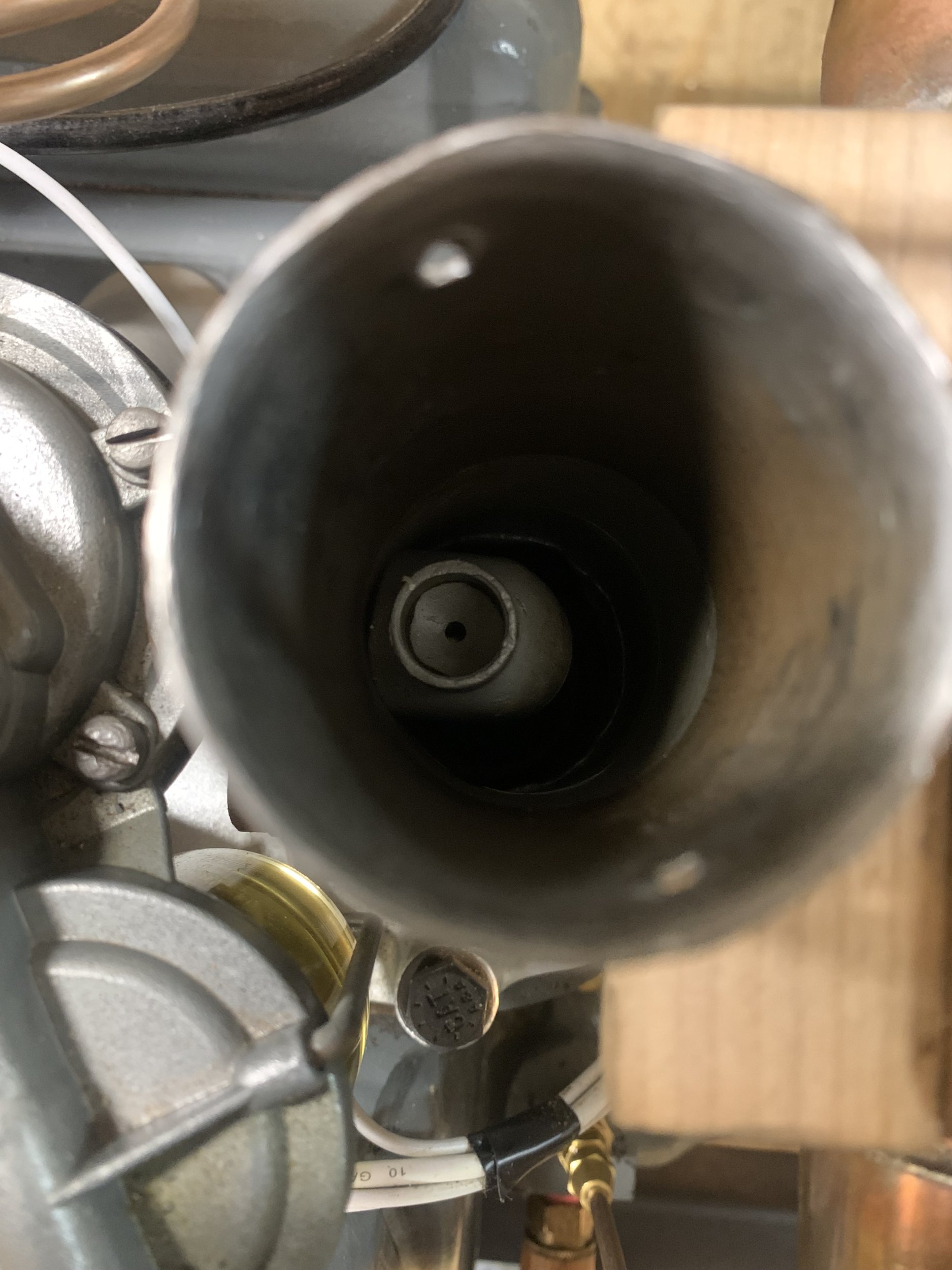

  8. Ziggster
    Posts: 2,947
    Ziggster
    Closer pic of fuel setup.

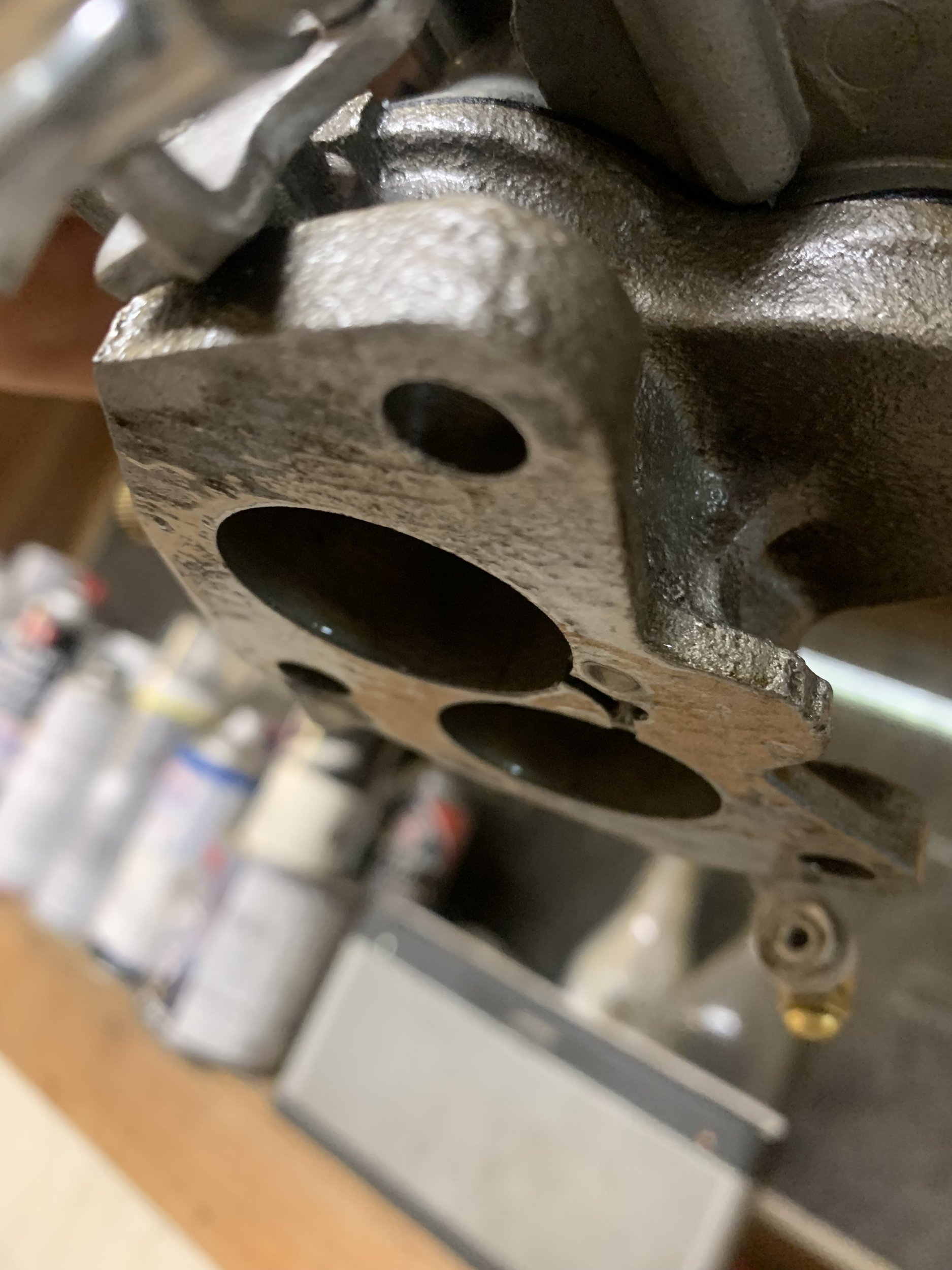

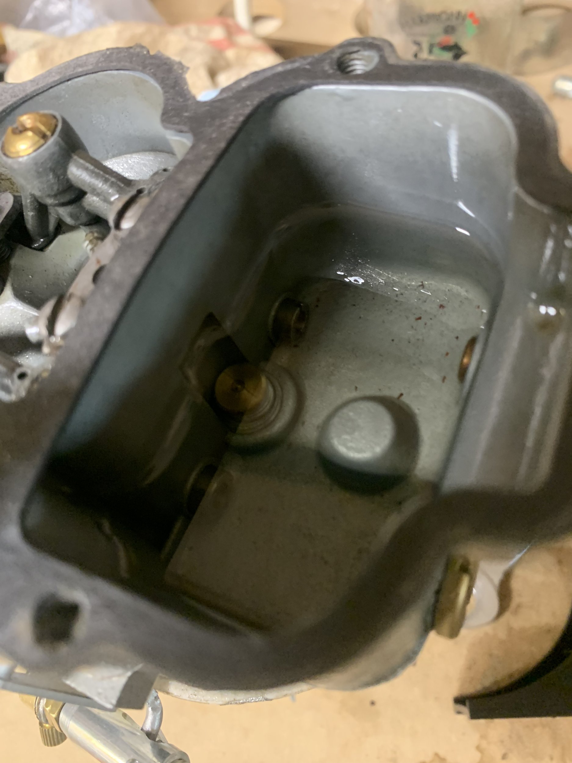

  16. Ziggster
    Posts: 2,947
    Ziggster
    Decided to pull the carb tonight. Separated the upper half and added about 1/2” to the fuel bowl. Almost immediately the face of the mating surface of the base is wet with fuel. Can’t see where the fuel is coming from yet.
  17. Ziggster
    Posts: 2,947
    Ziggster
    Now wondering if it could be the gasket between the base and the main body?
  18. big duece
    Joined: Jul 28, 2008
    Posts: 7,044
    big duece
    from kansas
    Also, check the gasket between the PV and bowl. At this point, every rock is worth turning over. Any Strombergs laying around...?

  21. big duece
    Posts: 7,044
    big duece
    from kansas
    I don't think the issue is wither the valve is open or closed under vacuum or not. The vacuum source for the power valve is right under the PV. IF, the gasket for the power valve OR the diaphragm in the power valve is damaged, it will leak gas down in the intake. All it takes is one good backfire and you can rupture that diaphragm. thumbnail - 2025-09-23T211011.593.jpg thumbnail - 2025-09-23T211021.719.jpg
    The cavity under the power valve is meant to be "dry" and just for vacuum the activate the PV. If you seperate the cast iron base from the bowl and its wet, you should find the culprit.
