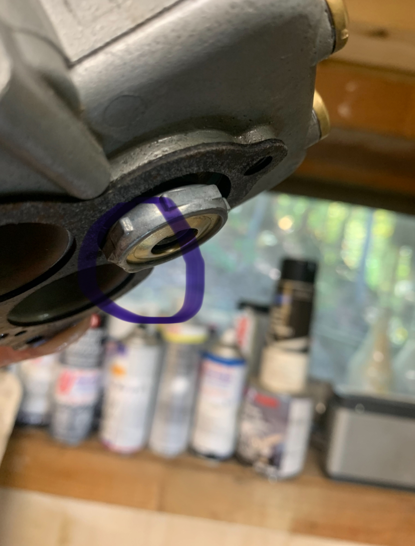

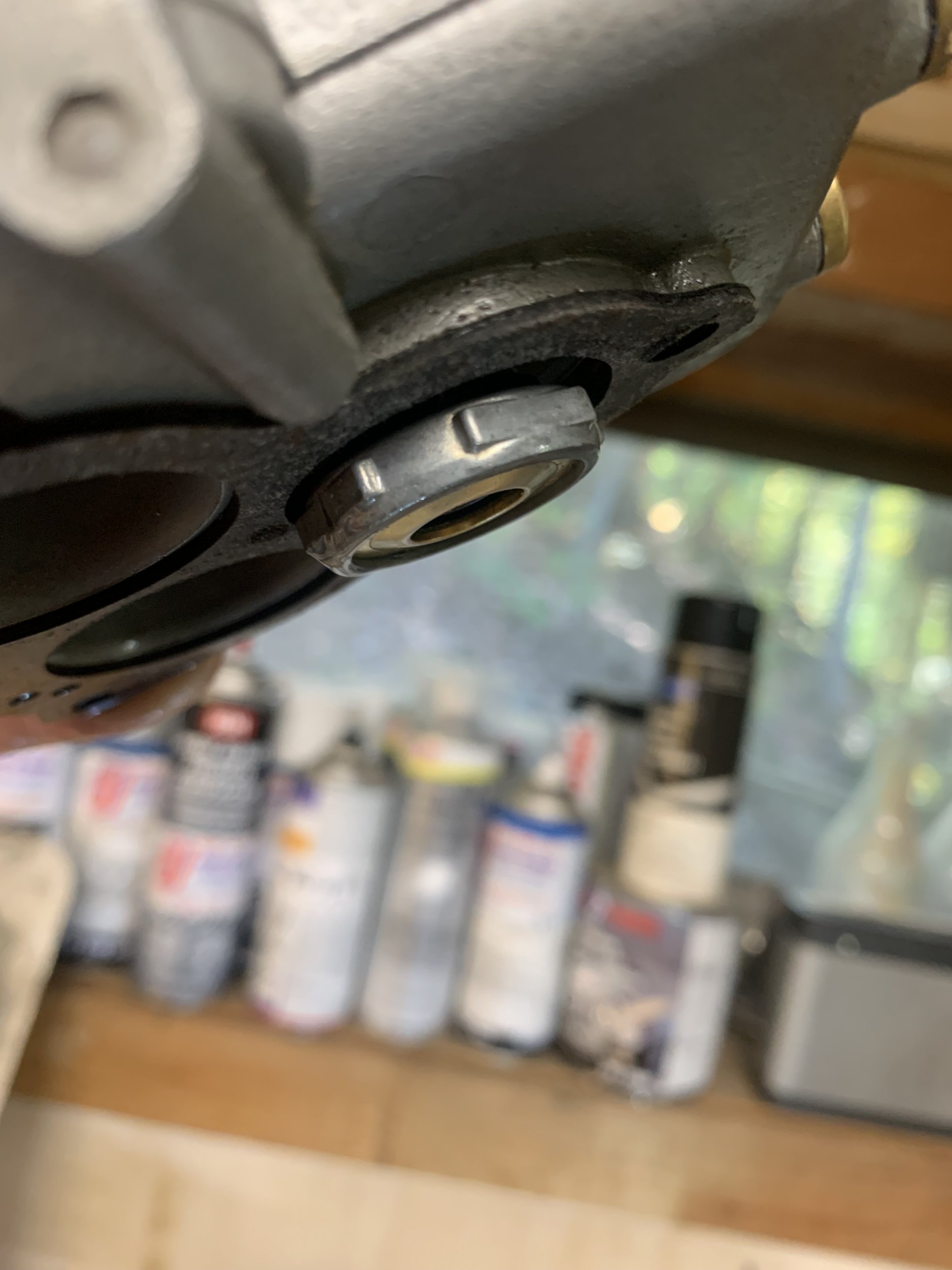

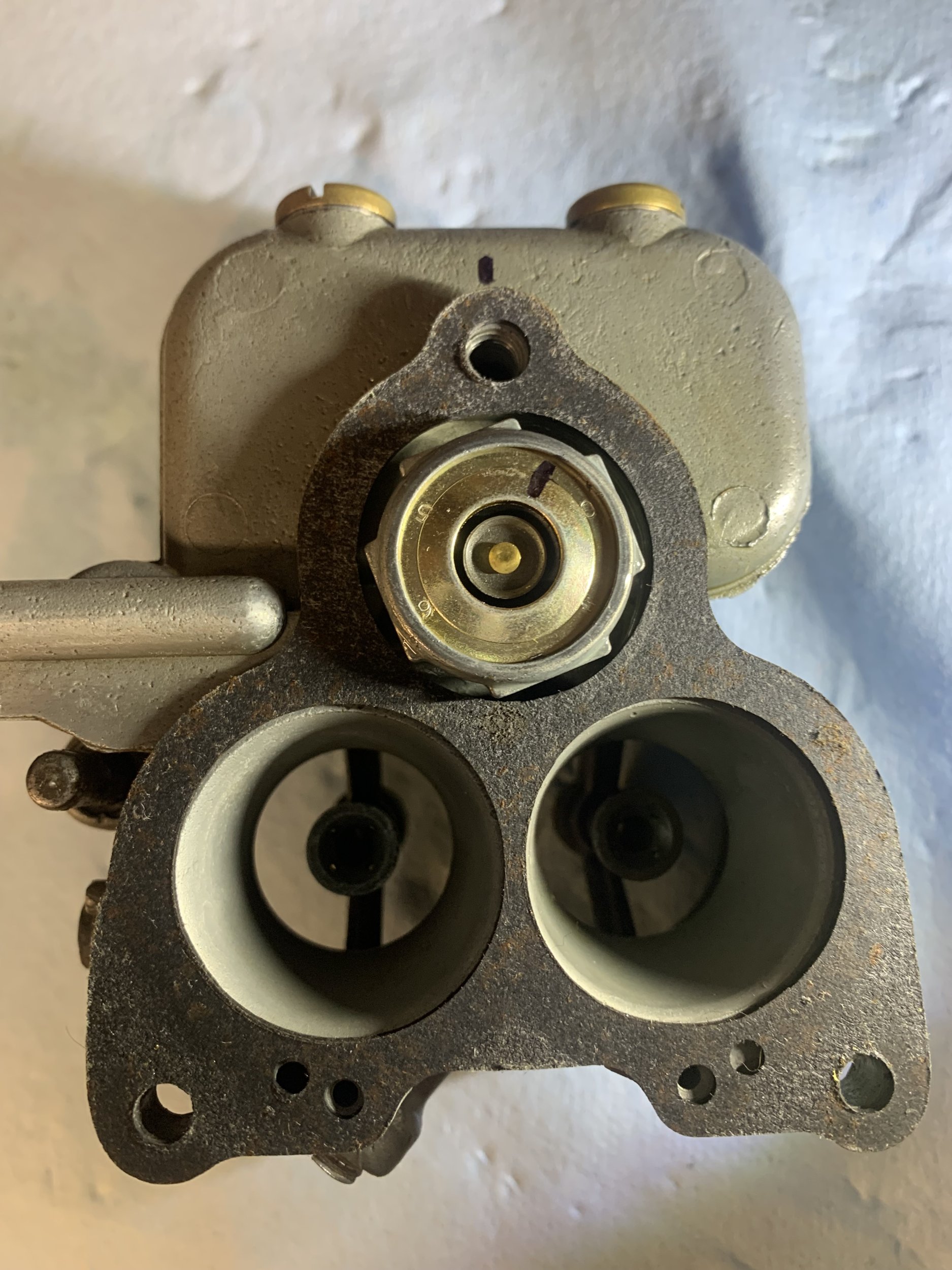

    Seems fuel is leaking past the outer seal of the PV. Filled bowl with just a tiny bit of fuel and tilted carb until PV was submerged. Noticed a drip on the outer edge of the PV almost immediately.
    Stogy and RodStRace like this.
  3. Ziggster
    Joined: Aug 27, 2018
    Posts: 3,059
    Ziggster
    Fuel drop circled.
    Stogy, clem, Squablow and 1 other person like this.

    Well, holy hell! Gave the PV not even a 1/4 more turn, and it seems to have stopped leaking so far!
    Stogy and big duece like this.

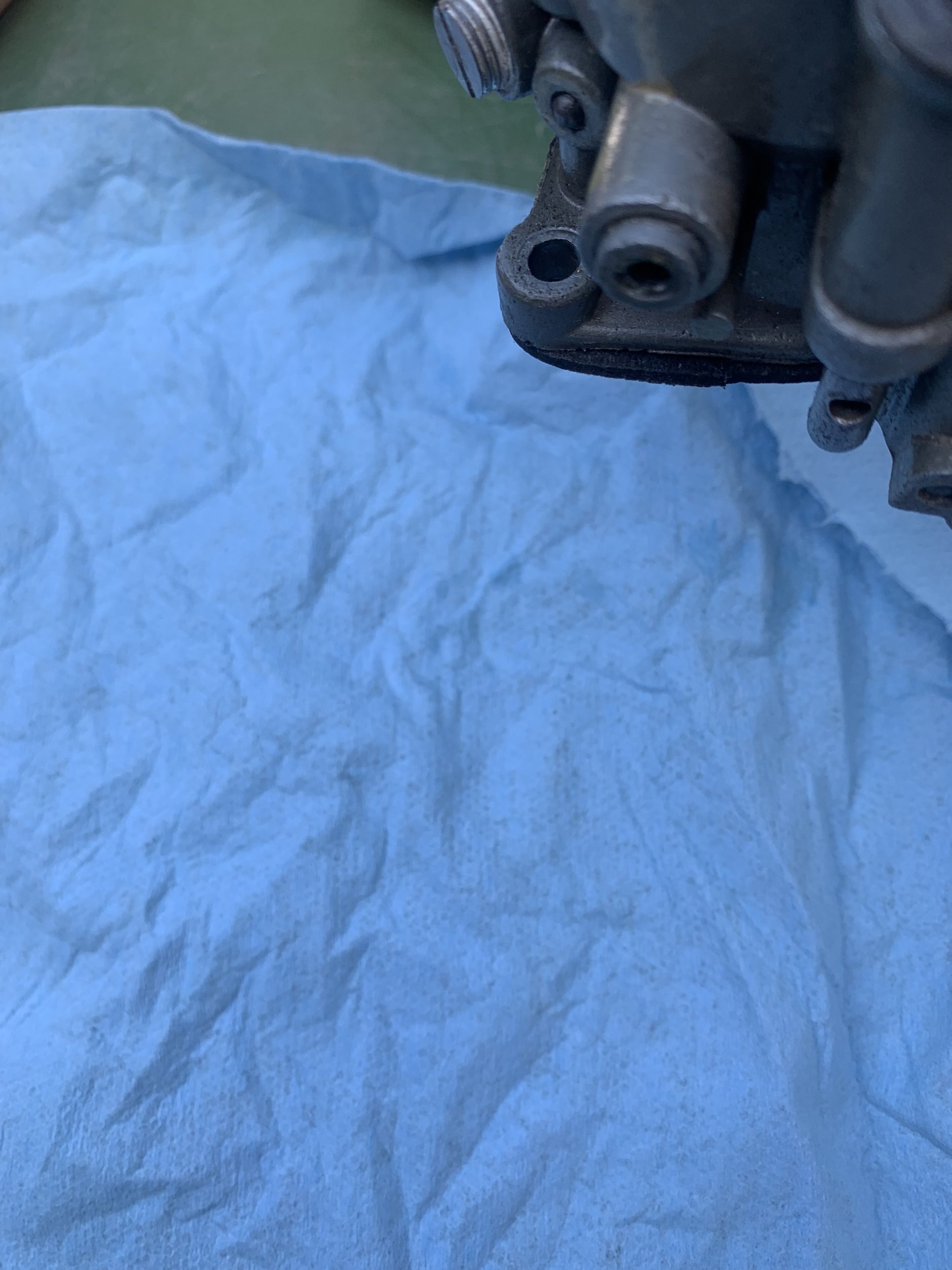

    I’m getting a beer or two to celebrate! No fuel on shop towel!

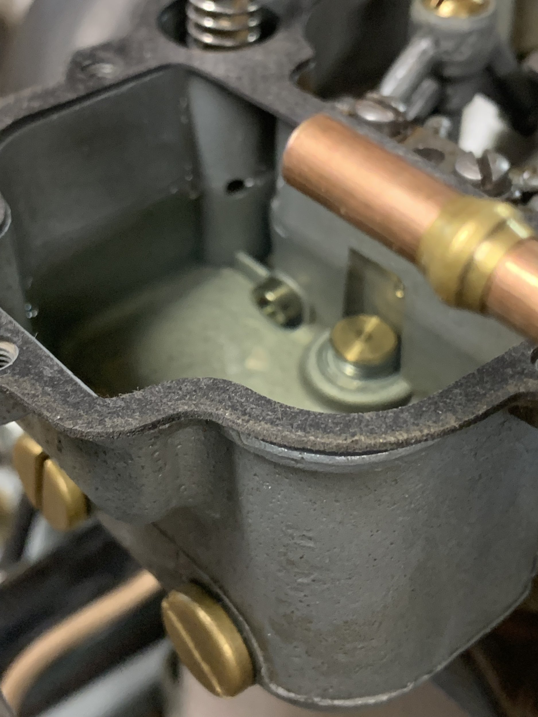

  10. Ziggster
    Posts: 3,059
    Ziggster

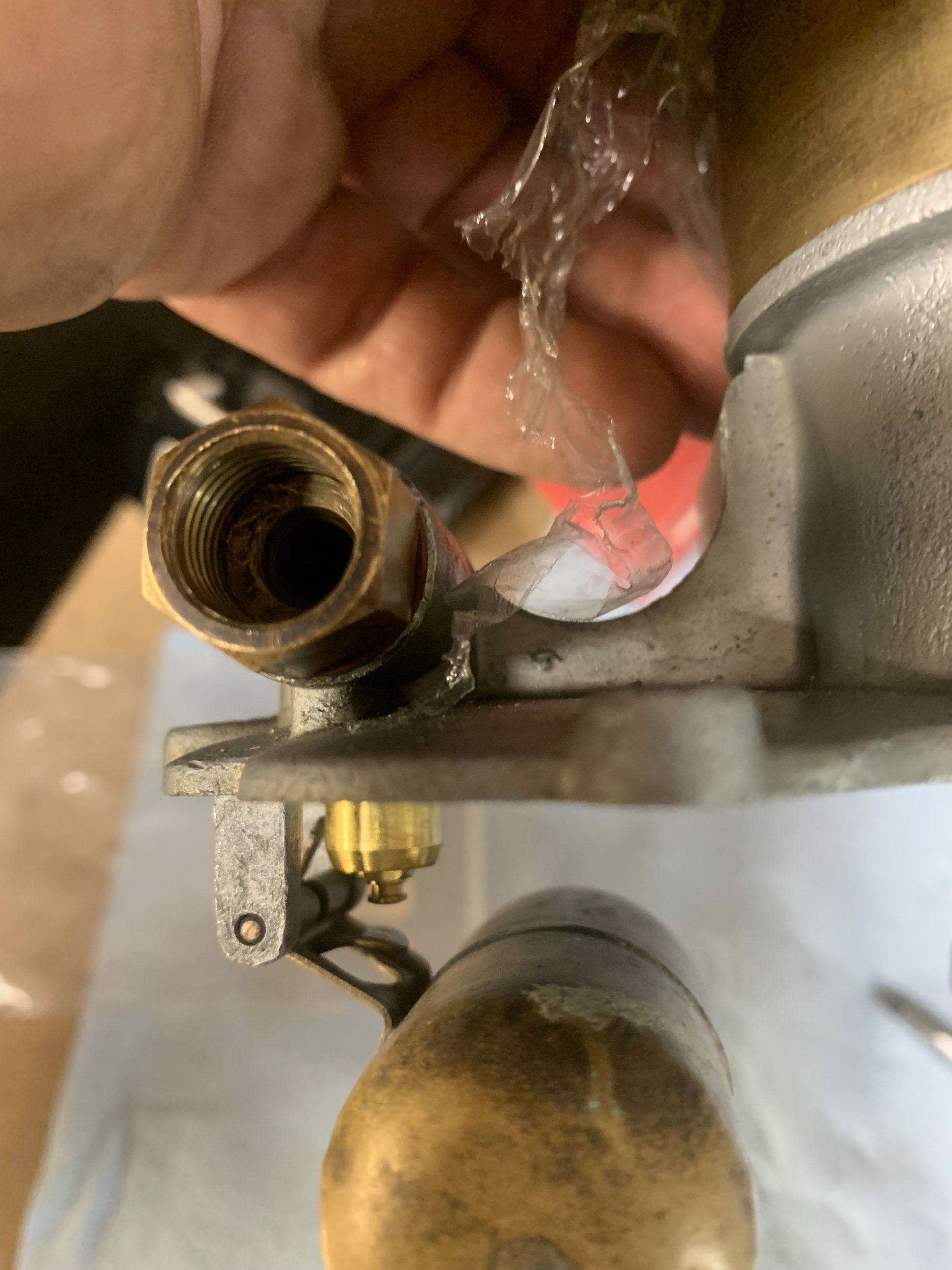

    Also noticed the new float needle is sticking a bit…
    Stogy and Squablow like this.
  11. RodStRace
    Joined: Dec 7, 2007
    Posts: 9,036
    RodStRace
    They can tend to do that, but remember, there is fluid under pressure behind it.
    Notice the little tab in the middle of the arm? That should restrict the needle drop. EDIT: Float level! There should be spec for that. Just understand the float only drops to the bottom of the bowl not as far as shown.
    That also is restricted by the arm touching the outside of the seat.
    Lots of little fiddly bits! :)
    Stogy, Ziggster and big duece like this.

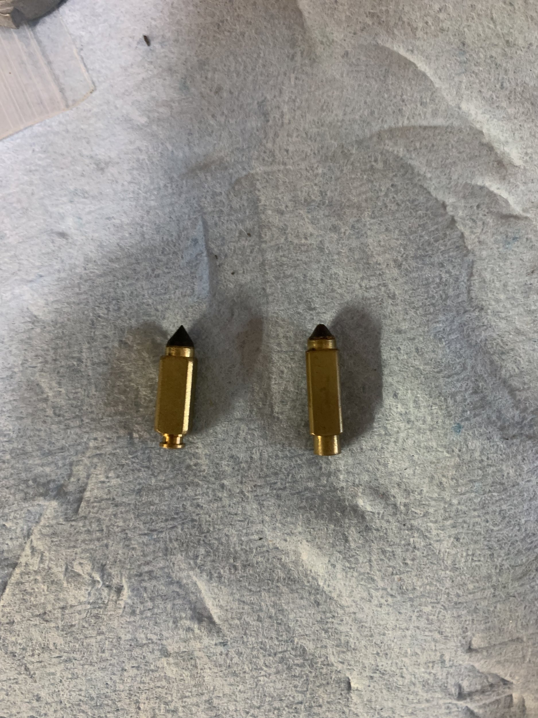

    The 2 needles look like they are different lengths and weights.
    Recheck float adjustment if swapping.

  13. Ziggster
    Posts: 3,059
    Ziggster
    Yeah. Needle on the left is the brand new one which is sticking. Have another on the right (not sure where it came from), and it doesn’t stick. Damn!

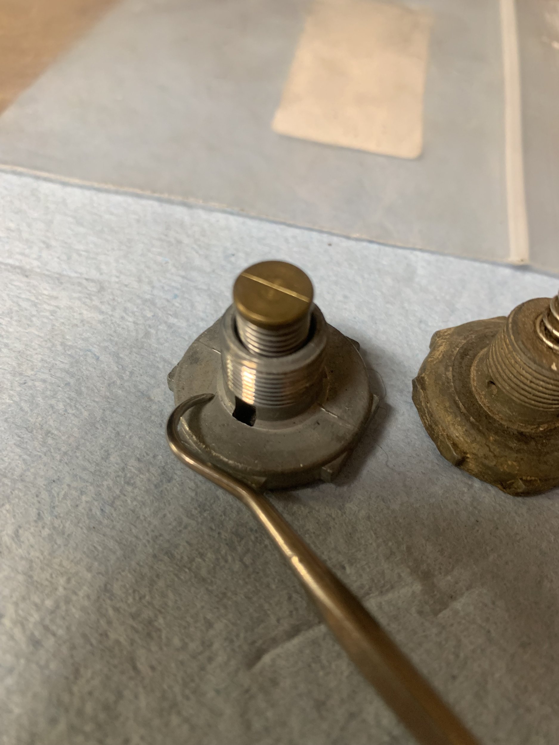

  15. Ziggster
    Posts: 3,059
    Ziggster

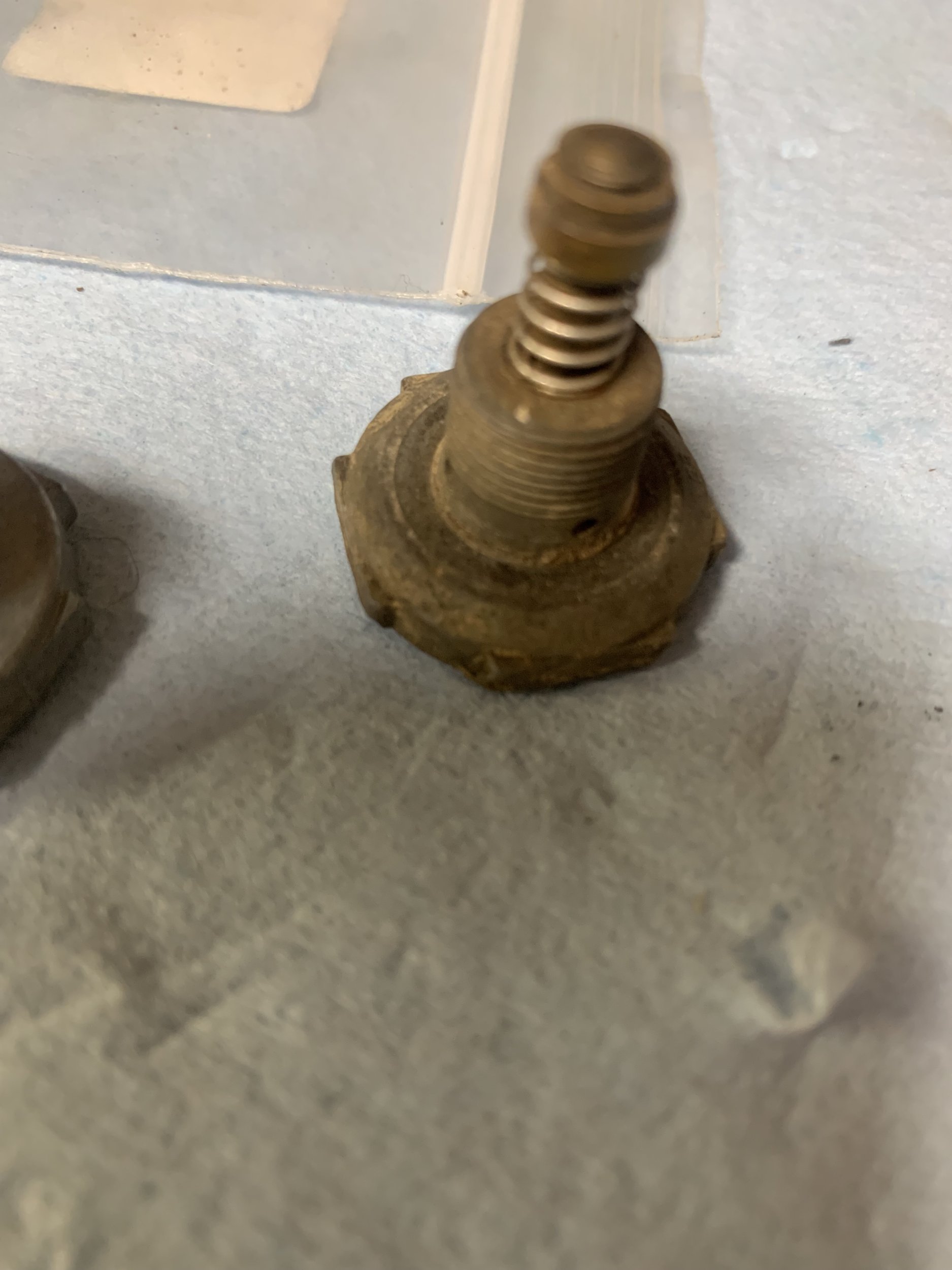

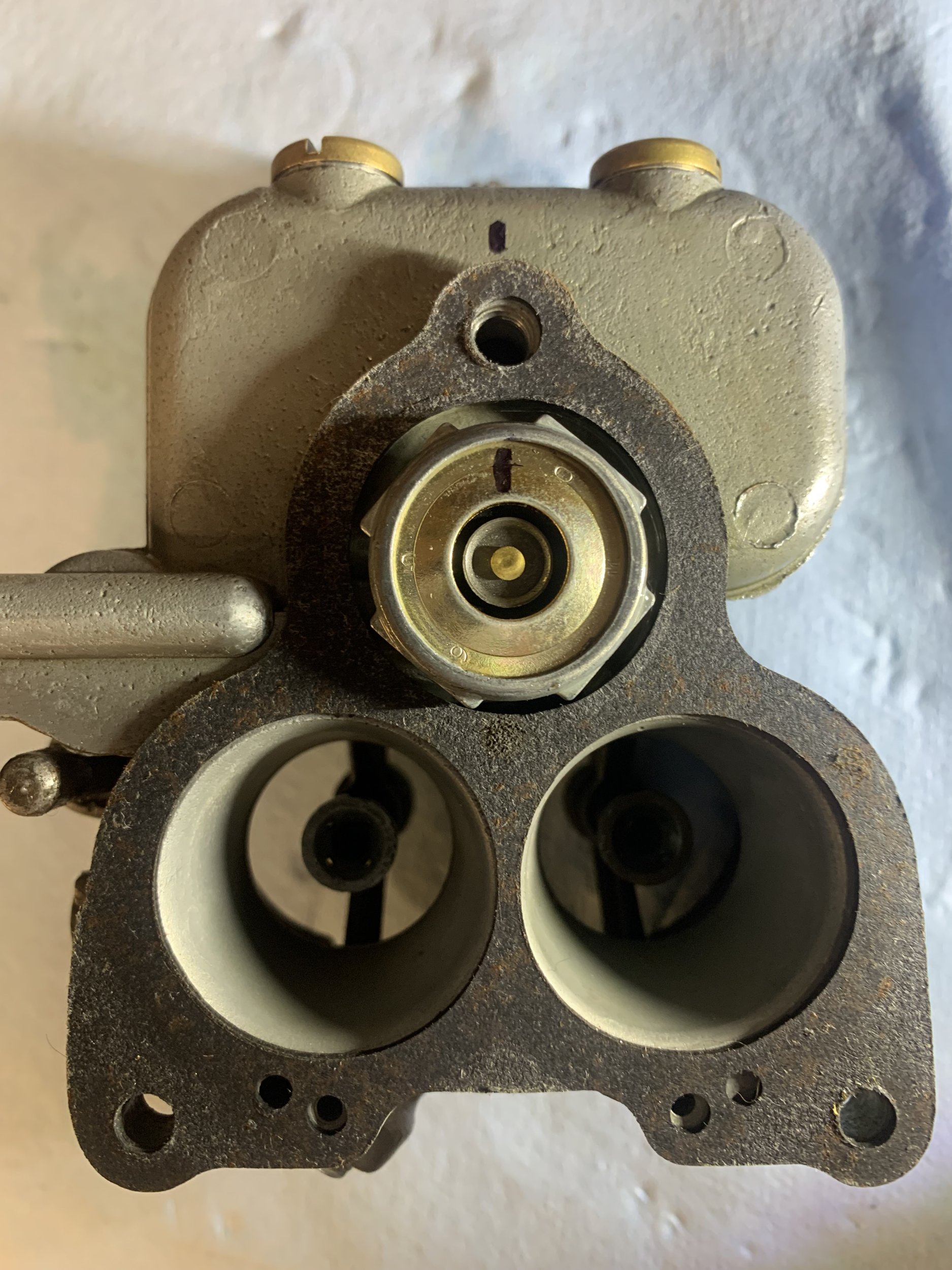

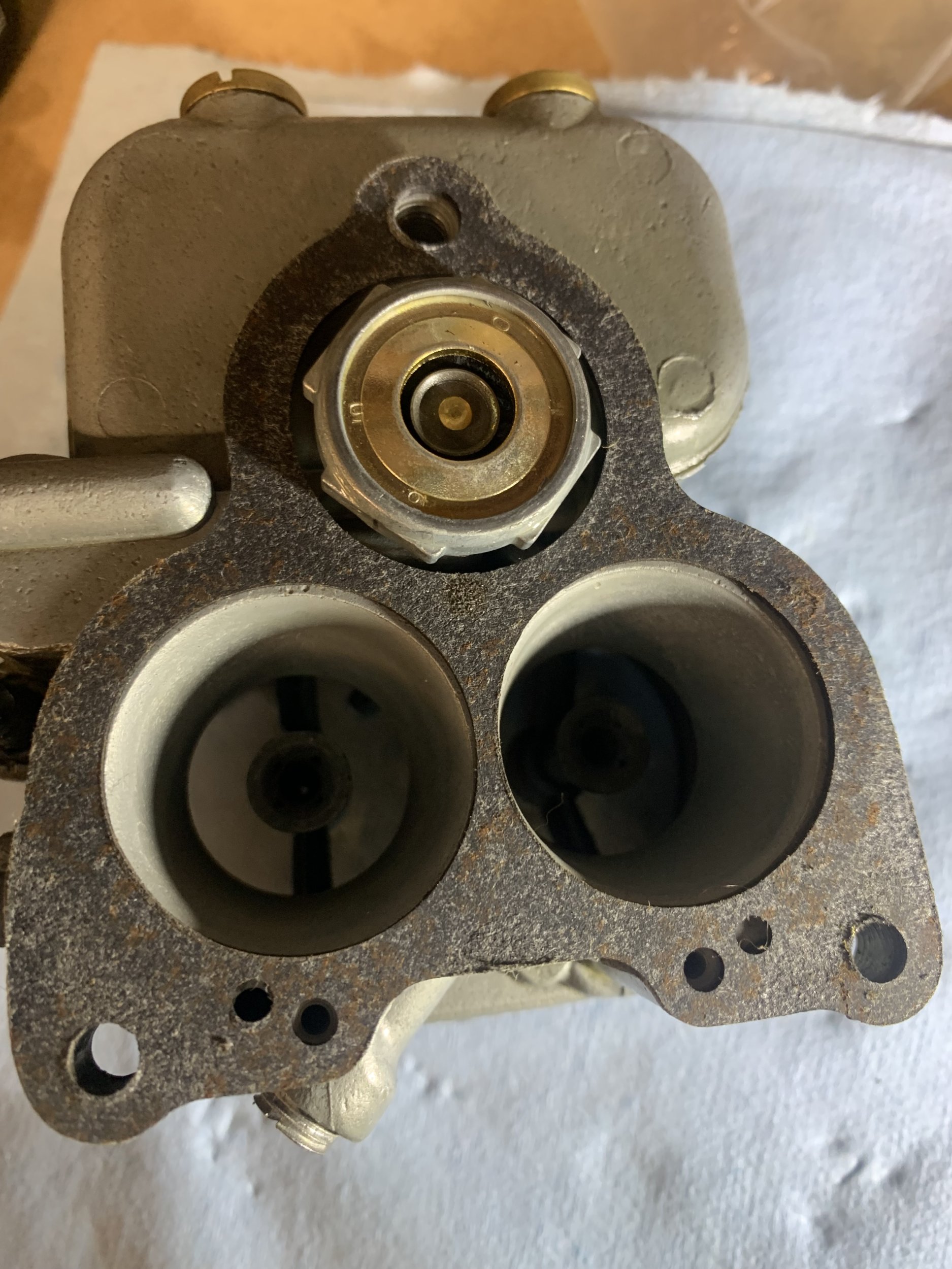

    Speaking of PVs, found the other new one. It had the dreaded radius. Original one for comparison.

    I was dealing with similar issues on my current project with a needle that looks identical. The needle would stick just slightly, but even the tiniest bit of pressure would dislodge it, and that fuel pump giving even 2 psi against the needle is more than enough to push it back out again, I don't think that's going to be an issue.

    I know it’s not equivalent, but when I blew on the inlet port it didn’t budge, so going with the other needle. It seats properly (at least when I try to blow through) it remains shut. We’ll see. So much freaking finicky **** to deal with.

  19. Ziggster
    Posts: 3,059
    Ziggster
    Fuel level dropped a couple mm, but throat looks dry, so I’m calling it GTG, and will add the top, then hit the pistons with some oil.

    Im glad you got it . The needle on the right is longer = heavier . I’ve found some new needles are a little on the large side , some 600 grit w&d on its edges fixes that problem, just a few seconds worth will do it .

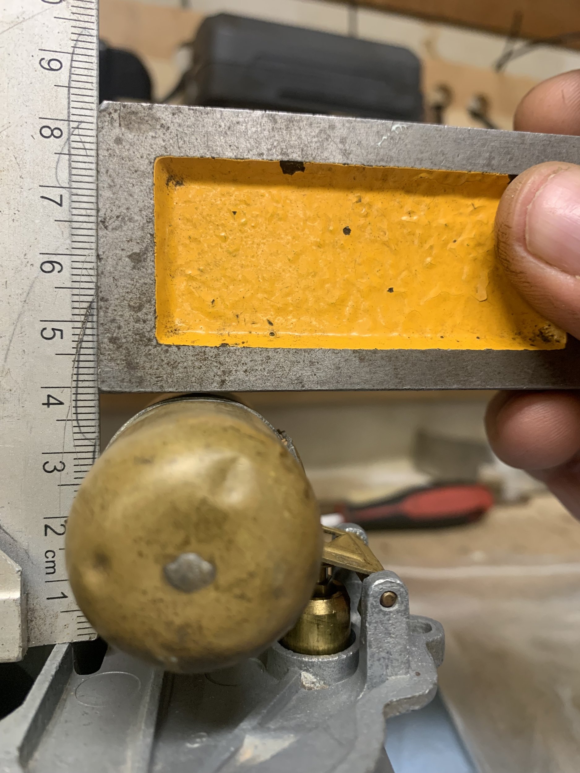

  21. Ziggster
    Posts: 3,059
    Ziggster

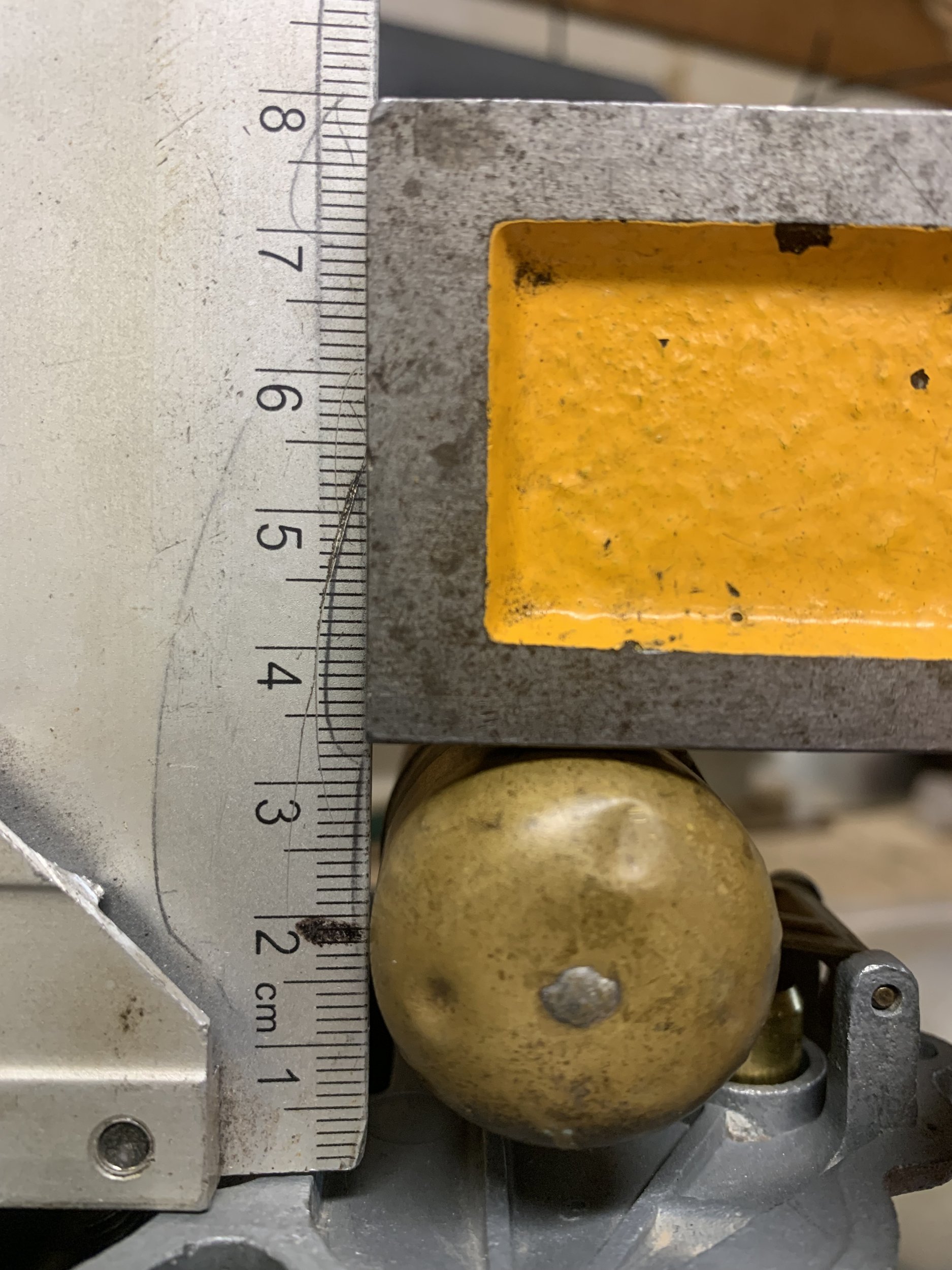

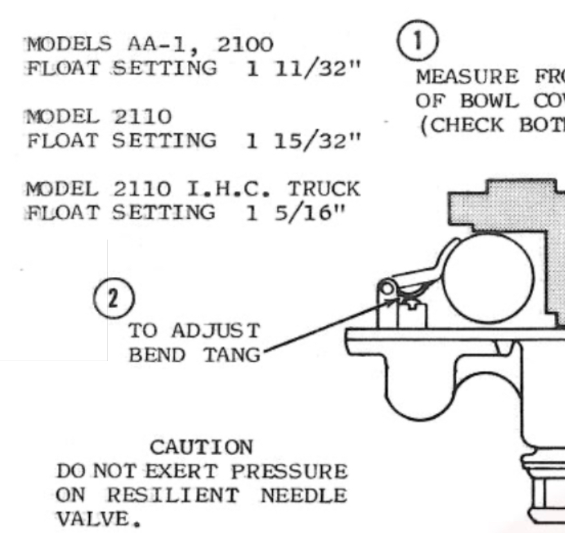

    Adjusted float. Was sitting too low (40 mm). Now at around 34.5 mm = 1.34” = 1 11/32”, which is what I used based on this.
    Also took the edges off the float with some 400 grit as suggested. Helped, but still going with second needle.

  22. RodStRace
    Joined: Dec 7, 2007
    Posts: 9,036
    RodStRace
    Aww, he's using Metric on a flathead carb! I knew The Craft gif was trouble!;)
    Stogy, Wanderlust, warbird1 and 2 others like this.

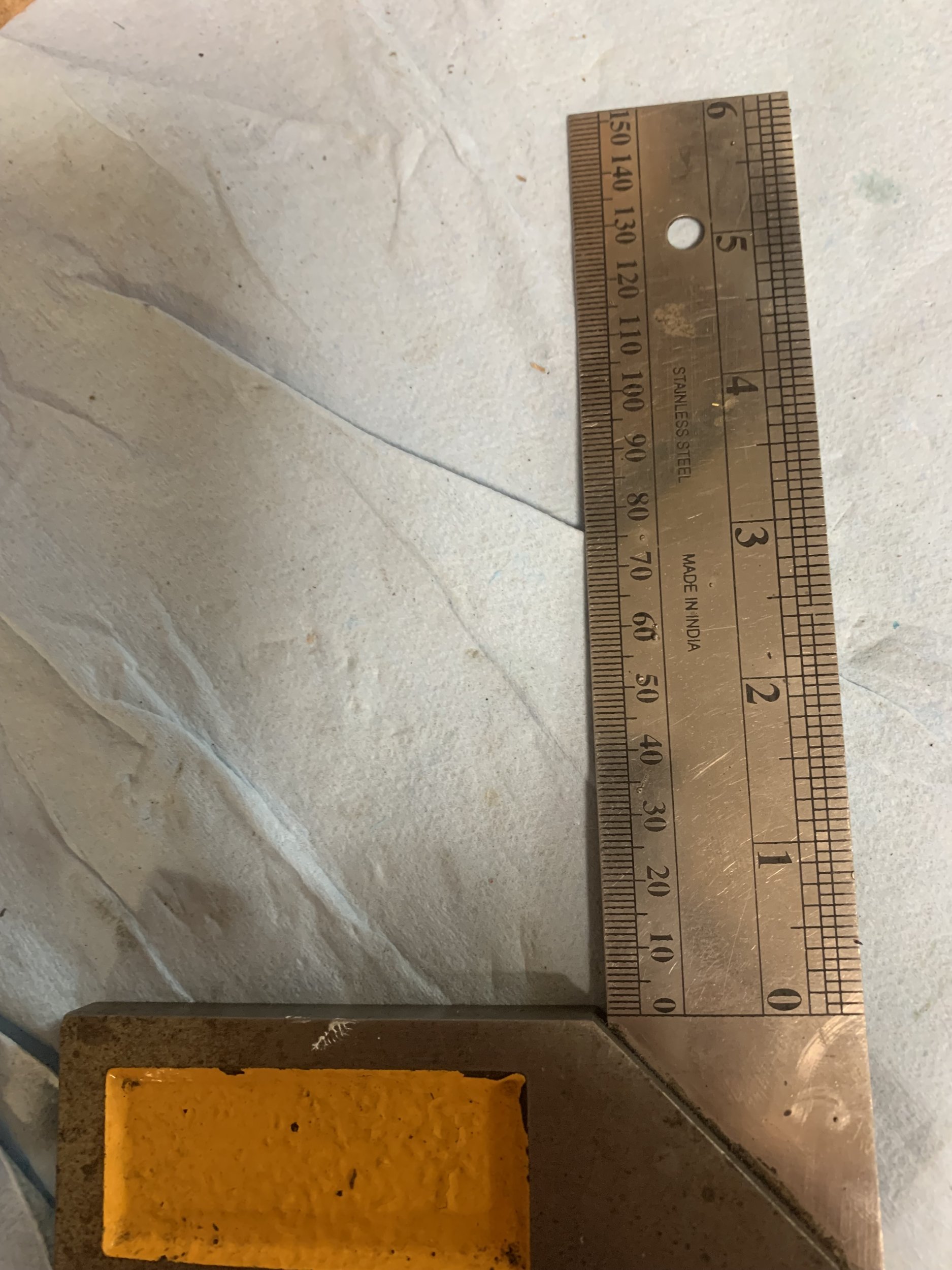

  24. Ziggster
    Posts: 3,059
    Ziggster
    Haha! I was going to use this imperial square, but yeh? Other side is the same. Freaking useless…

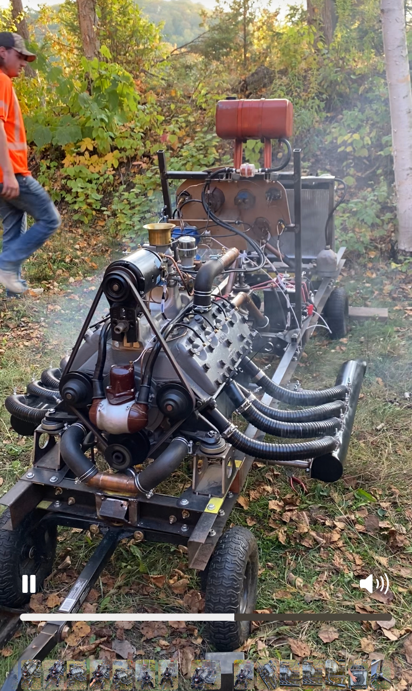

  27. Ziggster
    Posts: 3,059
    Ziggster

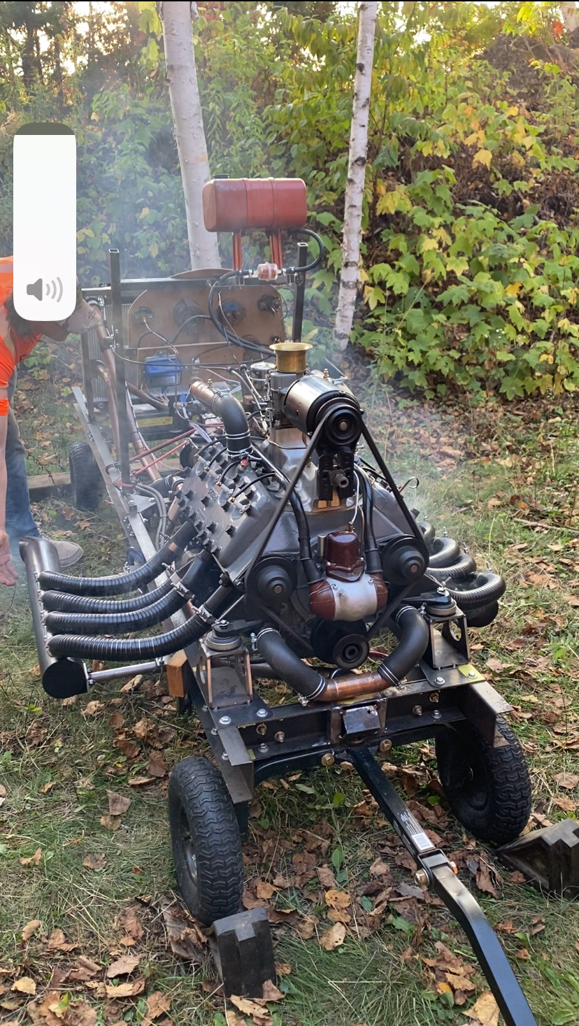

    Well after some hiccups, we finally got it started! Only was able to run it for 5 mins before it pegged the coolant gauge. Prior coolant was puking out of my overflow bottle for a while. Coolant gauge wasn’t registering for the longest time, and then it was pegged next time I looked at it. Rad felt cool, but both inlet and outlet coolant pipes were hot, so not sure what was going on. Rad fan came on at some point (set at 215F). I’m sure there was plenty of air in the system. I should have kept the rad cap off and watched the coolant level. Have vids but need to create a YT channel. Sounds awesome!

  29. Ziggster
    Posts: 3,059
    Ziggster
    Was smoking a lot in the beginning but think a lot was paint cooking. Near the end there was not much smoke out of the DS collector, but the PS collector was still smoking a bit. Not sure what all that means. Re-torqued the intake, manifold, and head bolts. All were a bit loose. Also tightened up the clamps on the flex tubes as they were loose once again.
    Stogy, leon bee and Squablow like this.
