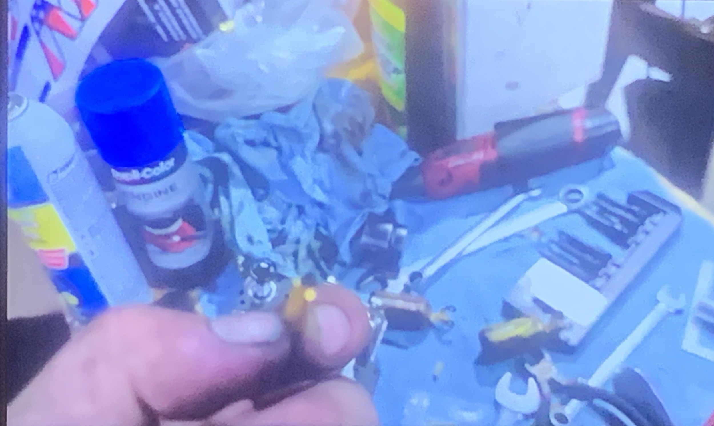

  17. A friend of mine stopped by last week, looking to borrow 1/4-28 bottom tap to clean threads on one of the holes in his Ford carburetor(8BA). Seems gasket was wet, and thought it wasn't tight enough, hole ******ed, etc. I then mentioned reading about this similar issue here on HAMB.
    Short story, he had same issue with power valve, wasn't tight enough. Gave it a pull, ***embled, put some gas in bowl overnight(on the bench), and gasket still dry in morning.
    Thanks for posting your issue and resolution.
