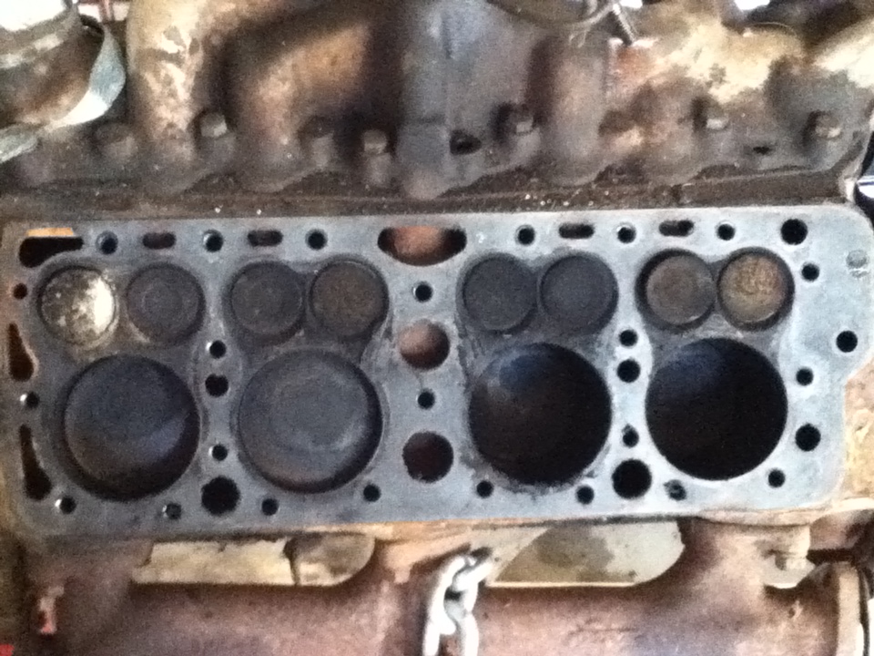

    These pics are of the pistons/valves after the left head was removed. Quite a bit of carbon build up, and the valve furthest on the left is caked with a hard white deposit. To my surprise, with the naked eye, I can not find any cracks! The larger water holes are a bit rough around the edges, but I have been told not to worry about that to much, just have them cleaned at the machine shop, any loose stuff knocked out. Close up pic of those.

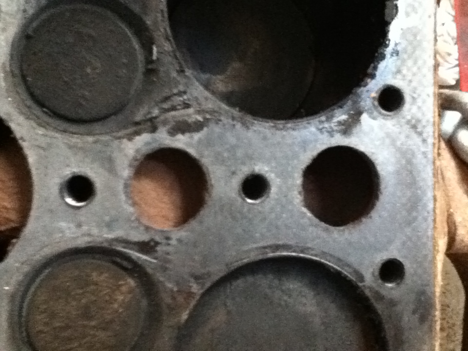

    Close up shot of the water ports in question

    Here is a shot with the other head off. Again, no cracks that I can see with my naked eye. This side seems to be a lot better off somehow. While on the other side, all pistons/valves are caked with blackness, this side you can still see bare metal on the top of the pistons, and most of the valves. What might cause this from side to side?

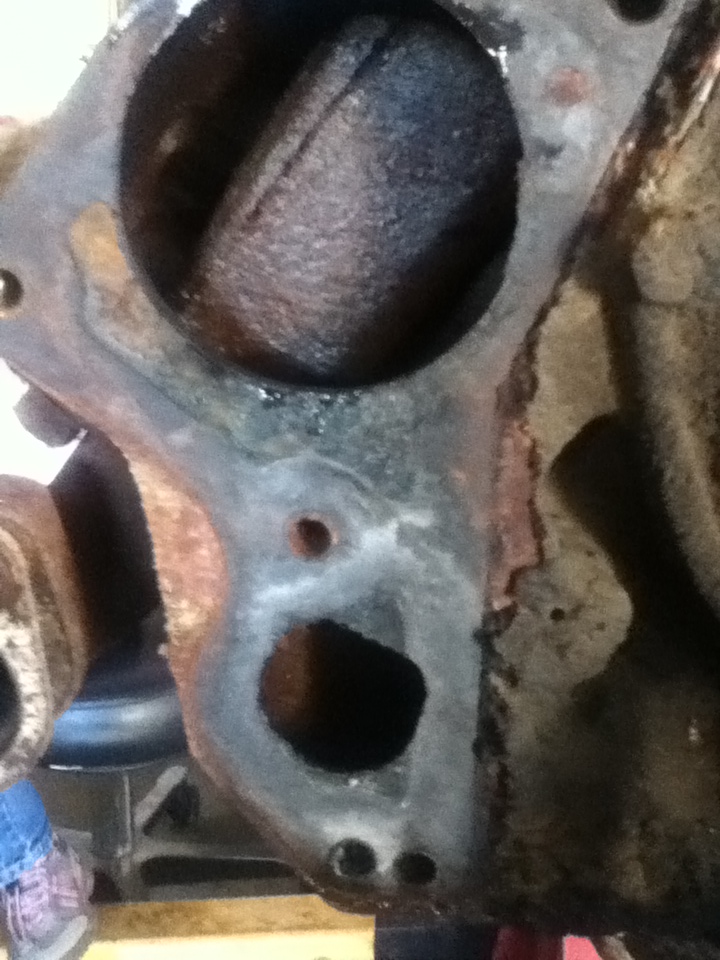

    After removing the water pumps (which seemed to still be in good shape, no play in the pullies, rolled smooth...I noticed that there is a large hole in the block on either side that makes no sense to me. It is where a gasket completely covers the thing rendering it useless...or is it? What would be the point if no water can flow through it? Was this set up for a different water pump set up? They were way out of wack, not circles any more. Here is a pic of the one on the left...should I be worried? The gaskets cover it no problem, just seems odd to me

    Looks to me like you have an internal coolant leak that caused "piston wash" and corrosion on that one cylinder.
    You said you saw no visible cracks, but a lot of cracks are under the valves in the seats and p***ages.
    Regarding valve removal, I'd compress the springs, remove the keepers, and pull the valves out. Then spray the guides with penetrating oil and hit them downward.

    Well, that made me want to vomit. Do you say that because of what looks like white corrosion on the far left piston?

    The caked on stuff could have also been a blown head gasket. or the reason for the left having all the carbon is because it doesnt have oil blowing past the pistons...the other side might, making it look like less carbon buildup when in reality its just getting blackened. hard to tell by the pics though. looks like a good build thread. ill be watching for sure.

    In reality I think that is just a really bad picture. That piston on the far left is actually the cleanest one of the bunch. What looks like white corrosion, is actually bare metal. Hope this changes things!

    Or is that "piston wash" actually make the piston cleaner?

    if that's the case then it looks like you were getting a little bit of a premature ignition on that cylinder. the whole cylinder not being black could be why it might not have ran that well.

    No vomiting please. Welcome to the world of the flathead Ford, where some say 85% of the blocks out there are cracked. The white corrosion is from water, now you need to find the source. An engine stored for a long time can ac***ulate condensation or even rainwater in the cylinders. A blown headgasket, warped heads, or cracked block will allow coolant to leak into the combustion chambers. A piston that is "wiped clean" of carbon indicates to me that coolant leaked into the cylinders while it was running. You would also see rust and corrosion on the valves, the heads, and perhaps the cylinder walls.
    You need to break it down and send it out to be tanked and magnafluxed, and/or get a pressure testing kit and reinstall the heads and pressure test it.
    Many cracks can be repaired, so don't panic yet. If you're worried about expense, you're looking at the wrong engine for a cheap rebuild.

    Pre ignition: the fuel/air mixture lighting off in the cylinder before the spark plug fires. Often due to glowing carbon on top of a piston or on the head. Or a bit of a lean condition in that cylinder.

    On the large holes in the casting at the front of the block. I'd have to think that those were because of the way the casting mold was setup when the foundry poured the blocks. Plus it would give the foundry a bit of a better p***age to get the sand out of the waterjackets when they cleaned it out.

    Well there ya go. That makes sense about the water p***ages!

    It might be a sign of water getting in from somewhere but there is light coloring on the bottom half of each piston on that bank with
    the rear one being the most noticeable.
    There isn't any sign of the carbon being washed off the valves or the area around the valves though. I'm still thinking detonation
    What does the head look like?.
