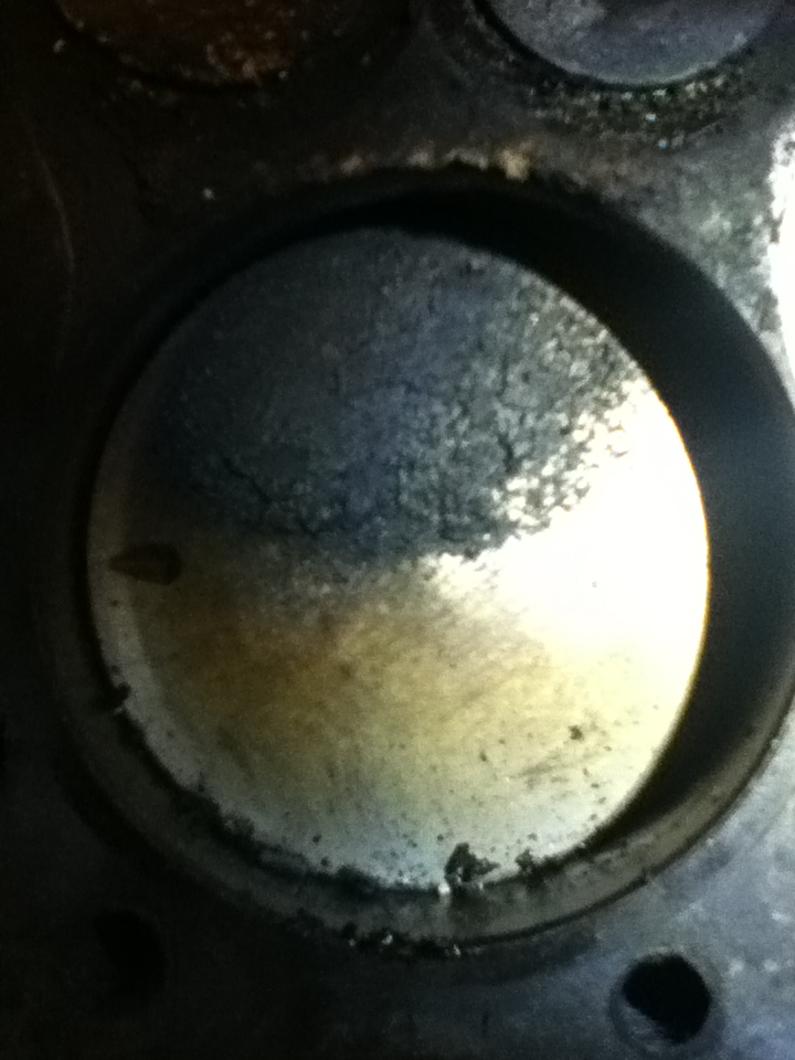

    Took a better pic of the piston in question on my way out the door this morning. This pic shows a lot better, that it is not a white caked on mess, more bare metal. Now this may be the dumbest question I have asked yet, but if there was water leaking onto the piston...wouldnt that water then find its way eventually into the oil pan...causing that lovely creamy white oil you get to see with a blown head gasket?

    Anything at this point is speculation and you need to do diagnostics anyway on this or any rebuild.
    You bring up a good point about the creamy oil, but if it were just a bit of water, then it might survive combustion as water vapor and be exhausted. Also, remember that some water will always ac***ulate as condensation in the crankcase and also be cast-off as water vapor thru the crankcase ventilation system.
    I've heard of guys de-carbonizing combustion chambers by spraying a water mist into the carb while the engine runs. As long as you don't hydro-lock it, you can do this fairly safely. Sure, some will p*** through the rings, but unless it has enough volume to emulsify, that will evaporate, too.
    The creamy oil thing is usually the result of a lot of water. Anyway, something sure shined up that piston, be it gas, oil, or water!

    Just had a chance to look at the head from the side with the "clean" piston. There is some build up that is a brown color. Caked on the spark plug as well. I also got to removing the valves...well 4 of them, It actually went really easy. I figure if I am going all out I may as well get new valves so I was not worried about using a rubber mallet on the operation. I could not take pictures of the process as it requires all 3 hands. I will post a link to a video I found on line that helped me out a lot. My questions for tonight are: besides the sealing surfaces on the block, how rough can a guy get on the inside? Is there a trick to getting the lifters out or do they come out later on when you flip the motor over? Is it silly to reuse the valve guides but replace the valves and springs? How imparitive is it to have adjustable lifters on a fairly mild street motor?

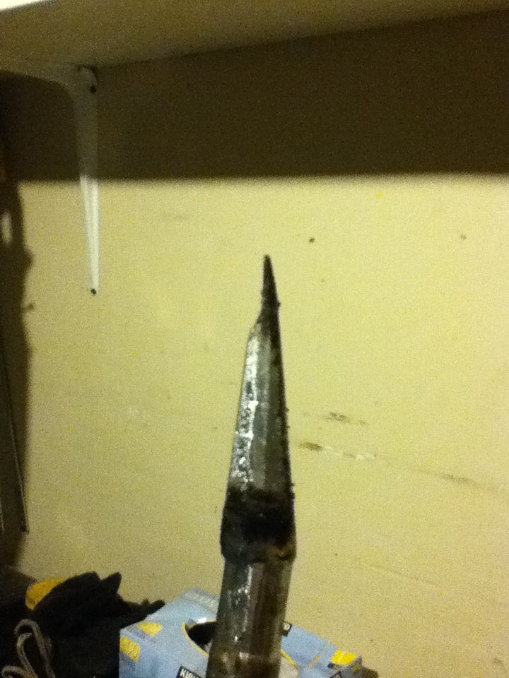

    As I was removing the intake set up last week, there was a rod that went into the fuel pump. I have looked up pictures of said rod on the internet and found that there is another piece shaped like a bell that goes around it. I have about 1/2 inch of dirty thick oil sitting in the top end have not seen it floating around anywhere. Is this something that should just pop off with the rod, or is it pressed in somehow?

    Grab the pushrod & pull it out. If you havent yet, in the valley are splash guards or whatever spring clip to the center oil tube. Grab em and pull them off. Further along when you have the cam gear off there will be a plug behind the gear that go's into the oil tube. On the other end behind the flywheel when you get the oil pump drive cover off there will be another plug, that comes out so a gun cleaner could be used to cean the tube. There are cleanout plugs in some crankshafts, itgo's on & on... Do it right and it will go 50 more years.

    Valve guides.... be sure to remove the "horse shoe" clips that keep them in place. New guides are readily available, (Speedway) and be sure to use new "O-Ring" seals on the intakes. Bare metal piston top...usually means coolant getting into the chamber, and the piston top being "steam" cleaned.
