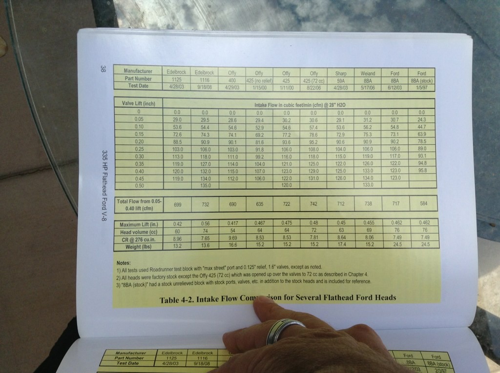

    I'm absolutely not an expert, I only know what I've read so please take what I offer as a regurgitated info. Joe Abbin's "Flathead Ford V8" book gives the following charts. This is Joe's personal data he gathered using his flow bench.

    I never said it doesnt work.
    I said there are more effective ways to gain flow
    And for a street motor (like in this thread) its a waste of time
    Joes dyno numbers without a blower are hard to believe....
    So what about his flow tests then?
