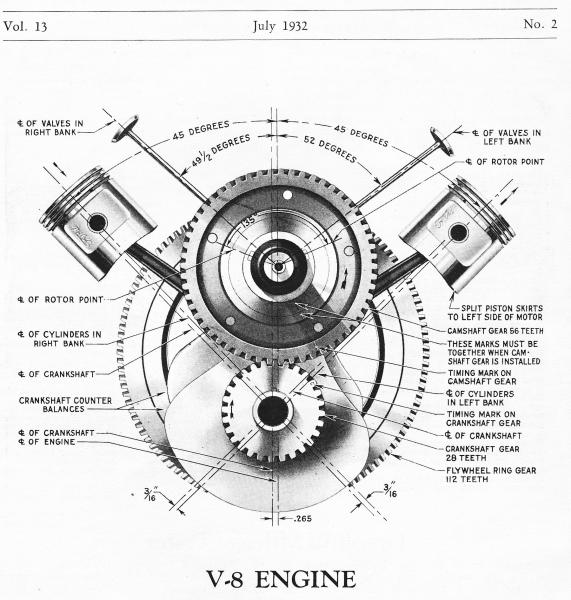

  1. The dimensions on the drawing do not work - if you plug in all the offsets, centerlines and angles - you cannot possibly have the dimension value of ".168" - so I don't trust anything about the drawing at this point (other than the valve angles, which I've measured).

    Joe Abbin in his Ford and Merc Rebuild book has this same diagram and while it's not relevant to the ***ymmetry issue, he also points out that the engine has the Ricardo "Turbulent Head"

    Part of the problem is figuring out what to measure, essentially defining center...
    Crank location is revealed via relation of bore center, then I guess cam location should be measurable from crank...
    The picture posted in the "asymmetrical" thread is of course from the service bulletins, and I think it kicked off Jim's quest for more detail. Those bulletin pictures exist for multiple ages of flathead, including 99 and 59 types, and I think there is a somewhat different '49 drawing too. Following and comprehending the many lines is a chore...
    Crank offset at least is thoroughly do***ented in drawings and in engineering theory in the English Ford engineering book...I hooked up Jim with that one, and that's all thoroughly worked out...pictures there are generic geometrical studies on piston movement, not specifically flathead. All of that of course overlaps heavily with modern practices on offsets obtained in various ways.
    I think Ford started offsetting with the Model A.
    Cam offset would seem to me to be only meaningful in terms of relation to valve ( a thought kicked up by the Model A, which has no engine center to discuss) and I am ***uming here that cam followed crank over to the offset position for neatness's sake and that valve angles are just Ford's way of aligning axes. Ford changed angles slightly with the 59
    (only published explanation I have ever found said it allowed better water p***age around valves) but kept them pointed at cam center, so that's not an issue here. Note that Ford used the same cam from '42-8 in both types of engine.
    My head hurts when I start figuring out which line does what.
  4. The real question is where is the centerline and how much is the crank and cam offset . . . and in precisely what direction? Based on the drawing, the bores are shown as symmetrical in that the center-lines are shown as 45 degrees from the block center-line. What doesn't jive is that their true deck height from an imaginary center would have to be different in order for the deck height from crankshaft center (if it is offset) to be the same.
    I've got to do some additional CAD work to "test" a few scenarios - to see if I can end up with approximately what I believe we're seeing.
  5. The drawing shows the overall bore centerline is offset by .265 (which is the same as the crank centerline) and you're right, the cam is only .024 off of that. I'm going to redo my CAD drawings with the bank centerlines coming off the crank centerline, plug in all the dimensions and see if it works! Good catch by you!
    More work by me to get this right . . . be back to you all!

    I think you are saying what I extract after staring at the pic...centerline for a non-offset would be intersection of bore angles measured through centers of bores...the .265 line.

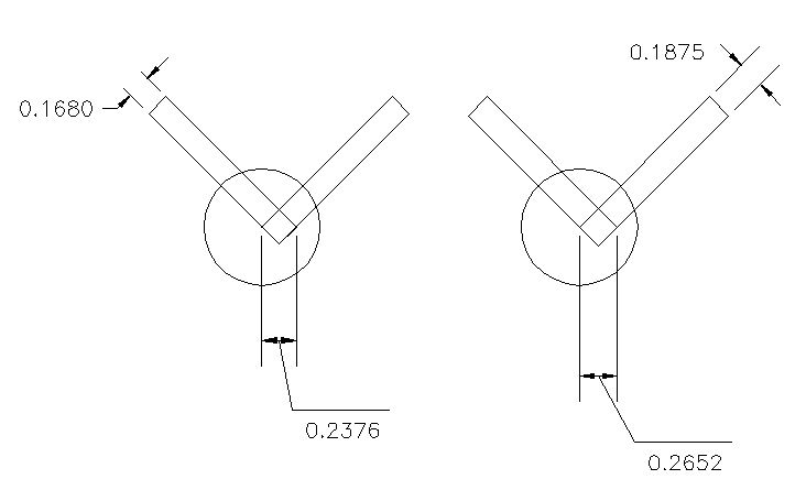

    Correct! A .168" offset at 45
    The bore centrelines are only offset .265 from vertical.
    The true offset should be measured at 45° from vertical.
    .168" at 45° gives a vertical offset measurement of .237
    The .237 offset plus the cam offset is close to .261 [ if they got their math the wrong way round]
    so the math is wrong [unless it is measuring something we don't see on the drawing]

    There is also this drawing from 1932:
  11. alchemy
    Joined: Sep 27, 2002
    Posts: 22,760
    alchemy
    Odd that the CL of the cam is called the "Centerline of the Engine" in BillM's drawing above. I'd bet that everything in the ch***is is measured off the middle of the crank, and the crank is actually in the middle of the ch***is.

    On Ford drawing shown, line goes right up through center of visible stuff like fuel pump. With scale and lines only .02 apart I think it's pretty hard to tell whether crank or cam center is meant as center! Crank is in middle of car, anyway.
    If you want to discuss offsets you need another center, and if you take that to be where things would be with no offsets I think best reference is the meeting point of the centerlines of L and R cylinders.

    Even at the low resolution of the 32 engine drawing it shows that the centerline of the engine does not line up with the cam, it is off to the left looking at the drawing (or to the right in car terms).
  14. Yep - the two drawings are very different. In the 1939 one, the dimensions for degrees and angles are off of the camshaft centerline, on the 1932 one above, they are off the center of the engine. I have no clue as to which is right, but I will rework my parametric drawing to see if I can figure it out - it is highly unlikely that both are correct for their respective years . . . heck, they both might be wrong!

    Crank_Cyl offset.JPG I made a quick drawing to check the crank to cylinder offset; the 1932 drawing looks right but the other one doesn't.

  23. Using the simple Pythagorean theorem, the 1932 one is correct on the offsets - the 1939 one cannot be. I haven't got back to my CAD model, been too dang busy with XMas stuff - will have to wait for the New Year I think
