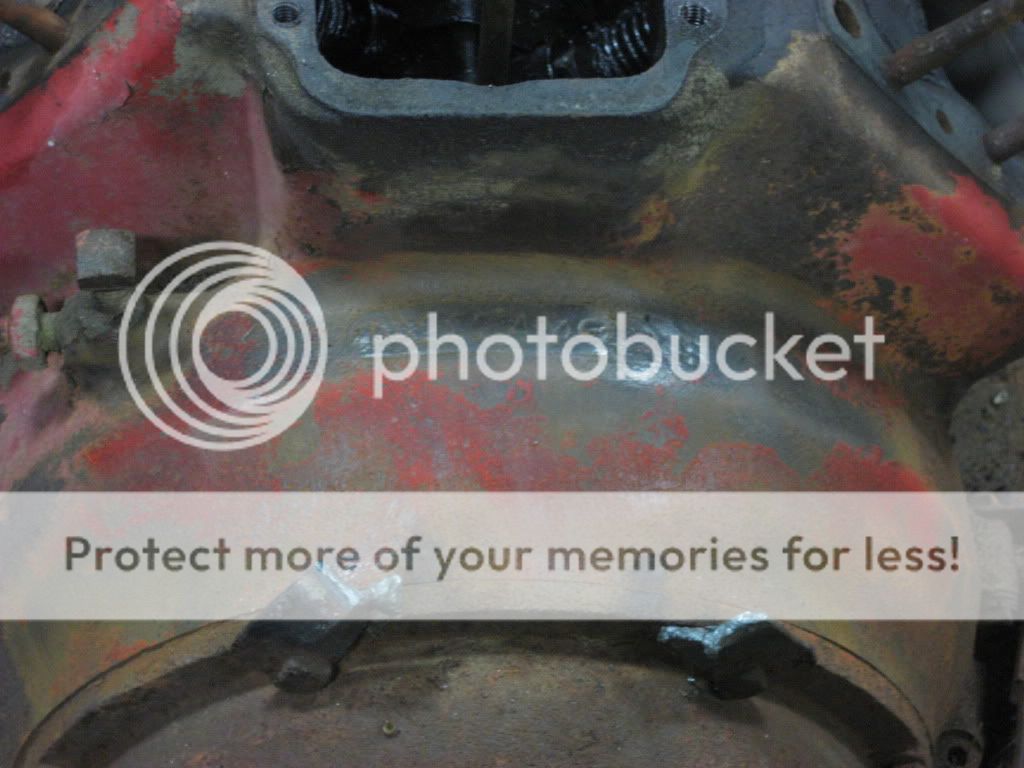

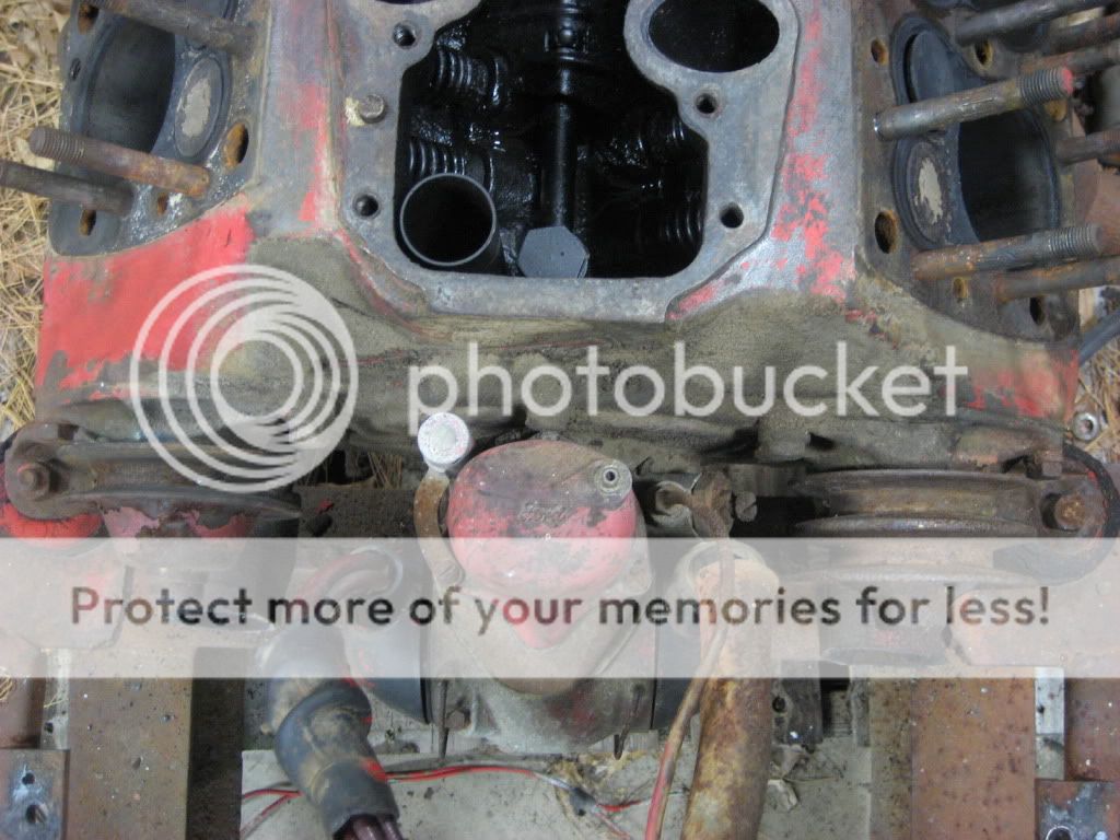

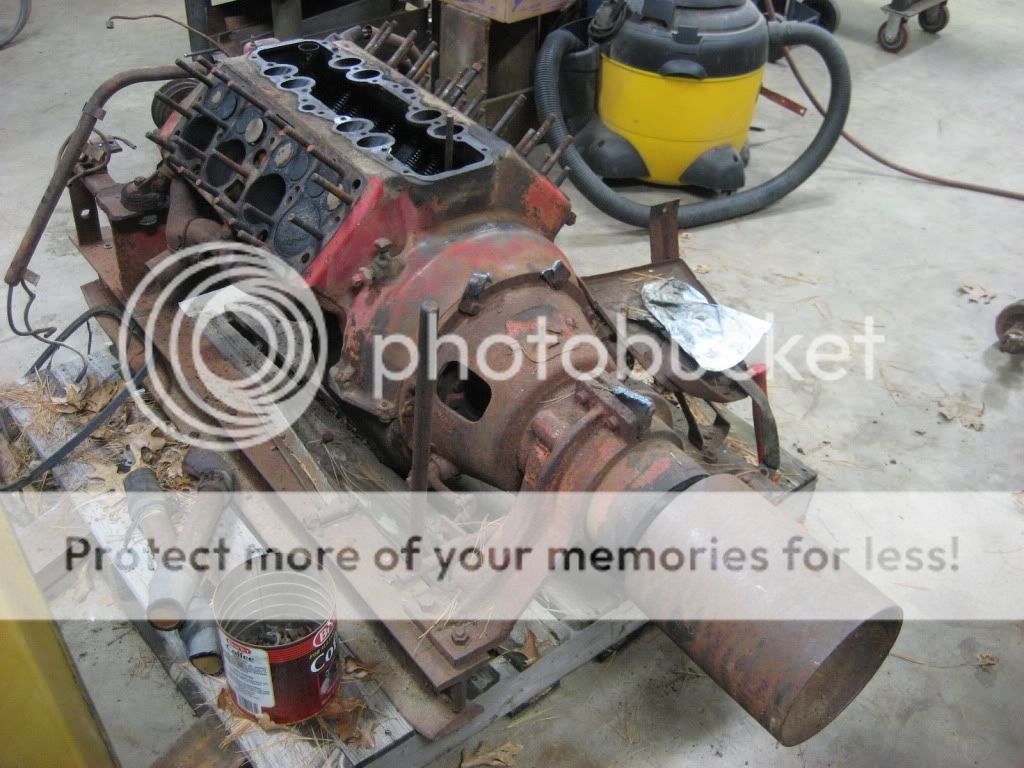

  1. I was given this power unit and it has been just waiting to be used. I need an engine to put in my 29 Model a project and this fits the bill. I took it apart to see what it looked like and I was pleasantly surprised.
    It appears to be a 1941 Mercury block according to vanpelts website. It has the raised deck and has round center water jacket holes. There is no numbers cast into the bellhousing other than x8. The block is factory relieved and has a bore of 3.188. There is a slight ridge. The pistons are domed and steel. There are valve seats installed. The water pump on the left has a double pulley. The generator has a 36 style cut out and has a 6 blade fan. The carb is a 94 91-99.
    Is it possible that I have a standard bore 41 Mercury engine? Why is it relieved and have hardened seats?

    Hardened seats were standard for most flathead years. Looks like a typical '41-2, used in trucks and Mercs, also built through the war. Manifold is maybe '37-8, carb would match age of engine, oil filler cap is '32-4!
    If engine was originally in that machine rig, Ford industrial engines were truck versions with no real differences from Merc.
    When Ford started reliving some engines (certainly by wartime period), why, and which engines got the relief are all entirely unclear.
    Your left pump is truck, right p***enger...
    Some wartime engines (not this one) had a cast boss for third oil port, used for full flow coolers and filters on various military applications.
    I have one like yours, except with that boss, undrilled like most.
    The boss stayed there from WWII onward...

    Wouldn't the steel pistons indicate an industrial engine? It is quite possible the second belt shive on the "driver's" side water pump could have very possibly been to drive a governor.

    Looks to me like it was run on propane/butane -- if that's aregulator in first pix it would be part of such a rig. If so the valve seats being hardened would be part of the "industrial" setup since there was no lead in butane.
    Good news is that if it was a butane engine the bores & bearings should be in good shape -- steady rpm's and clean fuel means this things can run foever.
