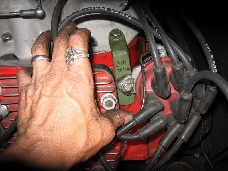

    Last year I was workin on a guys '35 ford.
    It had a 59 engine in it,
    so of course bought some offy heads, longstud kit, mallory crab, just spent his money.
    Of course the original studs weren't gonna come out, and the first one snapped...
    It was a rush job so I decided to swap engines from my RPU, an 8ba style. (used bolts)
    this engine turned into this engine
    after plugging obvious water holes (tapped and filled with bolt),
    and using the thinner ford bellhousing,
    Just had to come up with this.(the green thing)
    The only bummer was buying the newer style mallory distributor cause they wouldn't return it.
    Since it was in a '35 and I get to tune it up, I like the 8ba distributor way better.
    I've put the 59 in my '40, and it is alot easier to get at since the hood opens up.
    Regardless to check points it is easier to take it out.

  14. banjorear
    Joined: Jul 30, 2004
    Posts: 4,600
    banjorear
    Zibo:
    Great advise and I like your dizzy hold down.
    Another thought is that you need to use 8BA water pumps in order to clear the side mount dizzy.

  16. SinisterCustom
    Joined: Feb 18, 2004
    Posts: 8,277
    SinisterCustom
    Well....that cover is $150....and what Zibo did was make his own part, probably was faster than ordering the part and much cheaper.....part of the fun of hot roddin' is makin' your own parts and not buying everything new........I dig it....

  17. zibo
    Joined: Mar 17, 2002
    Posts: 2,361
    zibo
    from dago ca
    thanks guys!
    the other thing is that speedway deal uses an allen wrench with your hand
    way over there by the belt/pulley.
    Just not as convenient as the original method.
    If you make the green bracket style,
    make sure you add some steel to keep the bracket from compressing toward the block. (underneath)
    (basically measure the heighth of the mount on an original 8ba head and match it.)
    travis aka zibo
