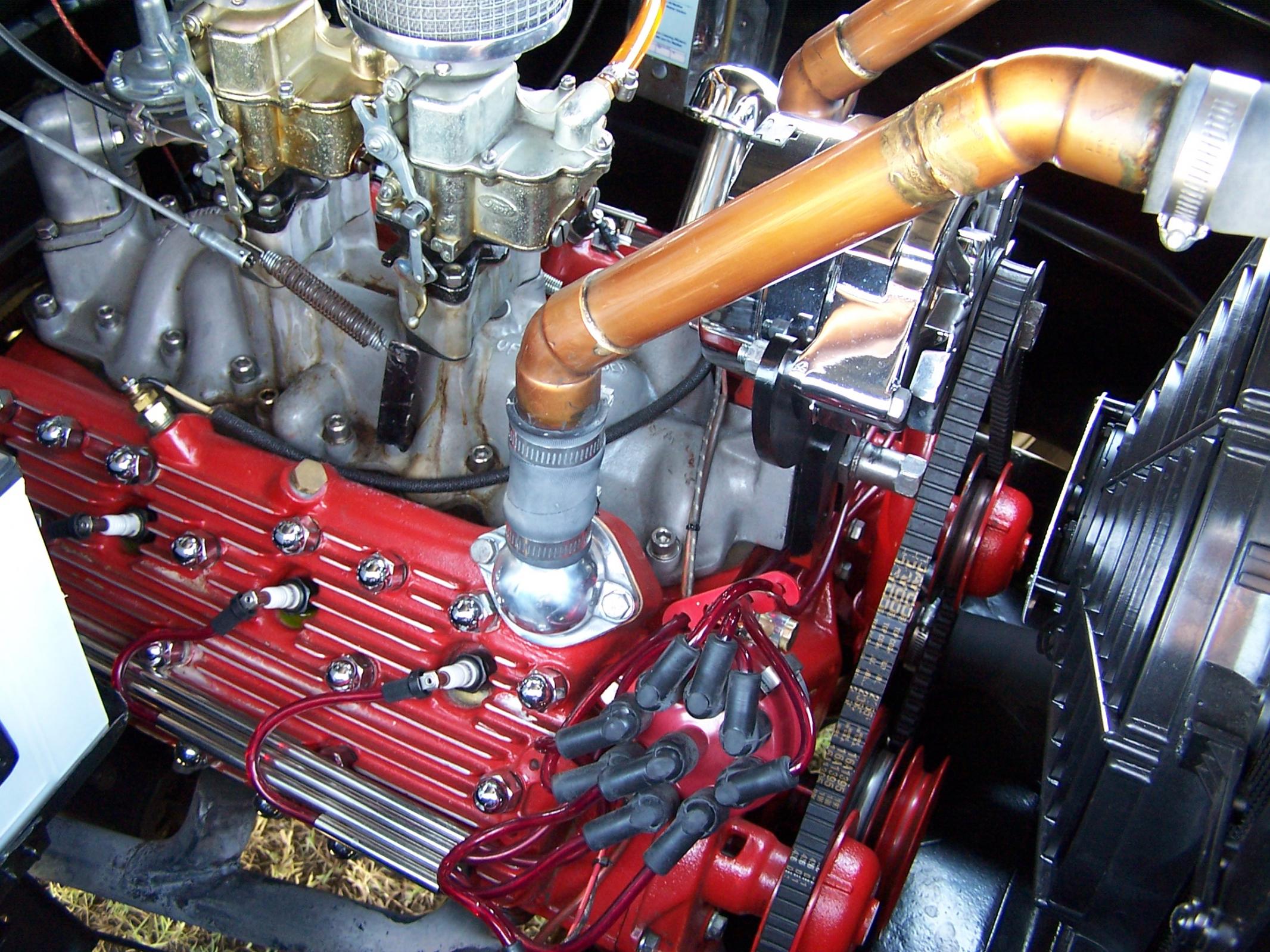

    8flat...Your on the ball man! Glad I could help out.
    My '50 8BA in my F1 is all the way Ford engine red. VHT and Krylon, Hirsch as well. There all dead on with the correct color. There was a little change in some regards to the commercial vs truck applications. The truck meant HD applications and the commercial meant PU's. Not sure why just that away. Infact some of the truck application got painted the commercial colors and visa versa. This has been a point of discussion in the V8 Club for a while.
