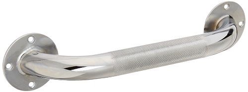

  11. manyolcars
    Joined: Mar 30, 2001
    Posts: 9,608
    manyolcars
    I made these out of stainless grab bars. You know, for bathtubs ssradhose.jpg ssgrabbars.jpg
