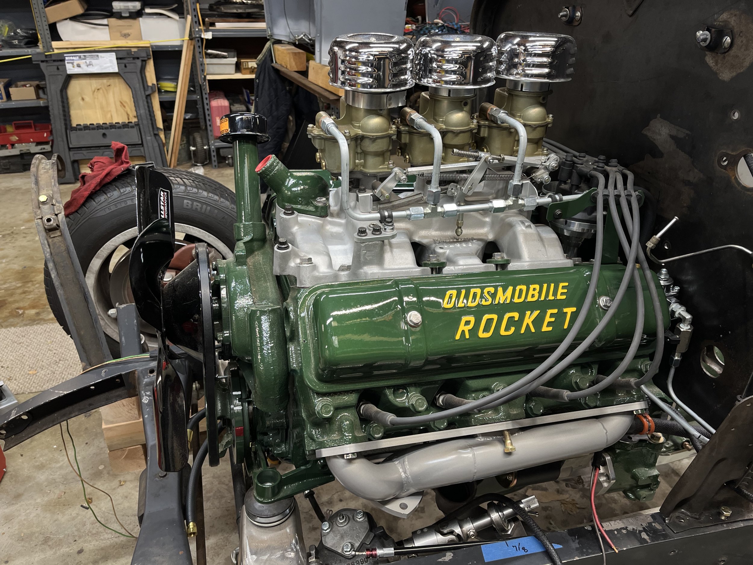

    I used jic fittings. I got them at my local hydraulic hose shop. Very cost effective IMG_5610.jpeg IMG_5608.jpeg
    jet996, The 39 guy, Ziggster and 7 others like this.

    That is a very professional and clean looking gas supply line to your carbs.

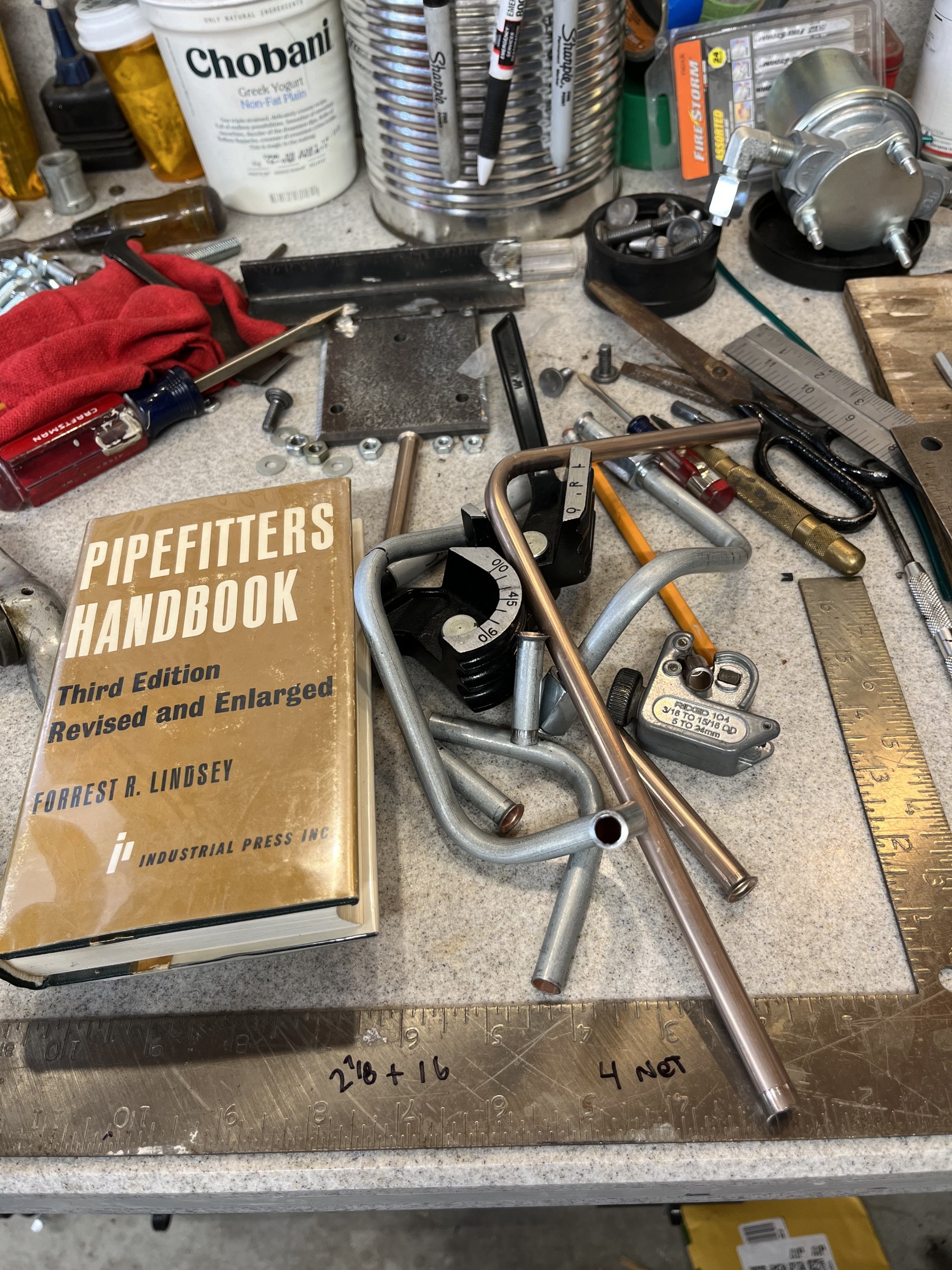

    To bad that I never knew about that book until just now. It could have saved me countless feet of wasted tubing and enormous frustration! Not to mention the expense of the tubing! But, I am proud of what I learned and what I was able to accomplish!

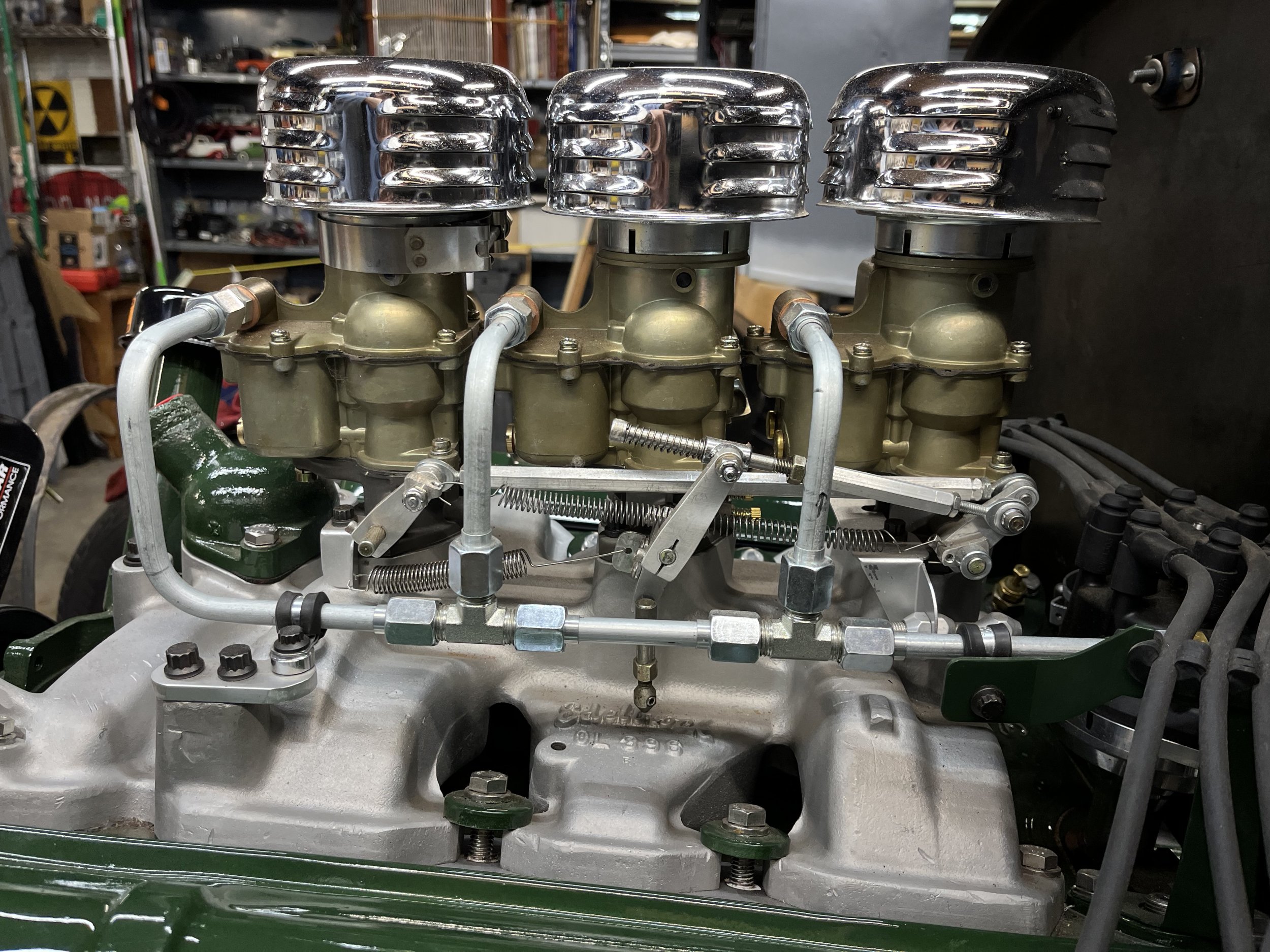

    I did flex line from carb to regulator, used tube lock crimped fittings IMG_7289.jpeg IMG_5609.jpeg
