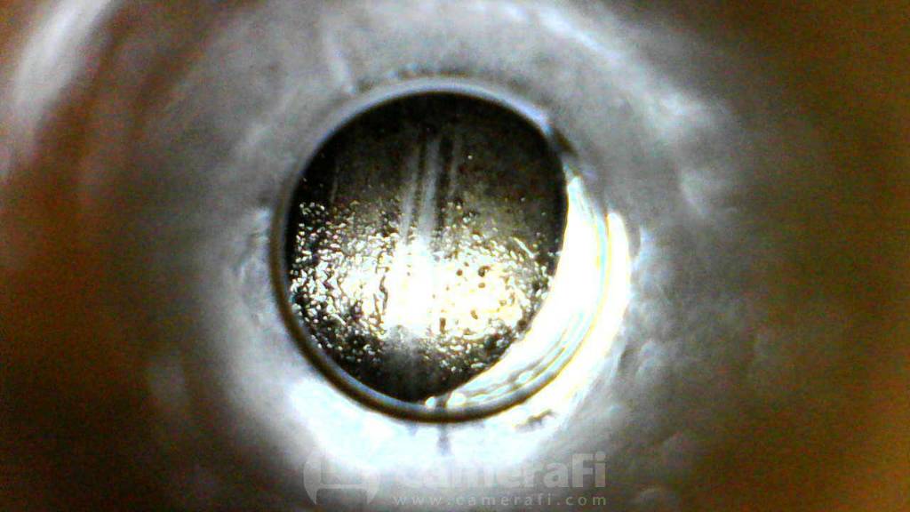

    trying to load a video.. says its too large ?

    I had this problem. After removing enough bits too look down the hole, I could see the edge of the hole in the bearing overlapping the push rod hole by about 1/16". The bearing needed to rotate slightly to align
    I found a long bolt that matched the push rod diameter (3/8"), cut the thread off, and ground a flat on the shank.
    I carefully sized it to just drop through the bearing hole.
    Then with a socket on the end of the bolt I carefully turned it, forcing the bearing to rotate into alignment.
    It was a gamble that worked for me.
    Looking down the hole afterwards I could not see any sign of metal shavings or swarf. It appeared bearing turned neatly in its housing. Certainly much quicker than pulling the engine and dismantling everything.

    i guess we both got lucky !

    When I had my flathead rebuilt the rear cam bearing was pushed a small bit toward the rear and the pushrod did not contact the cam. I had to take it back to the engine shop to have fixed 191005_165944.jpeg

    yup thats just what mine looked like .. i had a little less bearing showing

    if it did come to turning it down in a lathe .i was just removing material from the bottom inch or so of the rod ...i think it would have been ok ?

    fixed the fuel pump problem sunday ... took me 3 days to figure out how to post a video
