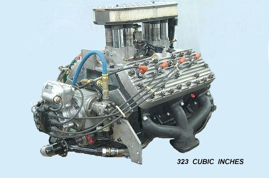

  18. HotRodJosh
    Joined: Jan 10, 2002
    Posts: 321
    HotRodJosh
    Here is what you want.
    I run on on my car with no problems. Except for the modifications to make it fit.
