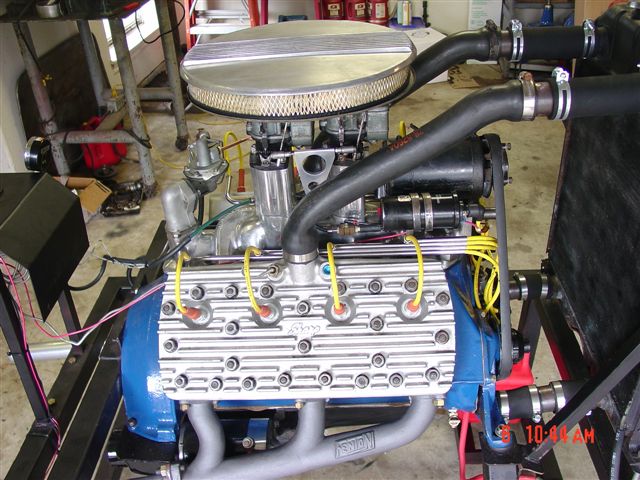

  8. Shaun1162
    Joined: Feb 22, 2010
    Posts: 973
    Shaun1162
    It used to be done quite a bit back in the day.... There was a number of race tracks that put "No finned heads" in the rule book, so racers would plane the fins off to get around the rule. I have a set of heads sitting on my shelf that had the fins planed off- can't comment much on effect to cooling though.
