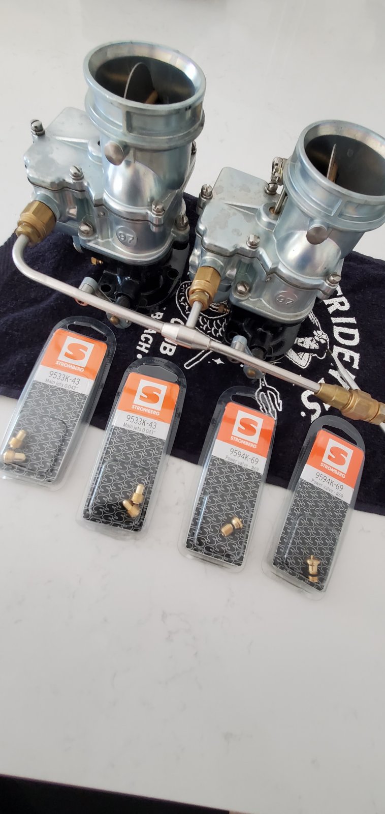

    I first changed the jets to .43 and power valves to #69s and thought I possibly damaged accelerator pumps when installing power valves so I replaced those just to be safe.

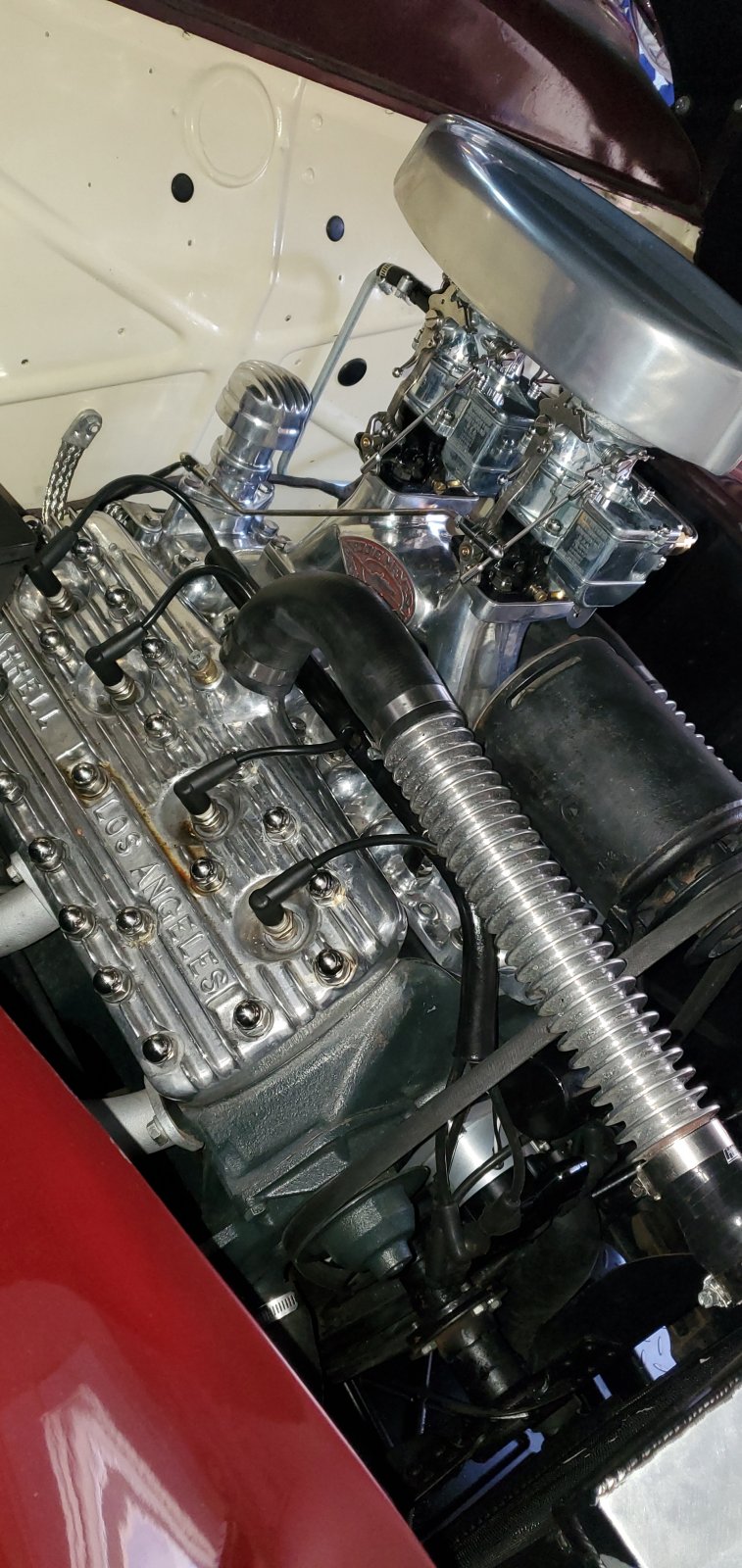

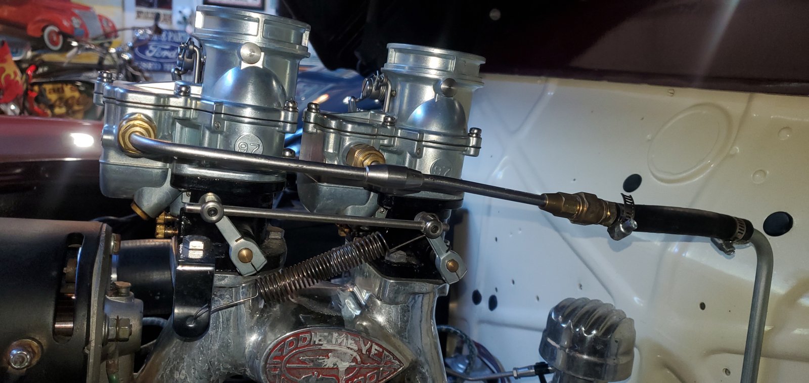

    So I have checked for vacuum leaks with propane and had none. Float levels seemed right after removing the top of the carbs and then turning on electric fuel pump to let them fill up. Grounds are good but that was an issue before not allowing car to start but they all got switched out and that fixed that issue. Issue happens with airecleaners off or on so restrictive is not an issue. I did use a carb synchronizer and that's not the issue. I also adjusted the fuel mixture using propane and adjusted them until the propane stopped the rpm from changing. Spark plug gaps are all good and new. I bought the strombergs from cw moss brand new. I bought the stromberg straight linkage. The throttle linkage is weird Z shape because it's a high-rise manifold but a shop made that and not sure if that's an issue?
    Here are some pics 20220916_164414.jpg 20220830_172904.jpg 20220829_172709.jpg 20220829_172713.jpg 20220826_085518.jpg 20220825_230133.jpg
