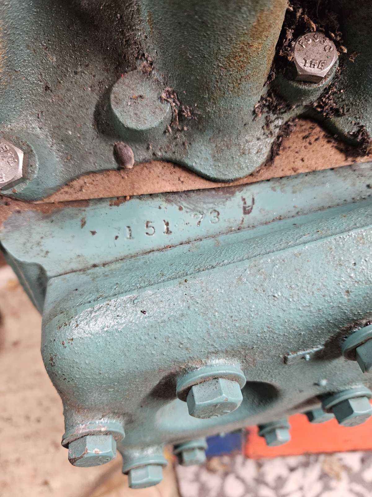

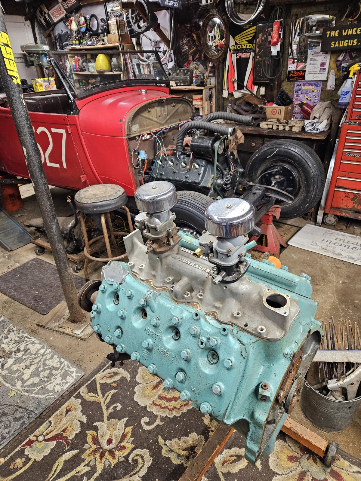

    I made a deal on an unseen flathead. My pal said he pulled it out of a 1950 big truck then had it rebuilt by a local, reputable machine shop. Yesterday we got it out of it's hiding spot. It definitely was rebuilt, new adjustable lifters and minty clean in valley. Maybe I got lucky. 20240226_183420.jpg 20240226_183431.jpg 20240226_183441.jpg 20240226_183454.jpg 20240226_183512.jpg 20240226_195100.jpg
    I took a few pictures, any help would be appreciated.

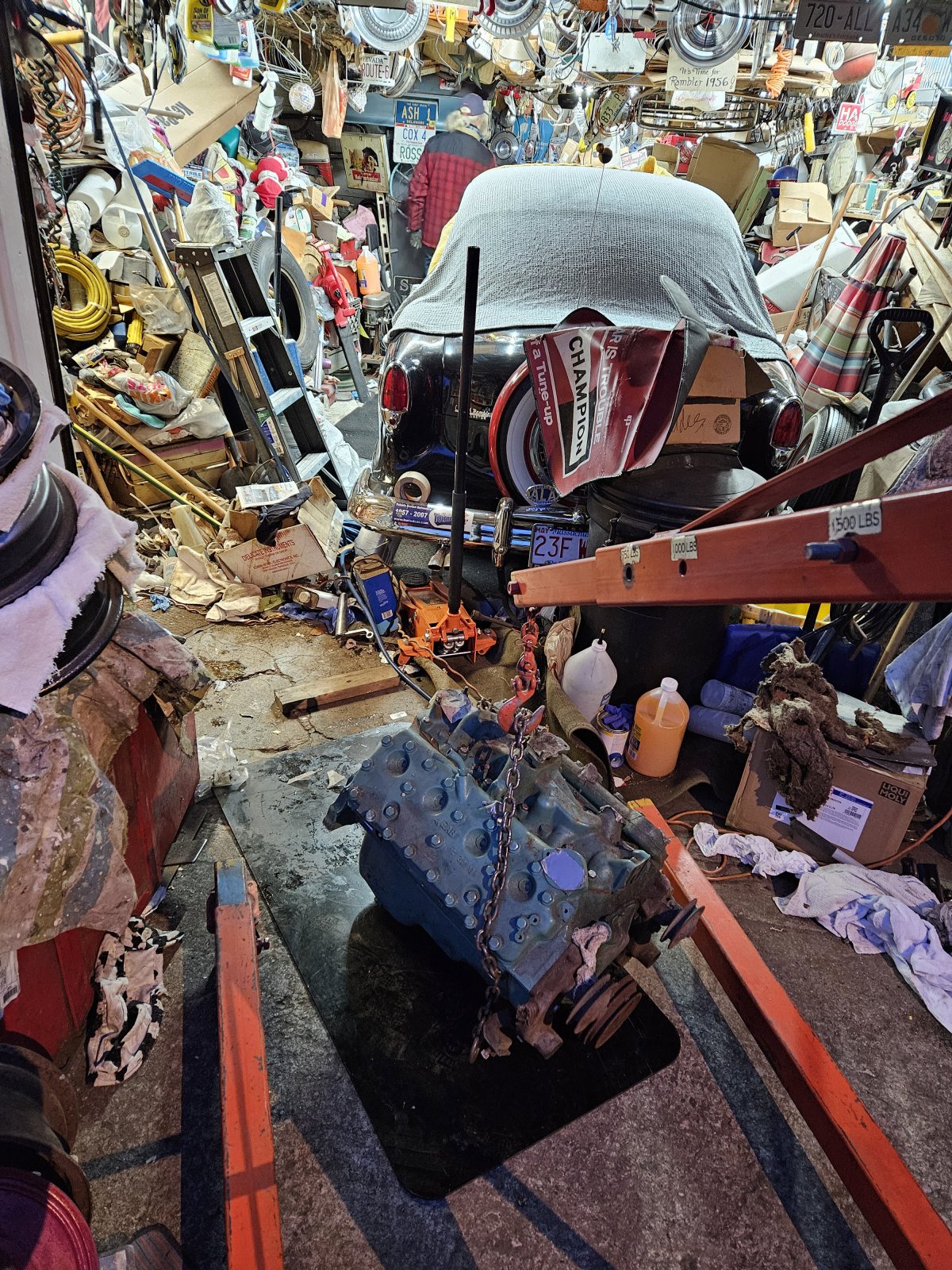

    Simply is a 8BA that everyone has..... you can tell by the timing cover ..... probably better off to trade it foe something earlier.

  5. Someone needs to help the man clean / re-arrange. On the left i see the wheels/rims stacked with rags between so his intentions must be good but the other stuff is overwhelming.

    Wheeldog, Great find. Thankfully the seller remembered it was there. One quick point: one head marked EAB from a car and the other 8RT from a truck. IIRC, they may have different compression ratios but this can be researched pretty quickly to see if it’s consequential.
    Appears to be painted Mercury color. Realize it’s just paint but Wonder if there could be a 4” crank hiding in there.

    that is a full-on hoarder.
    Nice score, the engine should make some old hot rod happy again

    Ron your engine has one high compression head and one low compression head. Late flathead heads from low compression to high are:
    8cm, 8rt, 8ba, EAC,EAB. so basically you have an 8ba for the sake of discussion. It would be nice to pop a set of matched EAB heads on there.
    It would be helpful to see inside anyway. See what size pistons and check the stroke for a 4” crank. Even if it’s 3 and 3/4 you’ll have fun with it. Good luck

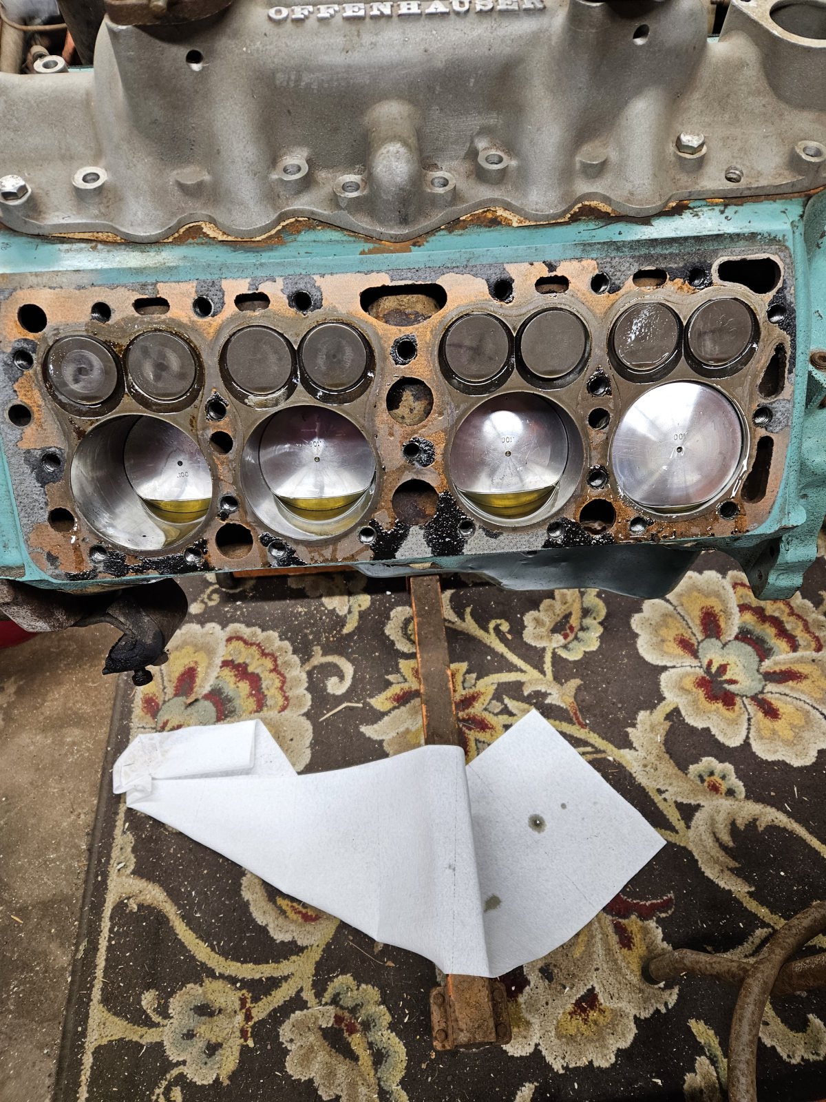

    I pulled the heads. .100 over pistons and 3.75 stroke. Minty minty clean and no cracks, I'm happy. Do these measurements make 255ci? 20240227_184459.jpg 20240227_184425.jpg 20240227_200059.jpg

    looks better with all that aluminum on top!

    The 255 Merc has a 4" stroke but looks like you bought a nice motor! To run the early heads you have on it you have to plug two water p***ages in the block and one on the head. The two holes in the water jackets are at the front of the engine, you can see them in the pictures, 1/8' br*** plugs just have to run a tap in and put a little sealer on them.

    My math tells me you’re now at 255 having picked up the additional 16 CI with the larger bore. Mercury CI with a Ford crank.

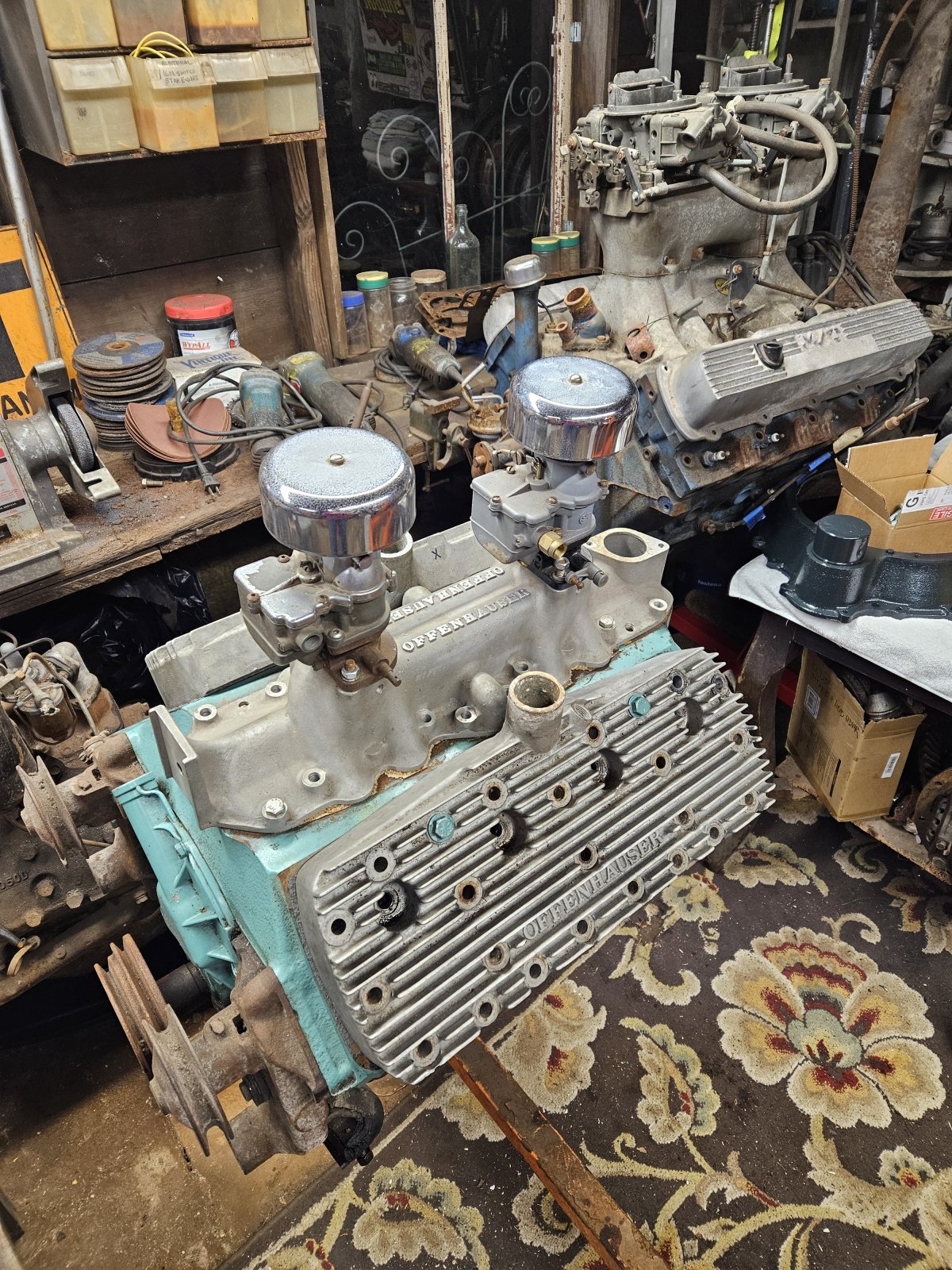

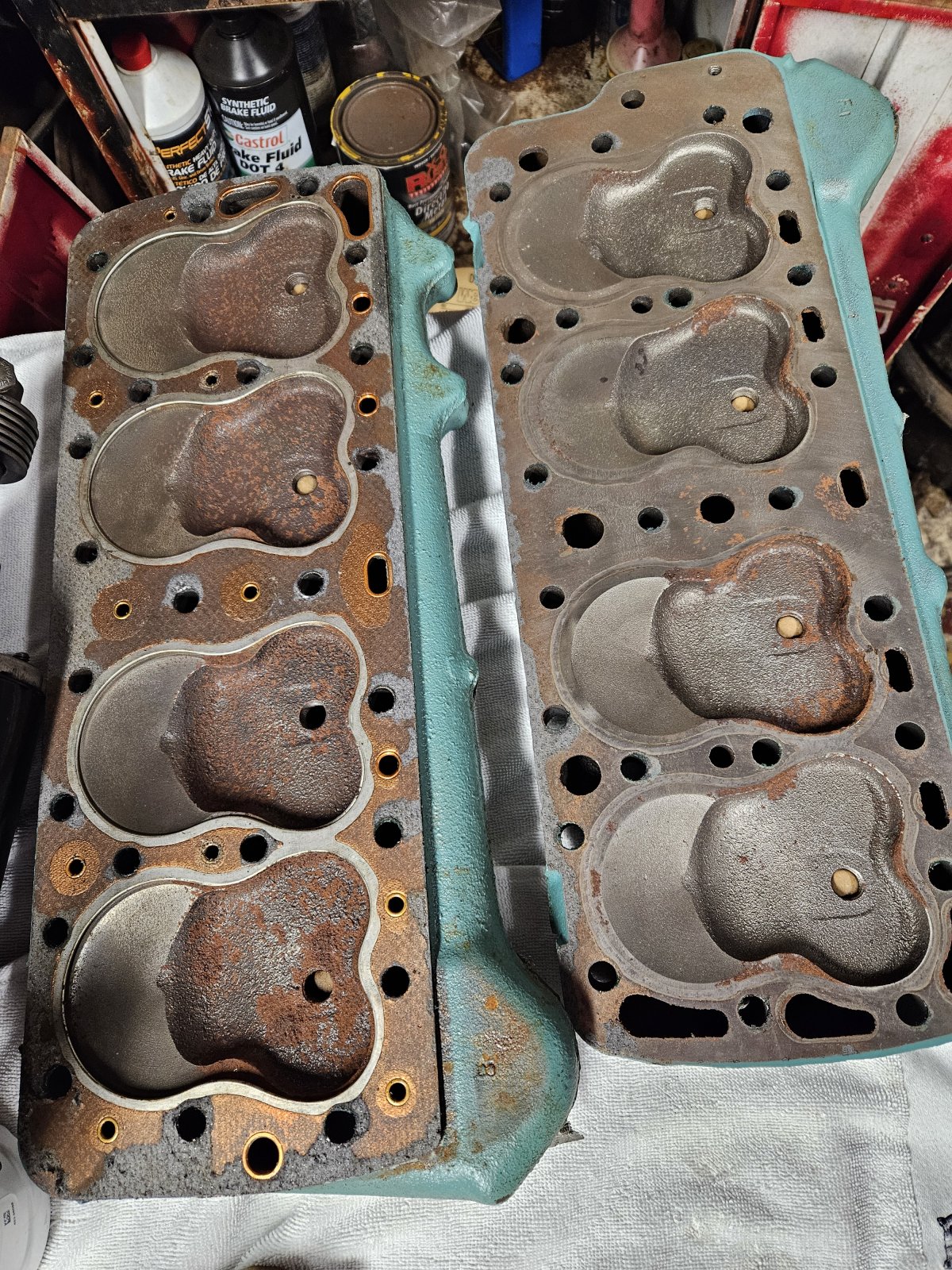

    Scored another EAB head and sent my Offenhausers to the shop for a spark plug heli coil. So, i have options.
    F- that, im putting the aluminum heads on. What are your thoughts? 20240226_195015.jpg 20240227_200012.jpg

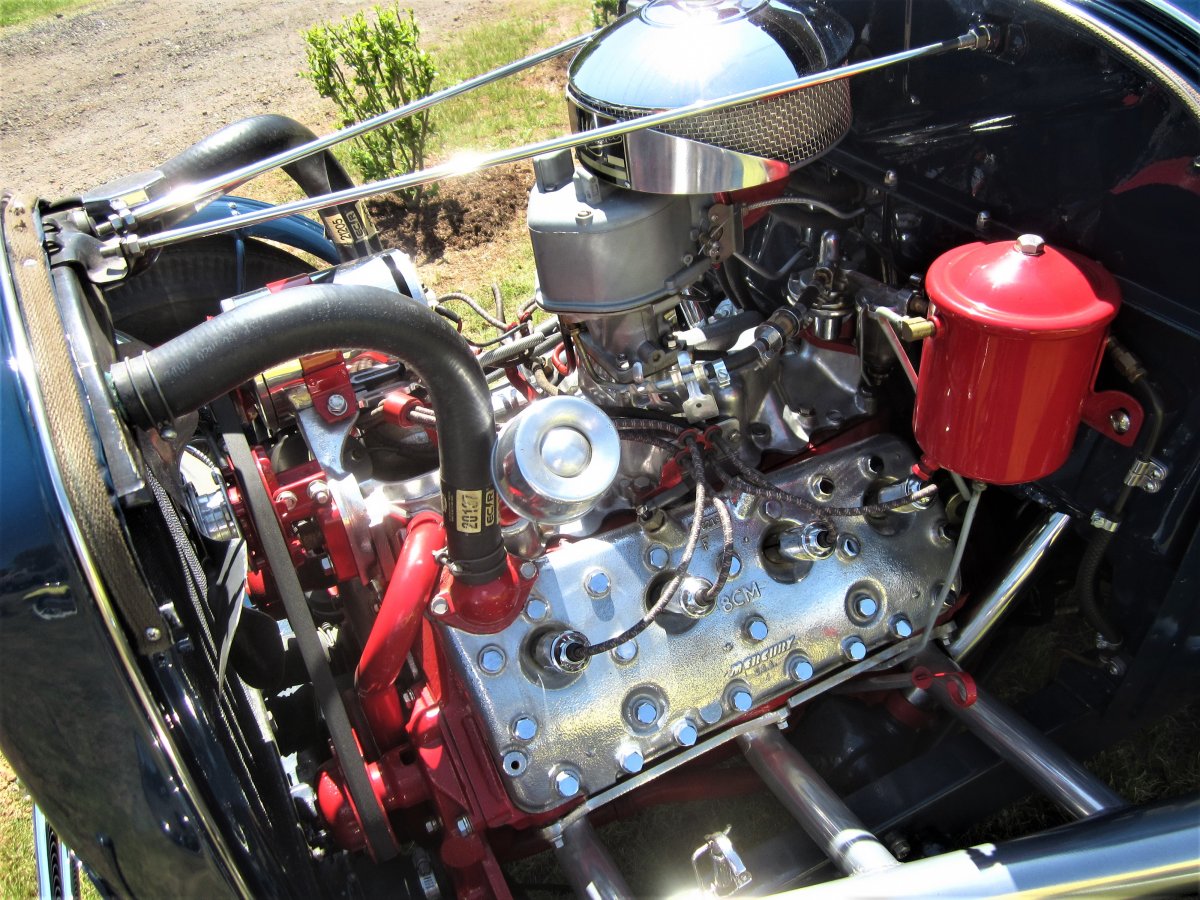

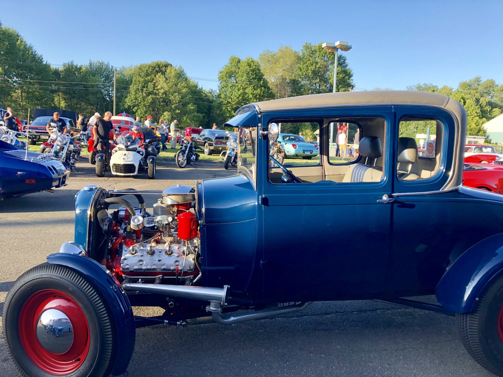

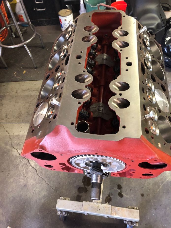

    EAB heads are pretty good. Aside from the looks, the aluminum heads may not get you much improvement. After looking all over for a pair of Ford made aluminum heads for my Mercury motor without success, I decided to mill a bit off and aluminum coat the cast iron Mercury heads I had.
    BTW: is that other flathead your second?:rolleyes:

    Which head is the low compression? :confused: They look the same best I can tell from he pic

    First, remove the head gasket and clean the surface.
    One indicator of which head has the higher compression would be to measure the depth of the combustion chamber at the same location in each head and see if there is a difference.
    Another (and better) way would be to install the spark plugs and then fill each combustion chamber with water, keeping track of how many cc's water it takes to fill the chamber. More water means lower compression.

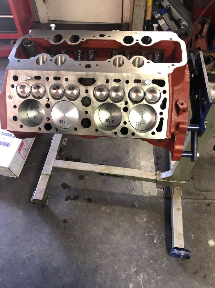

    Mine :p
    Nice score Wheeldog!

    What shape is the combustion chamber on the Offy heads? If the EAB heads can be milled a little and yield a similar compression ratio, I would expect the factory chambers to flow better than the aftermarket ones. Even if compression comes out a touch lower, the extra flow might give more power where you want it.
    A lot to study and check. Piston to dome clearance, valve to head clearance, quench. Hard to guess, harder to know what is best.

    Thanks for the input guys, I'm learning as I go. @JD Miller the head on the right is the EAB, took me a minute to see the difference between the two. The 8RT is deeper but only by a little.
