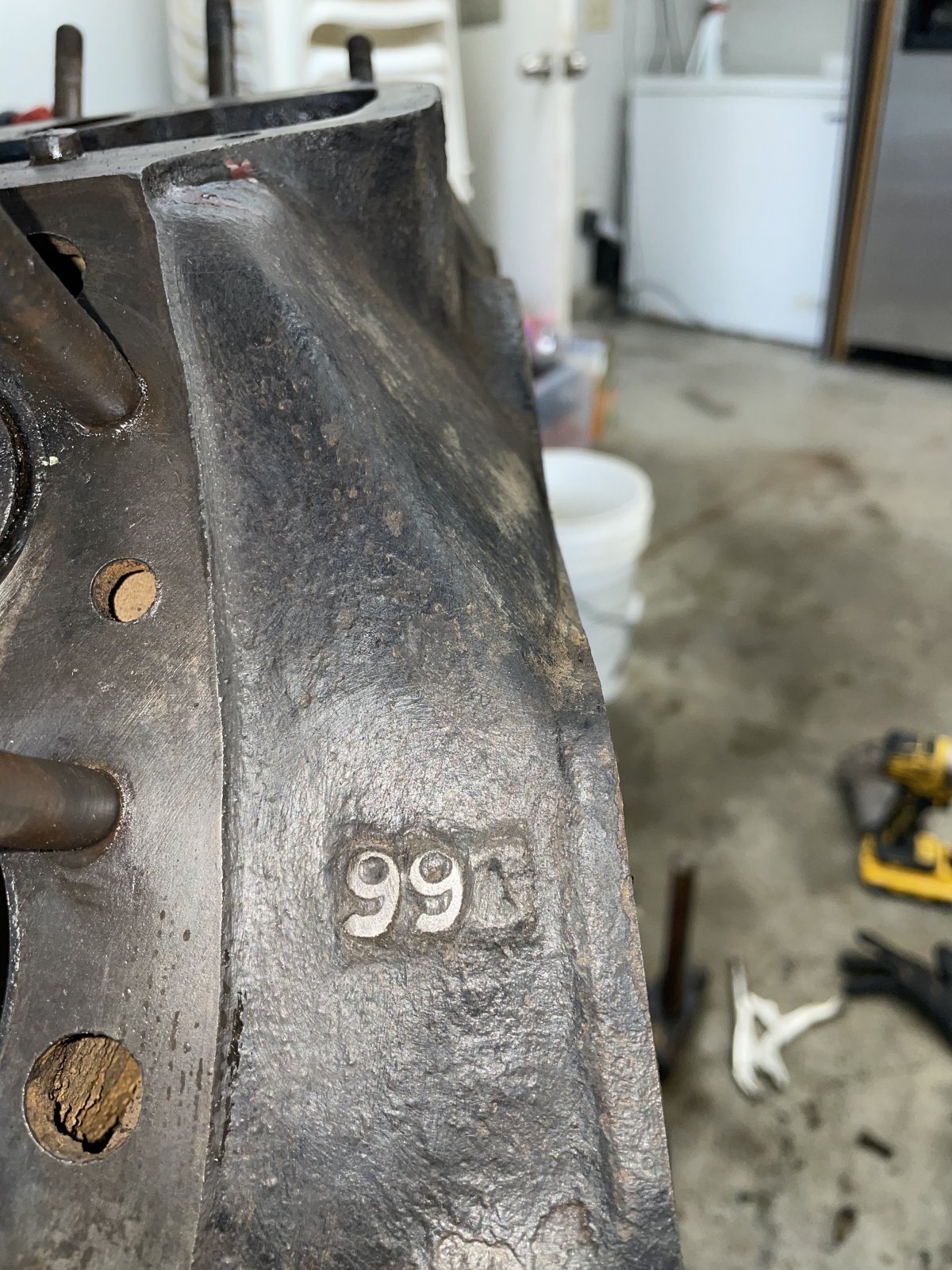

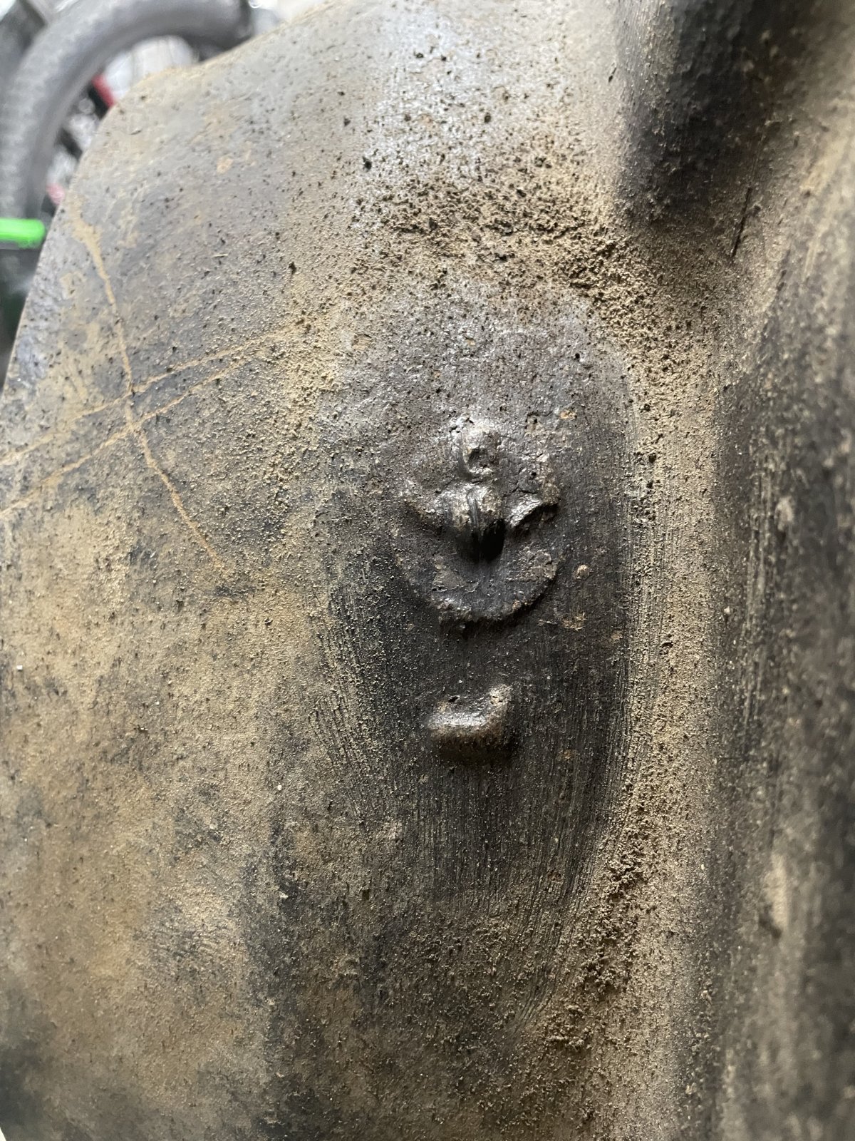

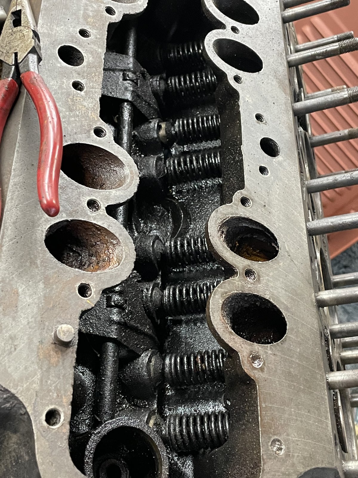

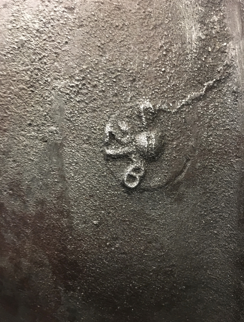

    I was given a flathead (59) that has no markings on it but the number 99 and an odd stamping. All of the parts that came out of it were stamped Ford Canada. Does anyone know what I have?
    Cylinders are 3 3/16
    there are no serial numbers or any marks any where. Any ideas?

    I’ve no knowledge, but recall 99T as a truck designation. Maybe or may not be related?
  4. 99 is good. Can,t remember all the facts though. I have one here. Do a search for Mercury 99 or something like that.

    The 99 you have is a 1939 to 1941 Mercury block. Very sought after by the flathead guys.

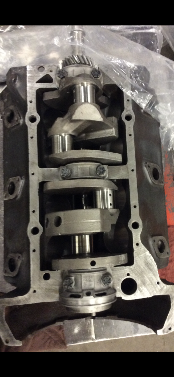

    Does it have "Welch" plugs in the pan rail? Should be four of them.

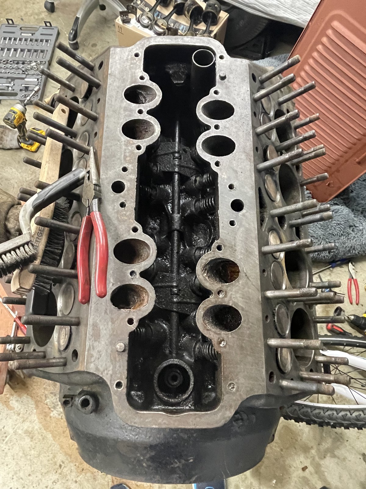

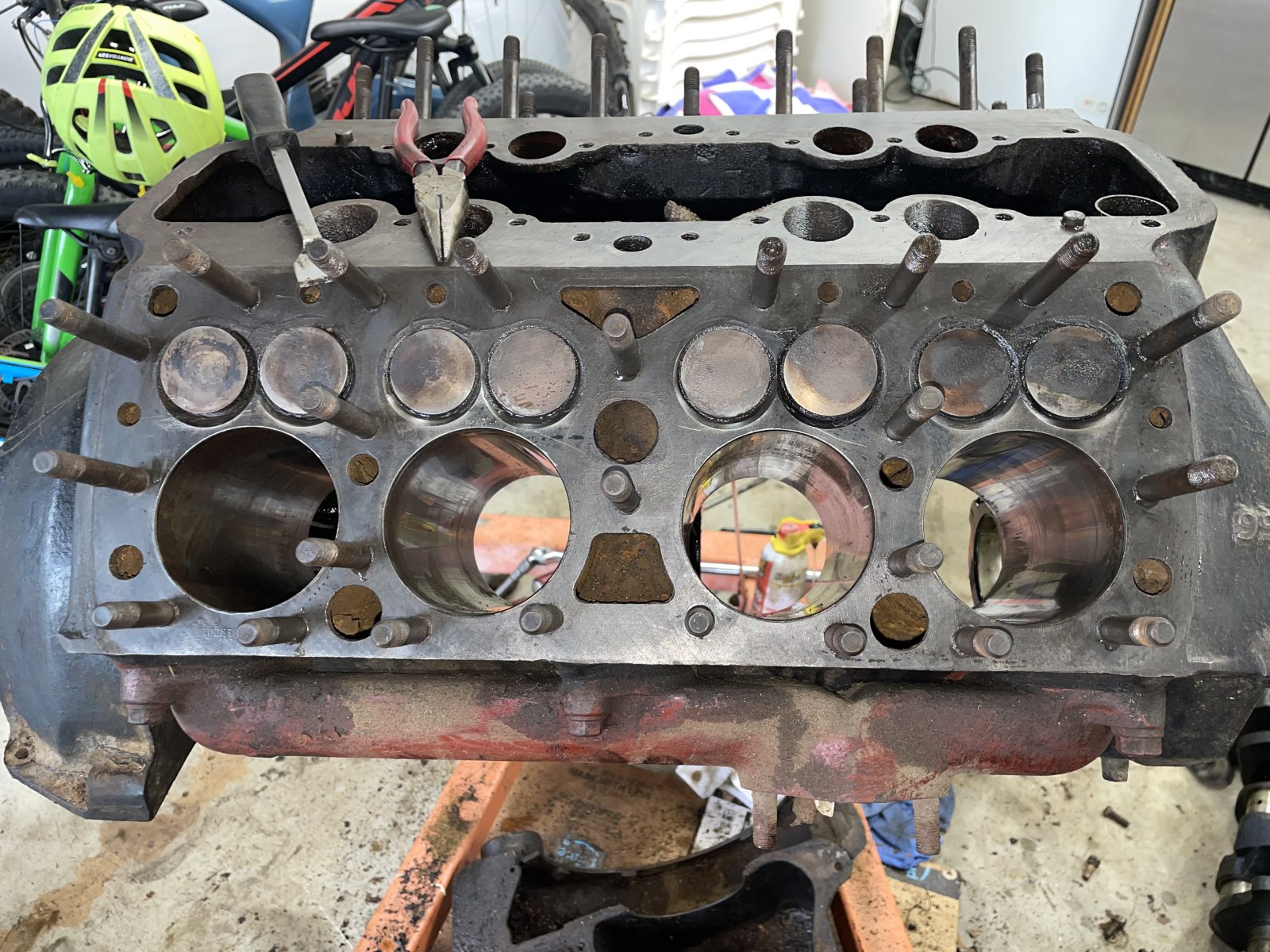

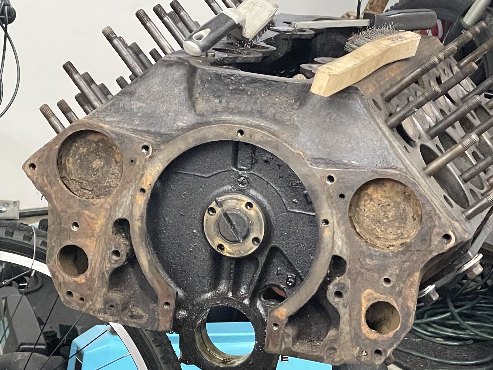

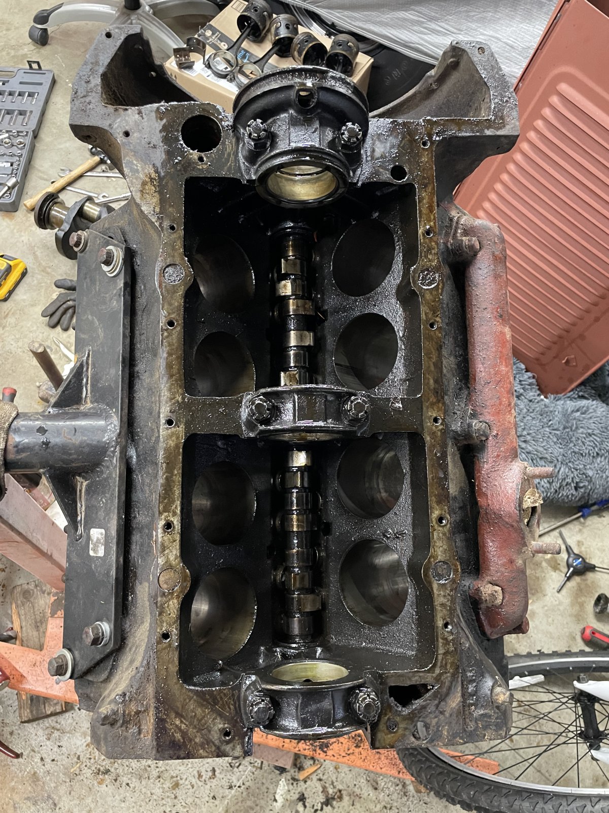

    Photos loaded. Thanks for any ID help.

    Yes it has the plugs in the rail

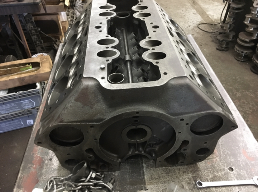

    Looks exactly like my 59A block. Even the coolant p***ages between the middle two cylinders is the same, and I recall there were differences in the shapes of those p***ages over time.

    Don't rely too much on the numbers on these things. Most numbers meant nothing to anyone but the original manufacturing crews. Can be very confusing.

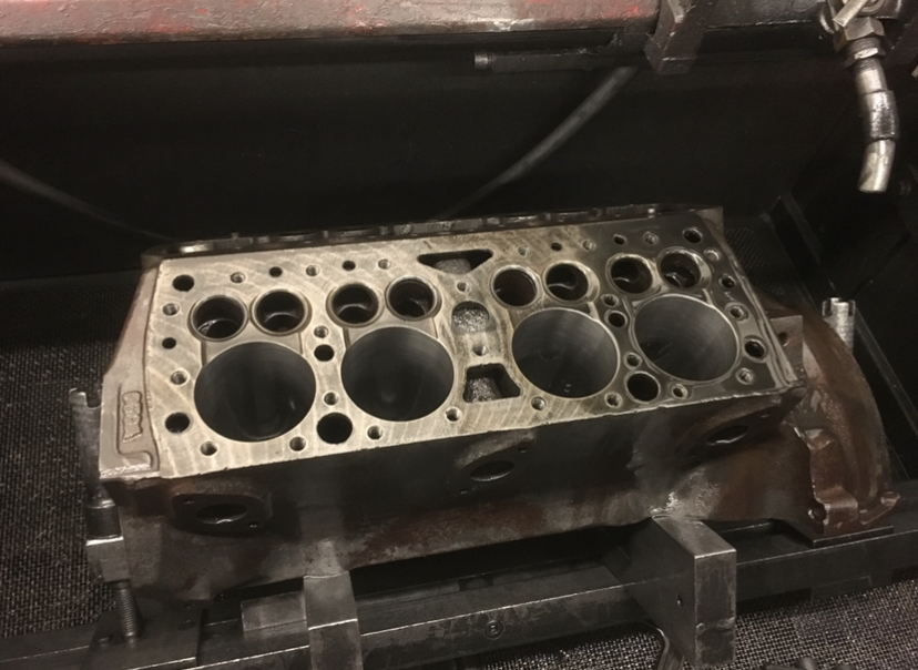

    The t****zoid shaped lower water jacket should denote 239ci Mercury or truck like mine. Flat intake boss is before 1941 I believe, I have limited experience. Great find!

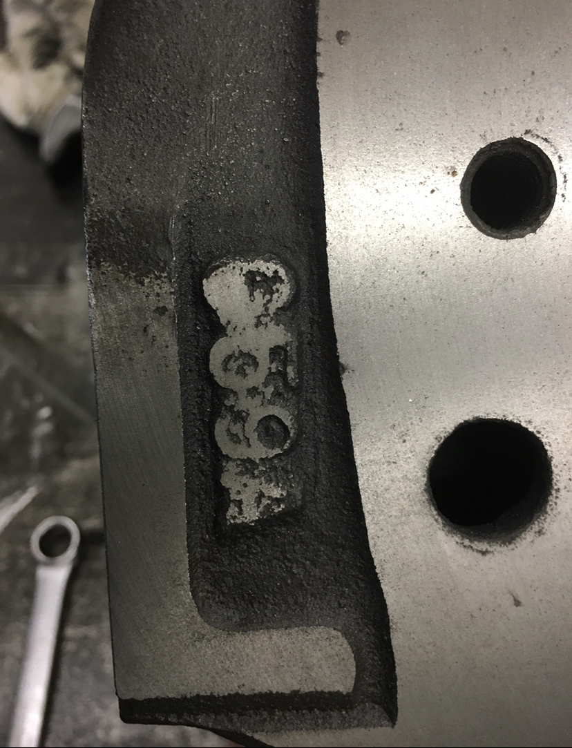

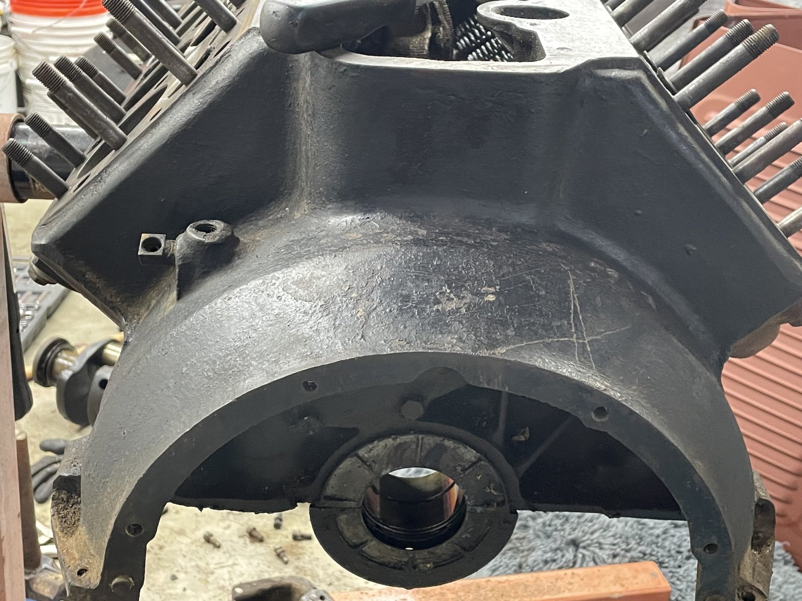

    IMG_7420.jpeg I found something interesting while wire wheeling the bell housing. Looks like military letters that I uncovered. The 2 came off but it was “216074”. If anyone knows what the numbers mean, I’d love to learn. I ***ume this was some kind of inventory number when the engine came out of the vehicle it was in?

    Definitely a 239 c.i. , 1939 Mercury "keystone" block similar to mine. Mine was an ex-military truck engine (with the combustion chamber relieving). Yours doesn't appear to have the relieving so I believe it may have been for the p***enger car. Regardless, provided it's not a leaker, you have a great starting point.
  20. The 99A engine that you have is what 39 - 41 Mercury cars came with - and a few trucks. The center water hole is round - which is one tell-tale sign. As it has the welch plugs in the pan rails, it is prior to 1942. The valve angles will be different than the 59x and 49-53 engines. The truck and later WWII versions were usually factory relieved - so yours probably came out of a car.
    I would first have the block magnafluxed, if it p***es that, then I would pressure test it and also sonic test the bores so you know what you have to work with. I have a 1942 version of this engine - heavily modified - in my 32 Cab. Mine was a NOS WWII engine - with what is commonly referred to as a "raised intake surface" (actually it is lowered around it).
    There are lots of often repeated old "wife's tales" related to this being a thicker block with more nickel content . . . and on and on. I've done a lot of testing on various 39 - 53 blocks and I see nothing that truly makes this block any better than the 59X series that came out after the war. As a matter of fact, the valve angle changes in the 59x series makes the later blocks a little less prone to cracking between the valve bowls and the bores.
    What type of flathead are you pondering building - there is a whole universe of potential options --> it all comes down to budget, expectations and how many cool go-fast goodies you want to put on it.
    Checkout the pot-metal rear crankshaft seal plates - yours appear to be for the labyrinth type of oil control (no seal) - you'll want to switch them over to the better rope style of seal plates and run later crankshafts with a seal surface on them.
    If you need any additional information, feel free to DM me - be happy to help.
  21. You appear to have a Canadian version (C59A) - which is usually different than a USA 59x block. Your deck surfaces appear to be more like a USA 99A block - with the round center water outlet and the t****zoid lower water outlet. Also, as yours was factory relieved, it is most likely out of a truck.
    Most USA 59x blocks have a round center and lower water outlets in the middle of the deck.
    I have not inspected a Canadian 59x block - so I am not sure about the valve angles, though my guess is that they would be the same as the USA 59X versions.

    I was doing some digging as I was curious, and my block has the 4 welch coolant plugs in the pan rails. According to stuff I’ve read on the web, IIRC these plugs were eliminated around 1942. Is this correct, and if so, why would my block have them if it is a C59A?

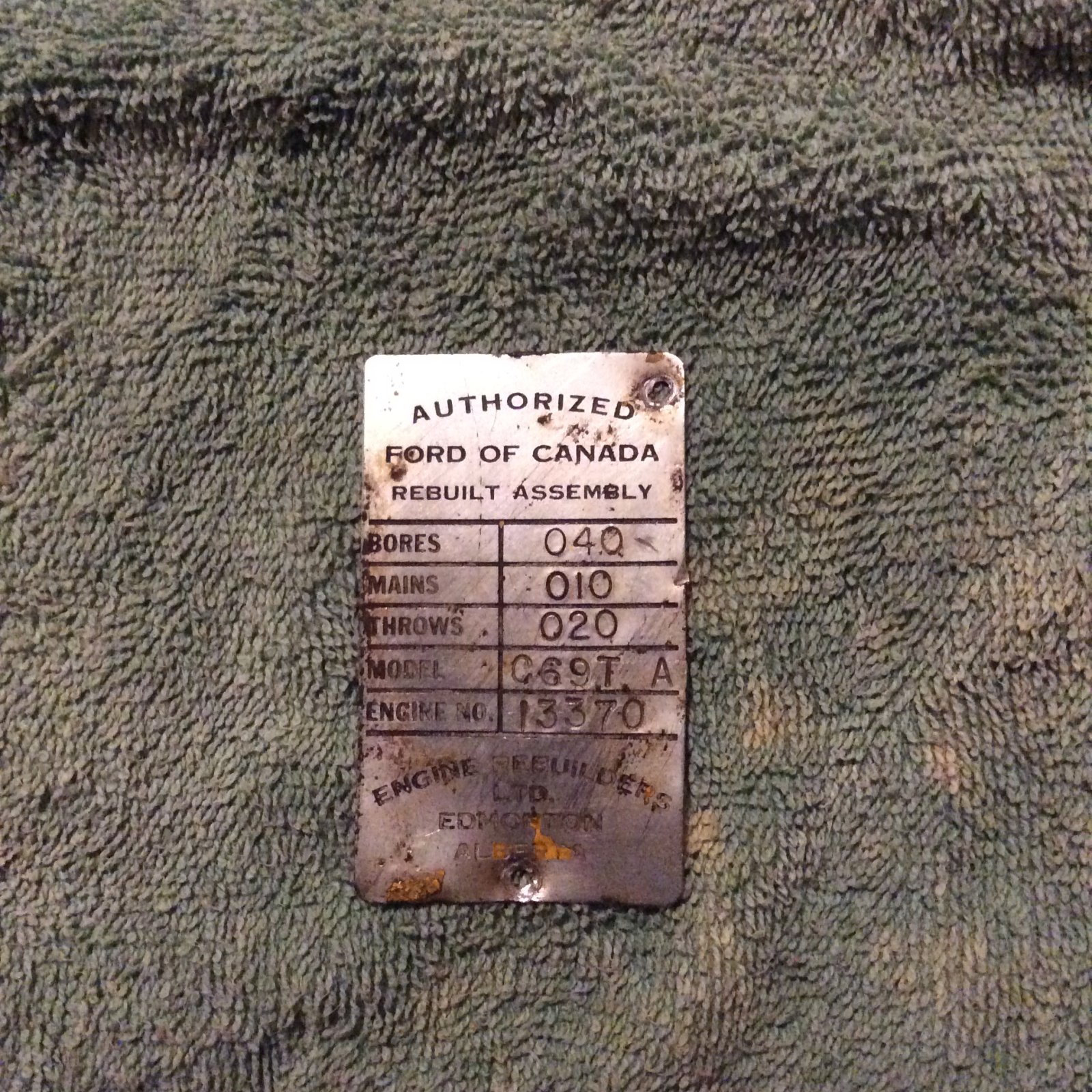

    To further complicate things, the rebuild tag that was affixed to the block says it is a C69T.A. It is a truck engine for sure as it was hooked up to the truck trans, and has the large oval clean out on the pan. It was used as an industrial engine, and I even have the heavy duty rad that came with it.

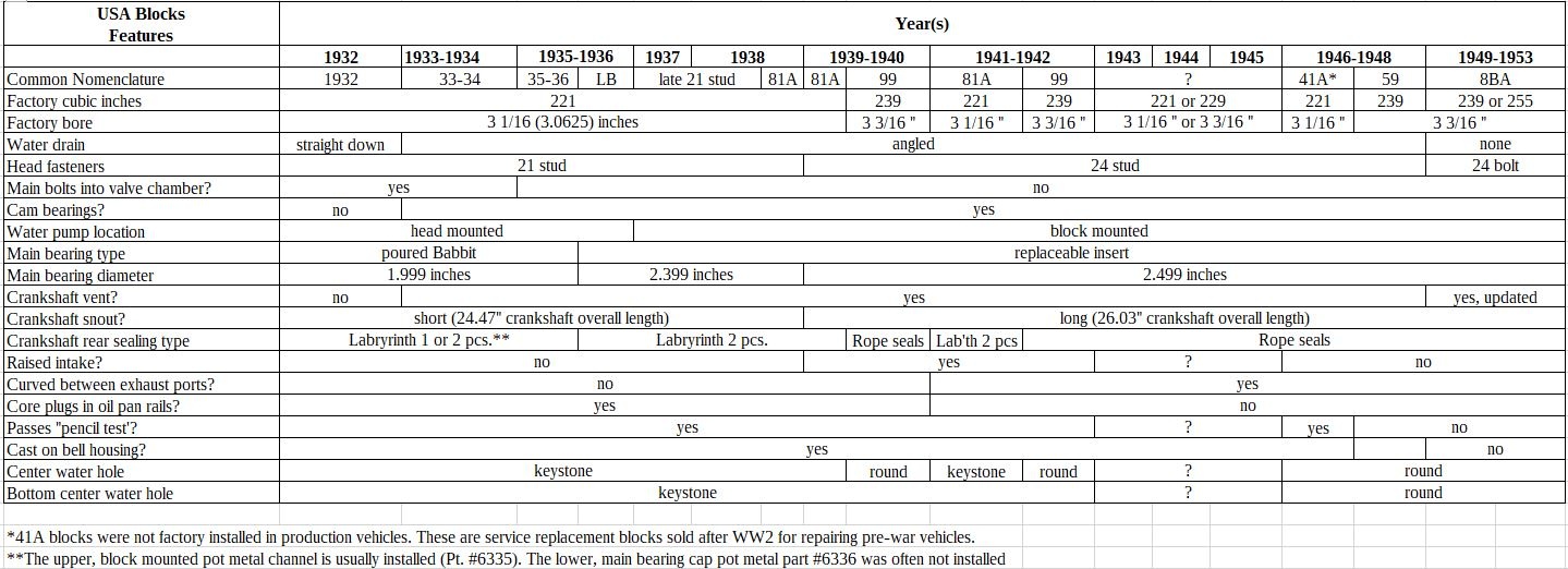

    Pictures backing up this table start on page #5 of the Techno link in my sig.
