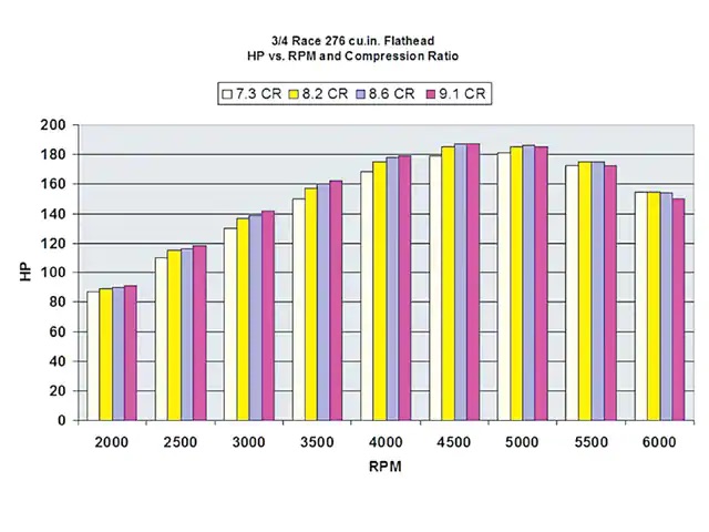

    I had my block pressure tested. Also went with the Isky 1007B regrind from Pete, but I have the stk crank and 0.060” overbore. If I could have afforded the slingshot intake, that would have been my choice, as I wanted to keep the generator in it’s stk location. If you’re building a 276, you might find this interesting.
