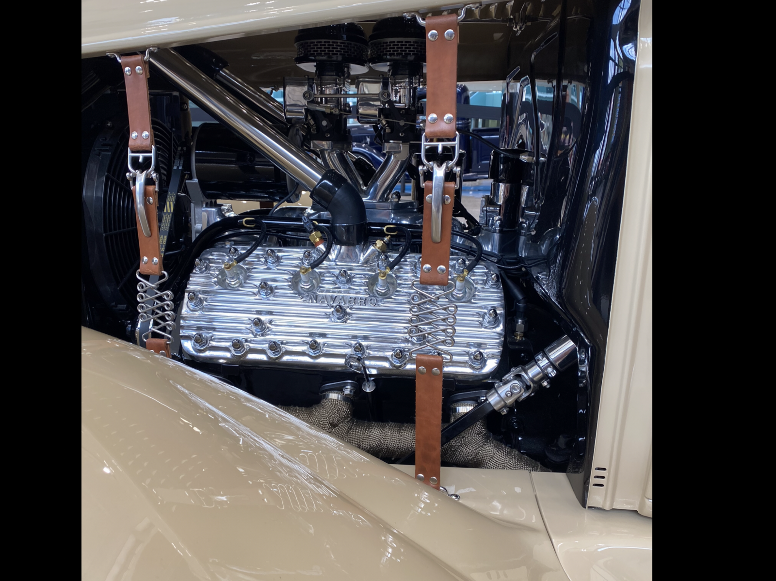

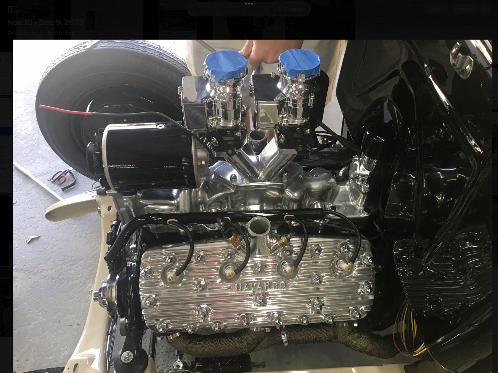

    If using a set of Ford manifolds doesn’t work out for you, Red’s Headers makes a set specifically for an AV8 with a Vega box. Like others have noted there are way too many variables in play here, but here are photos of my AV8 with Vega box and Red’s Headers #3448. IMG_6641.png IMG_6631.png
    seabeecmc, clem and Ziggster like this.

  18. Ziggster
    Joined: Aug 27, 2018
    Posts: 3,227
    Ziggster
    Beautiful engine/engine bay! That is some crazy attention to detail! Noticed the body colour matched paint around the openings in the tube for the spark plug wires. Makes my OCD look “normal”. Lol!
    clem likes this.
