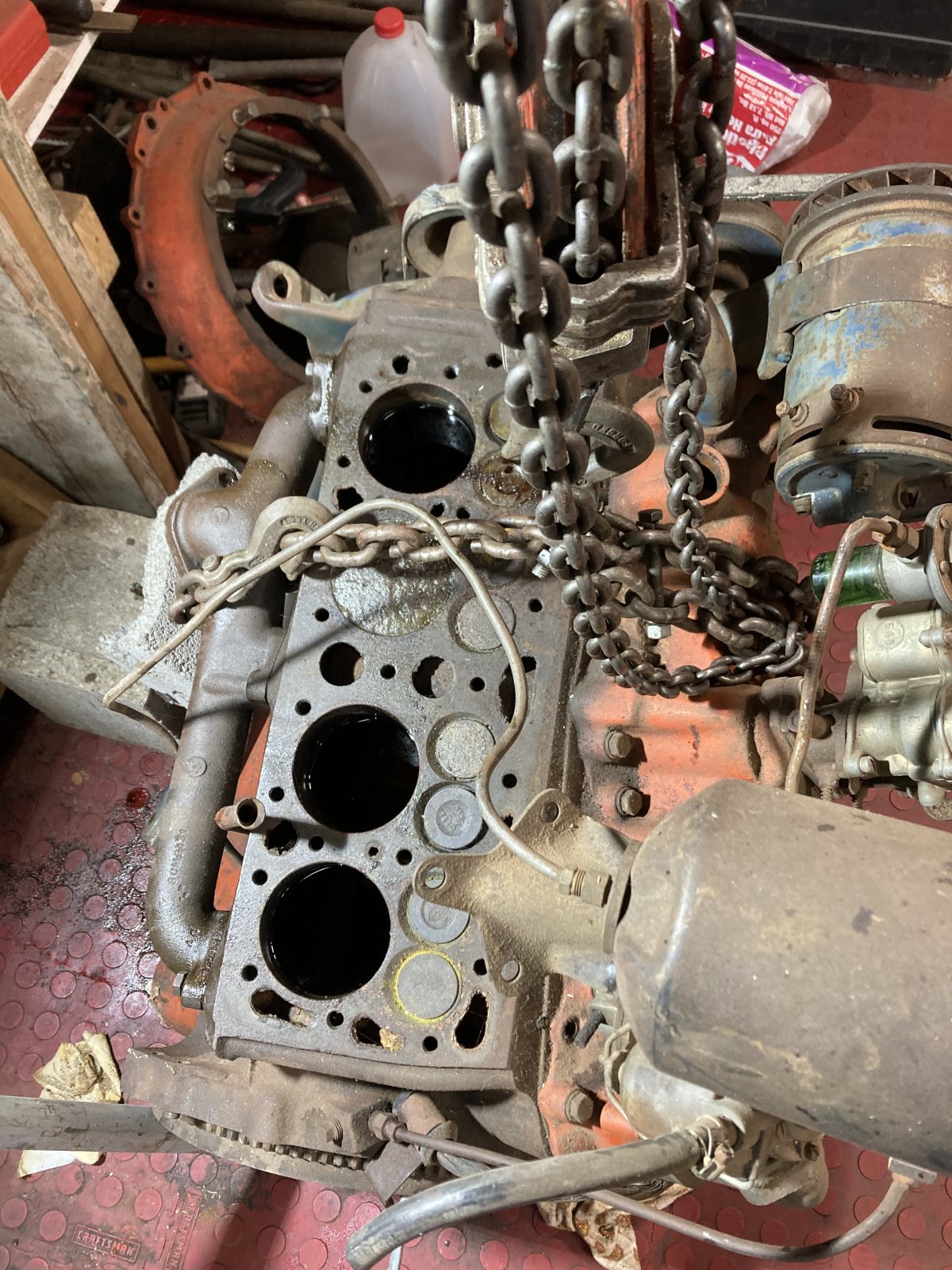

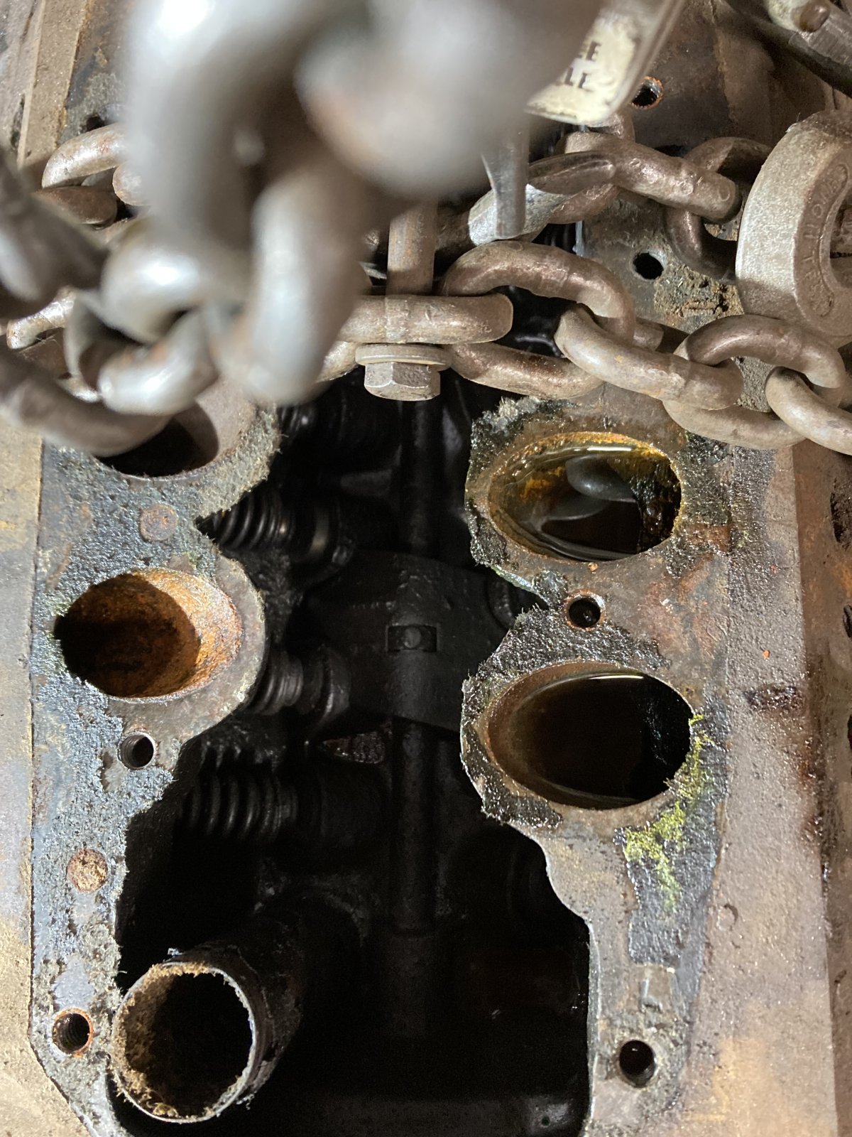

    Gentlemen,
    The flathead V8 that came in the 1951 F1 project I bought is truly stuck. I removed the heads to better facilitate lube etc. The normal stuff like ATF, acetone, Marvin's Mystery Oil did not help a bit. I have also tried letting Evapo-Rust sit on top of the pistons, hoping it would work its way down to attack the rust between the rings, ring lands, and cylinder walls. Unfortunately, the Evapo-Rust just stays on top. (I rotate the block from time to time to get both banks.)
    Very interested in any other suggestions. I have attached two pictures, since we all like looing at pictures, but I realize that has nothing to do with getting this thing to turn over.

    Pull the intake & take care of the lifters also ....

    Boy, from the pictures, that doesn't look too bad. I have seen ones that looked worse come free.
    I'm a big fan of Evapo-Rust, but have never seen it used this way. Maybe turn it over and pour it in the bottom of the cylinders? It only works on ferrous metals, so if the aluminum pistons are bonded to the cylinder walls, you might try something else. Also, the valve train can be stuck and it might be a good idea to remove as much of it as possible before resorting to excessive force.
    As a last resort, turn it right side up again, fill the valley with charcoal and light it. Cover it with a big piece of sheet metal after it gets going good and leave it burn overnight. Marshmallows and wienies are optional.

    Going by the picture, the piston is toast. As other mentioned, keep spraying everything and take the intake off so you can get to the lifters.
    If it still wont move, DO NOT force it out. I would suggest drilling a big hole in the top of the piston to relieve some of the pressure before you remove it. Driving it out by force can wipe out the cylinder walls with it.

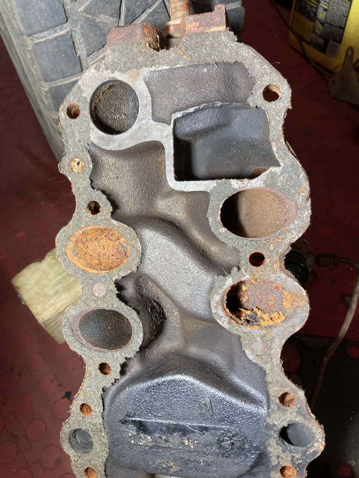

    Thanks for the many good suggestions, particularly about removing the intake. Turns out I have a great deal of rust in the #6 intake port. (Now this would have been the time for a picture!) I instinctively grabbed the shop vac to get out all the flaky rust and then I filled the port (both valves in closed position) with Evapo-rust. I am thinking I will let that sit for awhile. When it looks like that has cleaned the port up a bit I plan to remove the Evapo-rust and then I will fill the port with the Kroil penetrating oil, as suggested. (I recognize that the e-rust that I cannot get out may impede the Kroil a little, but I just felt that I had to get some of the rust out first.) Lots of rust where the valve goes through.
    Now I know where many of you are going. Why would I have all that rust in there ? I have read that the flatheads can have cracks between 6 and 7 and 3 and 4. I have not seen cracks with the naked eye but will investigate further.
    The intake gasket was fully intact. The heads had long been removed when I bought this truck, so I guess a head gasket failure could also allow coolant in the intake port.
    As to what I am trying to do - I know I can sell the engine for more if I can free it up. But with that said, I would also like to help someone keep a flathead on the road. (I am planning to re-use a 302 I have on hand for the 51 truck.) I will also look into the Gibbs oil. I don't plan to set the engine on fire, that will be for the next guy, who will probably have much more skills than I do !

    Thanks for additional info. I may have jumped to the conclusion regarding any cracks. The previous owner dis***embled the entire truck and let it all sit on his carport for who knows how long. After a further review, I think rain water was allowed to run through the carb and then worked its way to the front of the engine. (Not just intake #6 as I reported earlier.) I have attached pictures of the partially opened carb and the underside of the intake manifold. At any rate, I will ramp up the various unsticking methods and keep you guys posted on how it goes ! As always thanks for the suggestions. IMG_0574.jpg IMG_0573.jpg IMG_0575.jpg
