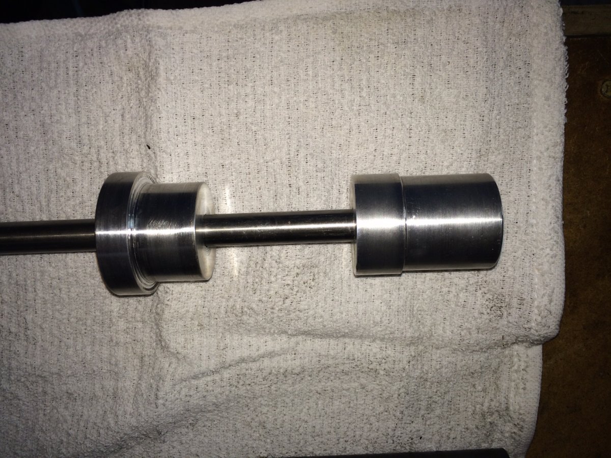

    I made this cam bearing driver on my trusty Jet lathe. Will probably only use once but I love making this kinda stuff.

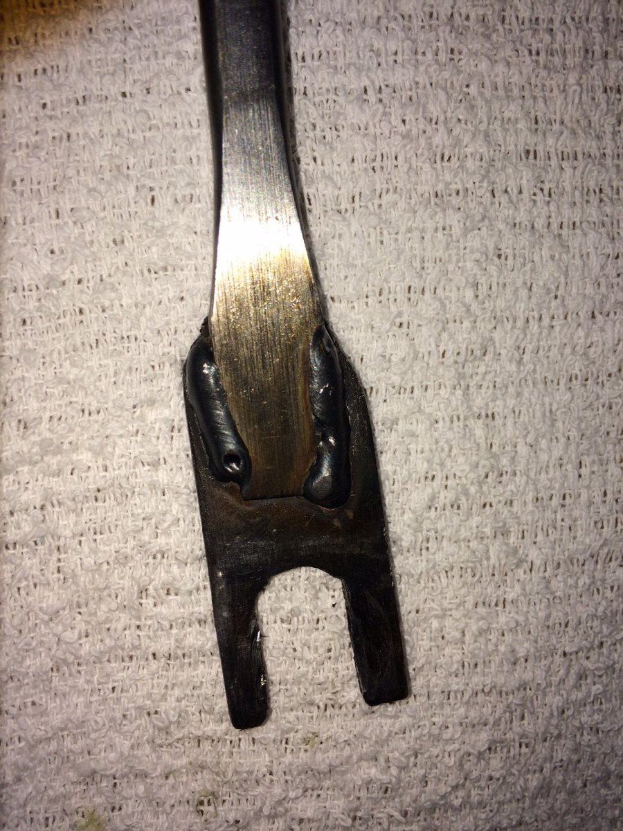

    Drilled holes to hold tappets when adjusting, tried nail, too soft....tried drill bit, too brittle....hmmmmm, now what.......old Snap On radiator hose removal tool, perfect.
    Run your adjuster on the tappet down to about two threads showing before installing in block....you'll thank me later.
    Tho the adjuster takes a 7/16 wrench, you'll find an 11 mm wrench actually fits slightly tighter, with less slop.
    The adjusters are tight, real tight...I realized the palm of my hand would take a beating during valve adjustment time so I used a small section of pipe as a cheater over the end of the wrench....yup, my palms just fine.
