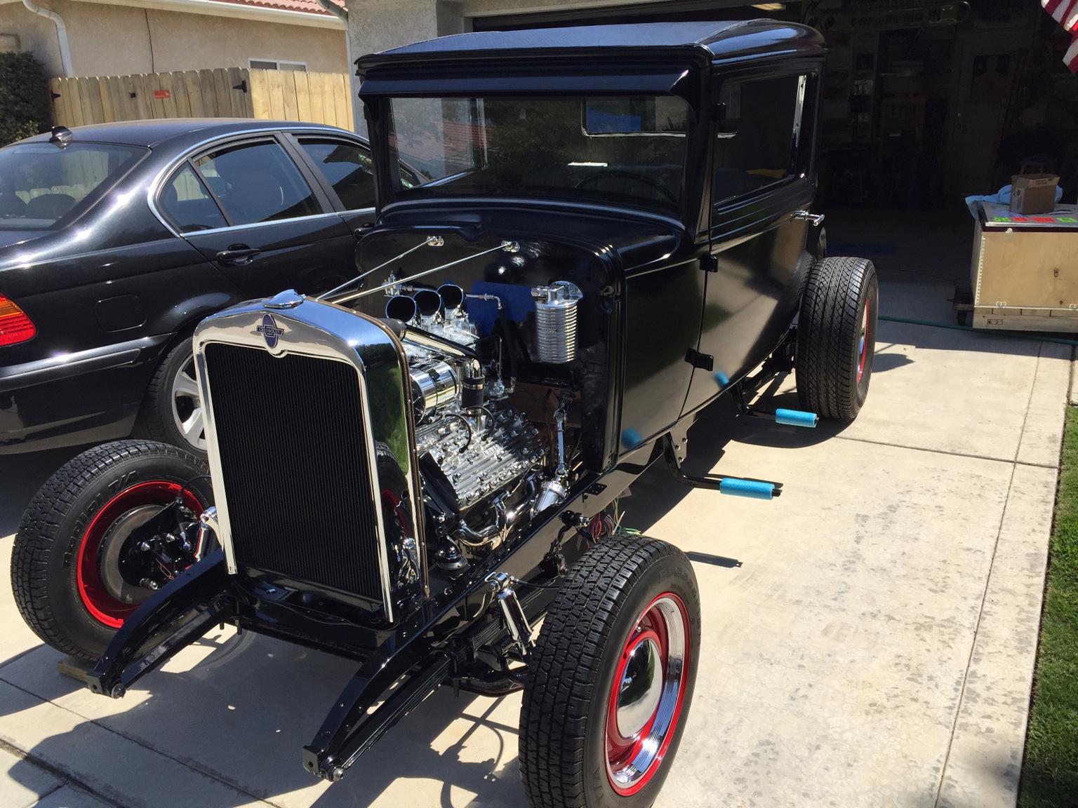

    Somewhere in the neighborhood of 9K. My father in laws. How else are you going to spend your 401K?
    I stopped trying to keep him on budget when he wanted the new 97's...in chrome. Six bills apiece. I could build a SBC for that!
    Hotrodmyk and Shamus like this.
  17. Petejoe
    Joined: Nov 27, 2002
    Posts: 12,783
    Petejoe
    Wow what a beauty. Chromaholic for sure. I'd hate to run that engine everyday and have to clean it.
    600 each?? Omg.
