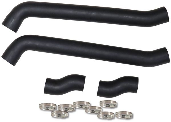

    I'm running a 49 to 53 flathead on a original deuce frame. I'm trying to find 2 lower radiator hoses. It is a big 2 inch drop from center to center. I've tried all of Flathead Jacks hoses and his aluminum piece that drops down...it didnt even fit. I think my water pumps are alittle too large for his part. The piece of aluminum he offers hits the fan belt. Have you found any hoses that are made for a late model car that a piece can be cut out of to fit...it needs to be shaped like a tight S.

    not sure if it will help you but I was able to use shoebox ford lowers as they have a kickdown built in the hose and I just cut to fit.

    On my 32 with flathead, using original motor mounts, I had the radiator shop angle the lower hose connections about 15 degrees, then used the 49 Ford lowers, as mentioned

    I'm also looking at cutting 2 existing rubber hoses.
    Gates 21138
    Dayco 72237

    I made a form of my hose angle and length with a piece of corrugated expandable aluminum pipe (or whatever you can come up with) and looked for the biggest auto supply of hose. Found a perfect match after cutting off the excess hose not needed.

    Bob Drake also has a hose kit for 59AB and 8BA with truck pumps with perfect (for me) lower hoses, other than t******* the ends for length. The uppers fit 32 radiator with stock, angled outlet tubes, are one piece rubber, no tubes and only two clamps per hose. Two kits, depending on fan used.
    MEC's (below) are nice, but did not work for me. Too deep.
    Sold them.

    Carquest hose [HASHTAG]#21236[/HASHTAG] worked well ...doesnt look as pretty as the finland piece.

    I have made my own using stainless tubing and flat stock. Make an oval band with the correct dimensions and weld the stainless tubing to it and close it in. Kind of like a sardine can with inlet and outlet.

    Could you custom make hoses by soldering copper tubing to fit like the early Ford pickup truck pumps on this 40 Ford with a Walker radiator? These have been on the car for 20 years, so far.
