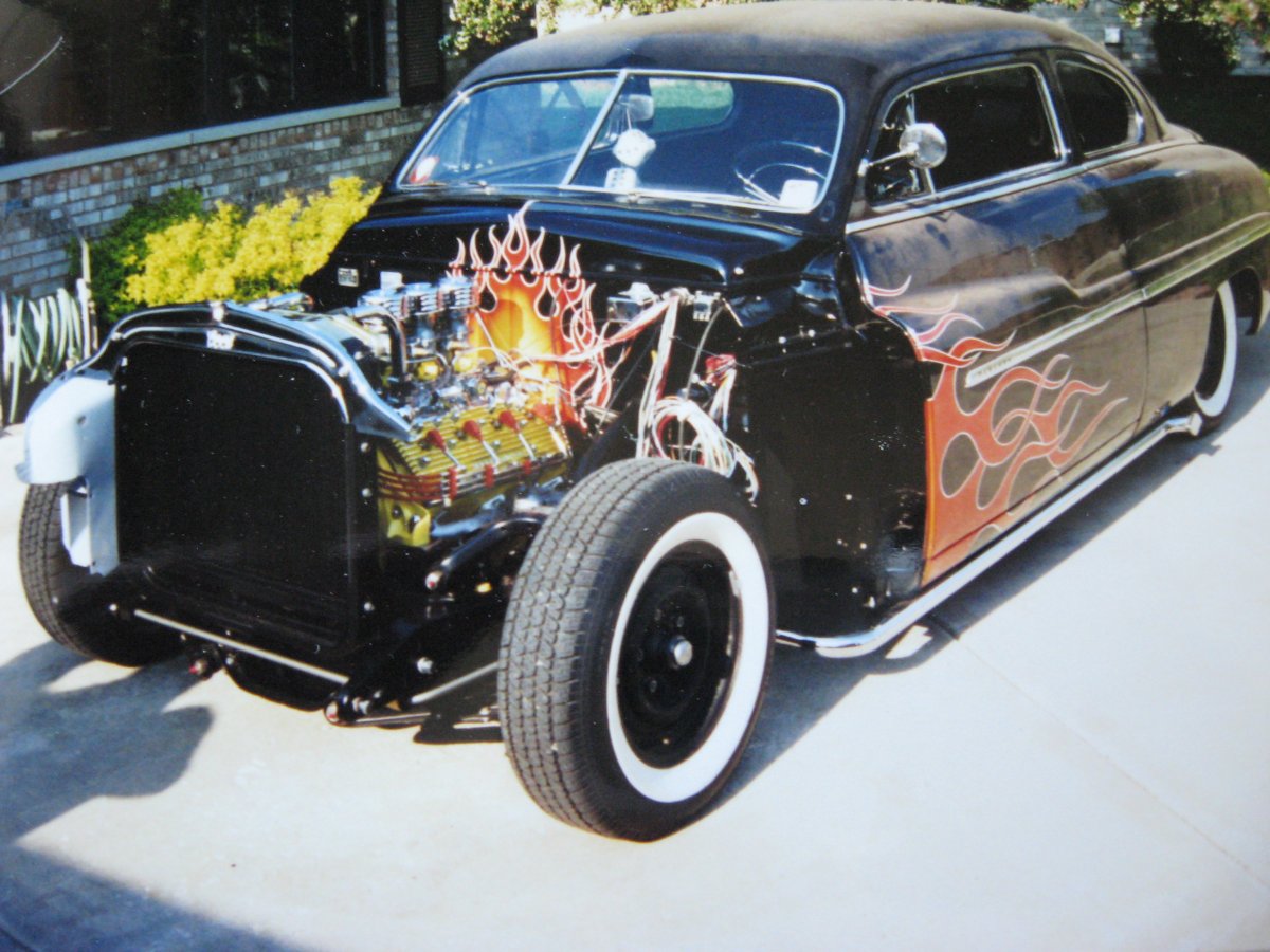

  7. Flatheadjohn47
    Joined: Aug 18, 2012
    Posts: 1,417
    Flatheadjohn47
    from Lewes, DE
    image.jpg Try to avoid decking the block.Flathead v8 have a pretty thin deck and unless yours is warped or needing attention,I wouln't deck the block unless absolutely essential.
