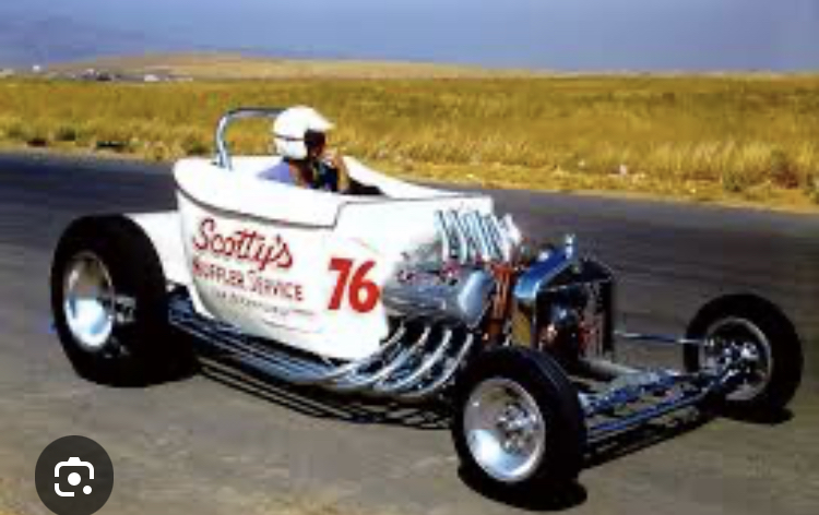

    How’s this for digging up an old thread!!!
    I’m starting my project to build a clone to the Scotty’s Muffler T Roadster and while doing some research I ran across this thread about magnesium pistons. While going through some of the photos and information of the car I noticed that it mentioned this engine ran Thomas Magnesium Pistons in it. In some of my other research I’ve learned that the rotating ***embly was extremely light in this engine and it was very successful At Bonneville before it was put into this hot rod. Anyways I thought it was kind of cool that I ran across this topic on here but never saw it before in the years I’ve been a member of the board. There’s actually another thread that’s about this too. There’s not much mention on all of the internet that I could find about this subject even now.
