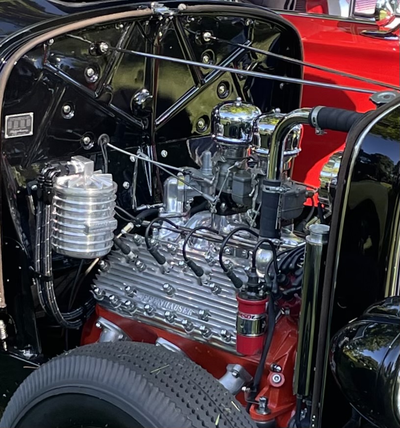

    I have a firewall mounted bee hive filter with copper hard lines from the block to the filter and also from the filter back to the oil pan. The lines are @10 years old and the line from the block (oil pump) to the filter started leaking at the compression nut on the engine block.
    I will replace the line and the fittings but wondered if I should use a flexible line rather than a hard line. My thinking is that engine vibration may have caused the fitting failure over time.
    I like the hard line look but could put a short rubber line from the engine block to the supply line to absorb vibration
    What do you flathead's think, any recommendations

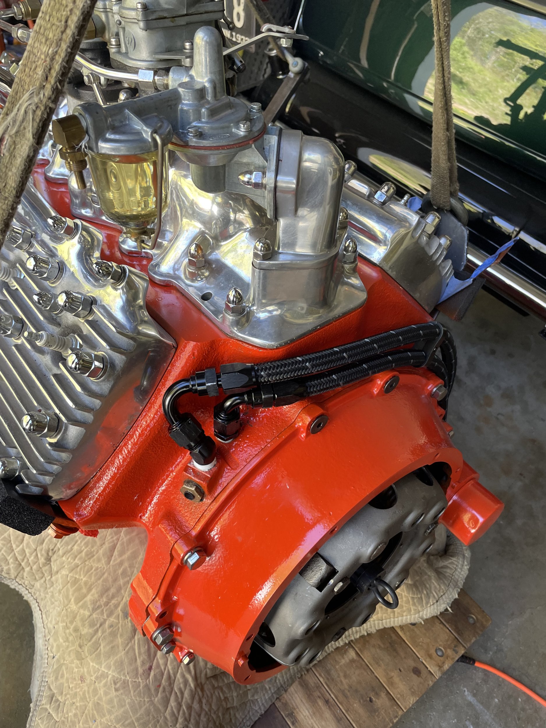

  7. ct1932ford
    Joined: Dec 3, 2010
    Posts: 13,376
    ct1932ford
    Toms Dogs, Xman, seb fontana and 2 others like this.

  10. ct1932ford
    Joined: Dec 3, 2010
    Posts: 13,376
    ct1932ford
    I used Racetronix fittings and hose. Size 8AN
    It’s just under 1/2”id
    seb fontana and MojoRacing like this.
