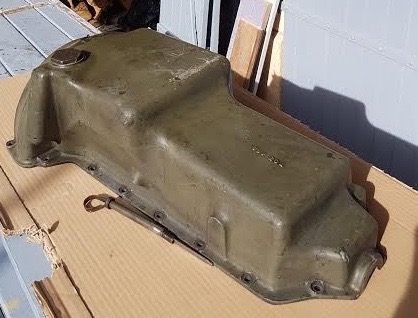

    I know this is an old post but I thought I would share what I came across.Nice aluminum oil pan.Would look fantastic on the right flathead powered car.
  8. Nice one Sheldon. Looks pretty beefy. I just put my steel truck pan with the big inspection plate on the bathroom scales and it came to 10 kilogram. Whats yours weigh.

    Howdy, It weighs 7.5 KG.I shipped one to the USA a month ago and kept it under 10kg with thin (8mm)plywood bolted to the base to keep it secure and wrapped it with cardboard.Cost 110 Euros to ship.

    Here is one with the OEM paint on it.
