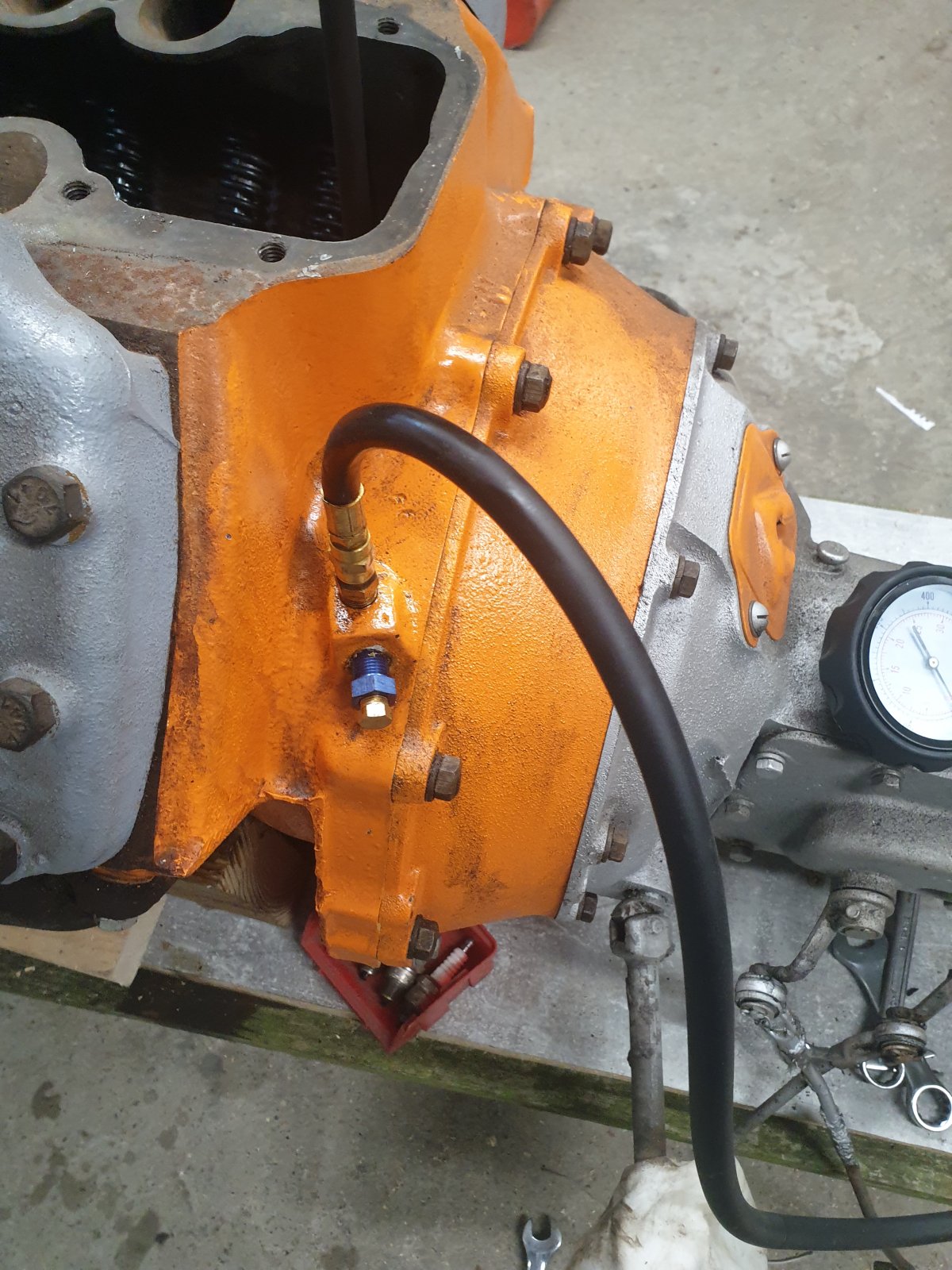

    I've just purchased a 1951 flathead 8ba.

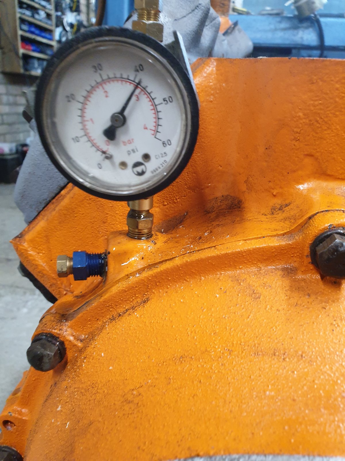

    I've connected a mechanical pressure gauge to the rear of the engine and turning over on starter I get about 5psi oil pressure.
    On startup and revving it doesn't get anymore.
    I'm running 30 grade oil.
    It has the original filter - This didn't seem to have a restrictor so I have blocked the feed on the block - no difference.

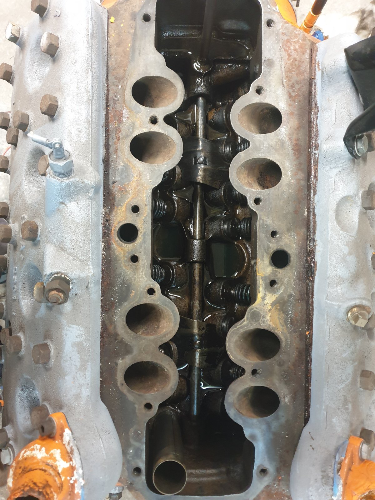

    I've removed the inlet manifold hoping to find a pressure relief valve (see attached picture) but don't know what i'm looking for?
    Also I've taken off the front cover to see if the I can see if the top feed has the plug in, but can't see behind the sprocket - When I turn it over like this I don't see any spraying of oil at the front - I would expect to if the problem was the blank plug missing?
    Now when I turn it over as it currently is - I only see a little bit of oil coming up the fuel pump post and a little but dribbling out of the end of the camshaft.
    Where should I be looking for flow of oil?
    I'm ***uming my next point of investigation is take the sump of and see if the oil pump is okay and the play in the crank/bearings?
    Any suggestions ?
    many thanks (I'm in the UK)

  2. tubman
    Joined: May 16, 2007
    Posts: 8,294
    tubman
    The relief spring in the later (8BA series) flatheads is in the pump itself, not in the valley like the earlier models. It looks like you're in for a teardown.

    You might just want to try another gauge before you tear into it.

    So my brand new mechanical gauge seems to be the problem - Hooked up a another gauge and it goes up to 40psi just using the starter (serves me right for buying a £15 cheap gauge) . Thanks everyone for their help

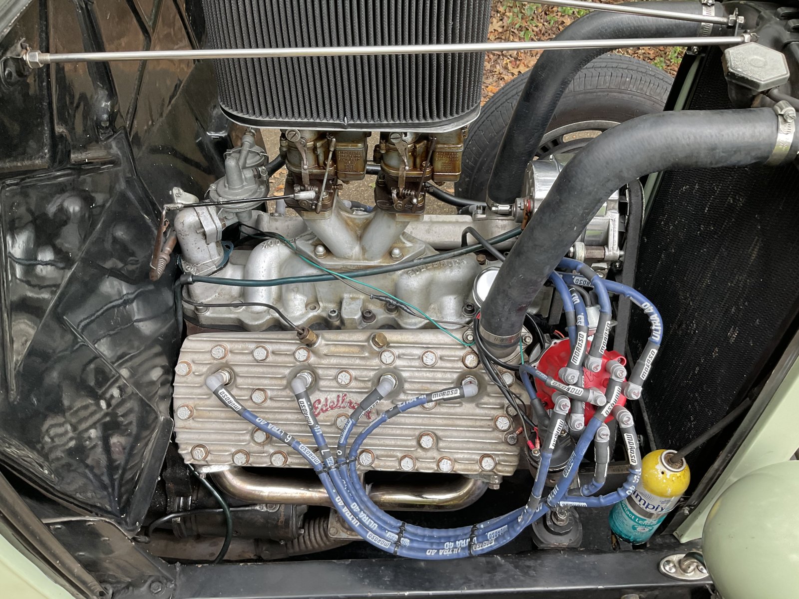

  9. Flatheadjohn47
    Joined: Aug 18, 2012
    Posts: 1,416
    Flatheadjohn47
    from Lewes, DE
    Just for added info—-I was informed many years ago that 10 pounds of pressure for every 1,000 rpm was adequate for a Flathead ford v8. I have not used a filter on any flatheads I have built for my own use or those motors I have built for others because the flathead has what is referred to as a partial flow oiling system that is not very efficient—-was led to believe only 20%of the oil gets filtered and if byp***ed or removed from the engine MAY actually show a small increase in actual pressure. I use the old mantra—-oil is cheap; motors are not. I generally changed my oil every thousand miles; maybe overkill but I have never blown up a flatmotor and I have run many very hard. Had a 32 cabriolet highboy that was drag raced and using a lower gear in the 9 in rear ran 80 mph in the 1/8 and next day replace the pumpkin to a 2:75 and continued to run many many street miles. Flatheads Forever!! IMG_2200.jpeg IMG_1915.jpeg IMG_1917.jpeg IMG_1778.jpeg IMG_0848.jpeg IMG_0649.jpeg IMG_0723.jpeg
