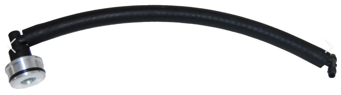

    I recently purchased this kit on-line for my flathead. The aluminum piece fits the road draft hole on your intake.
    You can see the plastic tee that comes with the hose, it is designed to tee that vacuum source you are referring to. I needed more vacuum for my application so I drilled and tapped a new larger fitting.
    More to your question, something is better than nothing right? Many have found success with this installation on their flatheads.

    That's just it. I want to know if using that port for the dizzy and PCV will choke it up and not be enough air flow. If that's gonna happen to me, then I might as well look for another option or solution.

    I got mine on ebay for $50. I also have a vacuum plate to place under my carb on my 8BA for my c4.
    You'll be fine.
