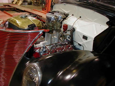

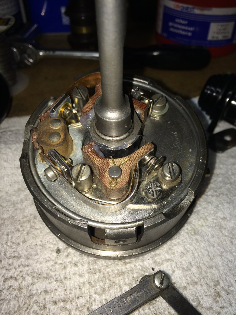

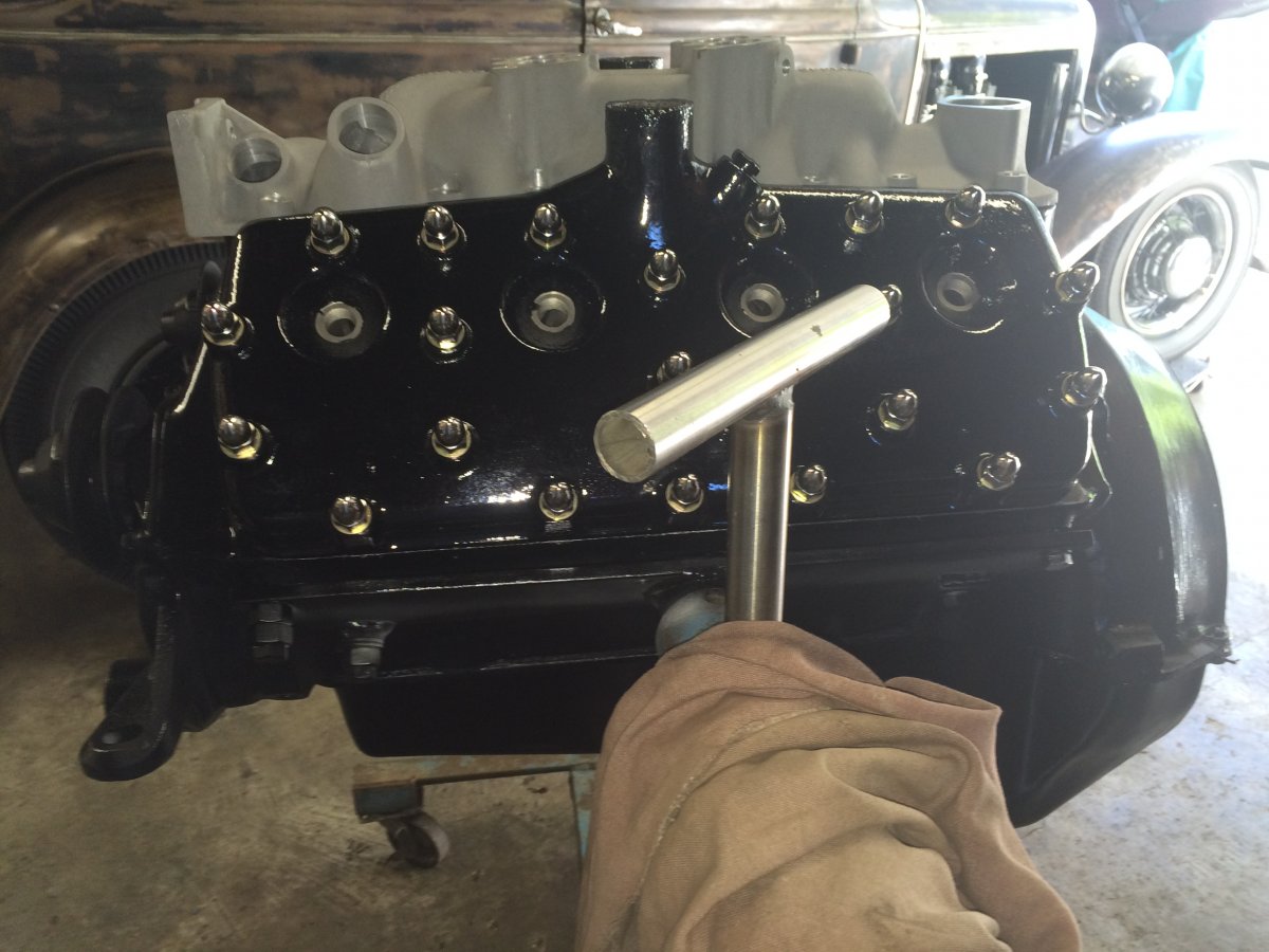

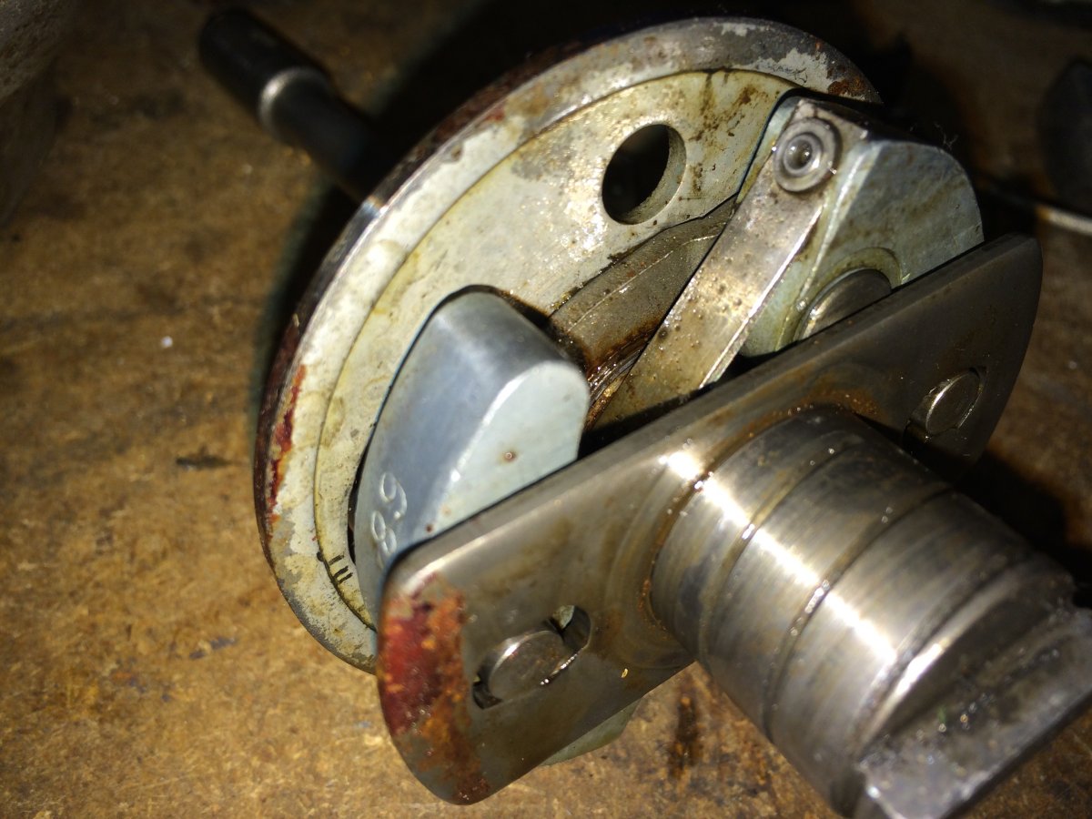

    image.jpeg image.jpeg image.jpeg image.jpeg Finally got the heads torqued down, hot damn.

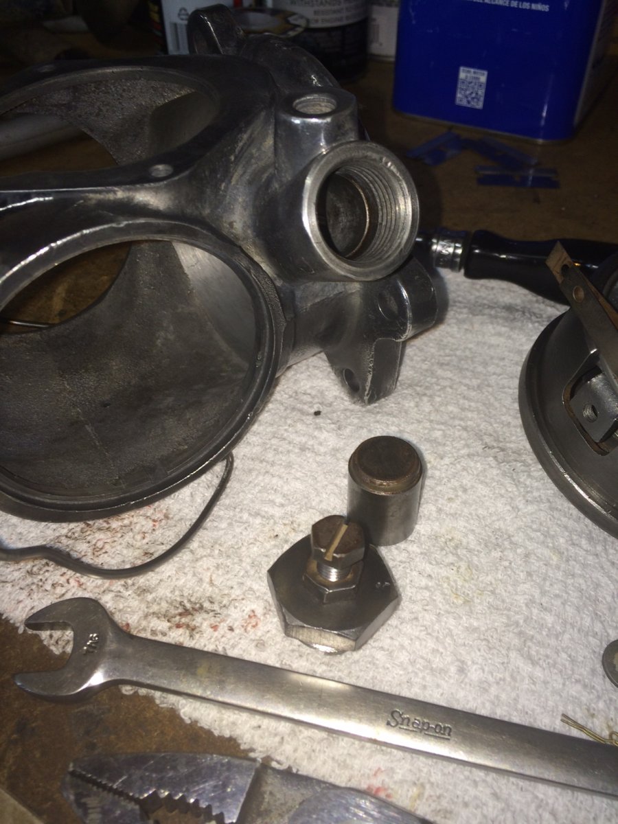

    Question #1... tore my dizzy down to last nut, bolt and circlip. Can anyone tell me what this port is for. Looks like it has a vacuum line port. And how does it work. Im so confused.
    Question #2... what is the front opening in my intake manifold for. Looks like its a water port for something
    Statement#1... Happy Labor Day to all that toil and God bless our troops. They are special people doing an unbelievably tough job. I for one cant thank you enough.
    1947knuck, LOU WELLS, cretin and 3 others like this.

    #1 Vacuum for the vacuum brake as opposed to vacuum advance.
    #2 1st hole for the roaddraft tube,2nd hole for oil fill tube

  4. Ron,
    You have a 49-53 intake on an early 21 stud motor. In the morning I will take a few pictures for you of the tube and where the vac. Comes from on a stock 49-53 engine.

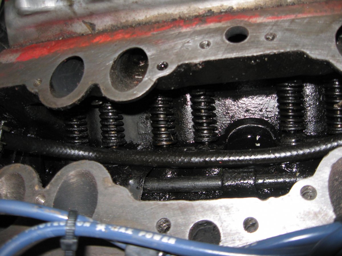

  5. Ron Brown
    Joined: Jul 6, 2015
    Posts: 1,771
    Ron Brown
    thanks...hoping i can still use this manifold...considering a pcv valve on that port, but my motor is all new so not expecting alot of blowby so maybe the draft tube will do the job...thanks Ron

  8. Bruce Lancaster
    Joined: Oct 9, 2001
    Posts: 21,681
    Bruce Lancaster
    The brake drags with its leather shoe on a floating plate that is part of the weight track system of the centrifugal advance...it effectively slows down the rate of advance at full throttle, frees it up at high vacuum cruise. Vacuum doesn't exist in your old diesel world, I just realized!
    Anyhow, its purpose was to adjust the ignition not to clatter with pre-ignition on baaaad depression era gasoline.
    On modern gas, most flatheads are happy without additional drag there and so can pick up a bit of power there. You still need SLIGHT drag on the brake or the disc in your advance will float a bit and cause fluctuations in advance... I'd say run it out to limit BY HAND as turning it out with a wrench will likely pop the spring seat off of the adjuster screw. Turn it back in maybe 1 1/2-2 turns and give it a full throttle road test to check for any pinging.
    Bonus tip---you have a '37-41 distributor with either 68 or 11 stamped on the drive end of the shaft. The 11 advance unit was introduced in 1941 and uses the same slightly quicker advance rate as '42-48. It will add some extra power.
    Note that all actual advance happens by cam rotating around the central shaft...where that happens you want the parts extra clean and well greased.
    I too like the wrench...nothing touches my Fords except elderly Snap on, Plomb, or Ford/KRW tools!
    That port can be set up like a '42-8 Ford with a straight bolt based fitting holding in a sideways banjo fitting running to the distributor. Full service with no extra holes. Can describe if needed.
    1947knuck, Jeff34 and cactus1 like this.

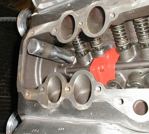

  10. Bruce Lancaster
    Joined: Oct 9, 2001
    Posts: 21,681
    Bruce Lancaster
    This is how Ford did the job in '48...
    A port just like the one you have* (though that one is likely pipe thread) was tapped for a normal bolt thread. It took a special bolt/fitting that went through a simple banjo fitting. It had a bolt head to clamp the banjo (with 2 copper washers) and was drilled endays to its own ****** connection and sideways where the banjo sat. Banjo fed the vac brake, other connection was free for other jobs.
    To make one...banjo sould be either '48 Ford part or a brake/fuel banjo from speedway. To make the bolt, drill a hole in a block of wood on a drill press, drop your bolt in and drill it endways concentrically. Drill out outer end slightly, drop in a short piece of brake tube, and solder. Drill bolt sideways for banjo, get some washers for brake work.
    It could be slightly improved by drilling a new hole at center rear or front of the carb platform
    *It is on back of rear carb platform in the photo

  12. Bruce Lancaster
    Joined: Oct 9, 2001
    Posts: 21,681
    Bruce Lancaster
    Here is a stolen blurry picture of a '48 Ford fitting. Banjo goes right below the hex. The extra bulge above the hex is just a felt-filled silencer meant to suppress the funny whooosh noises you get turning off vac wipers...

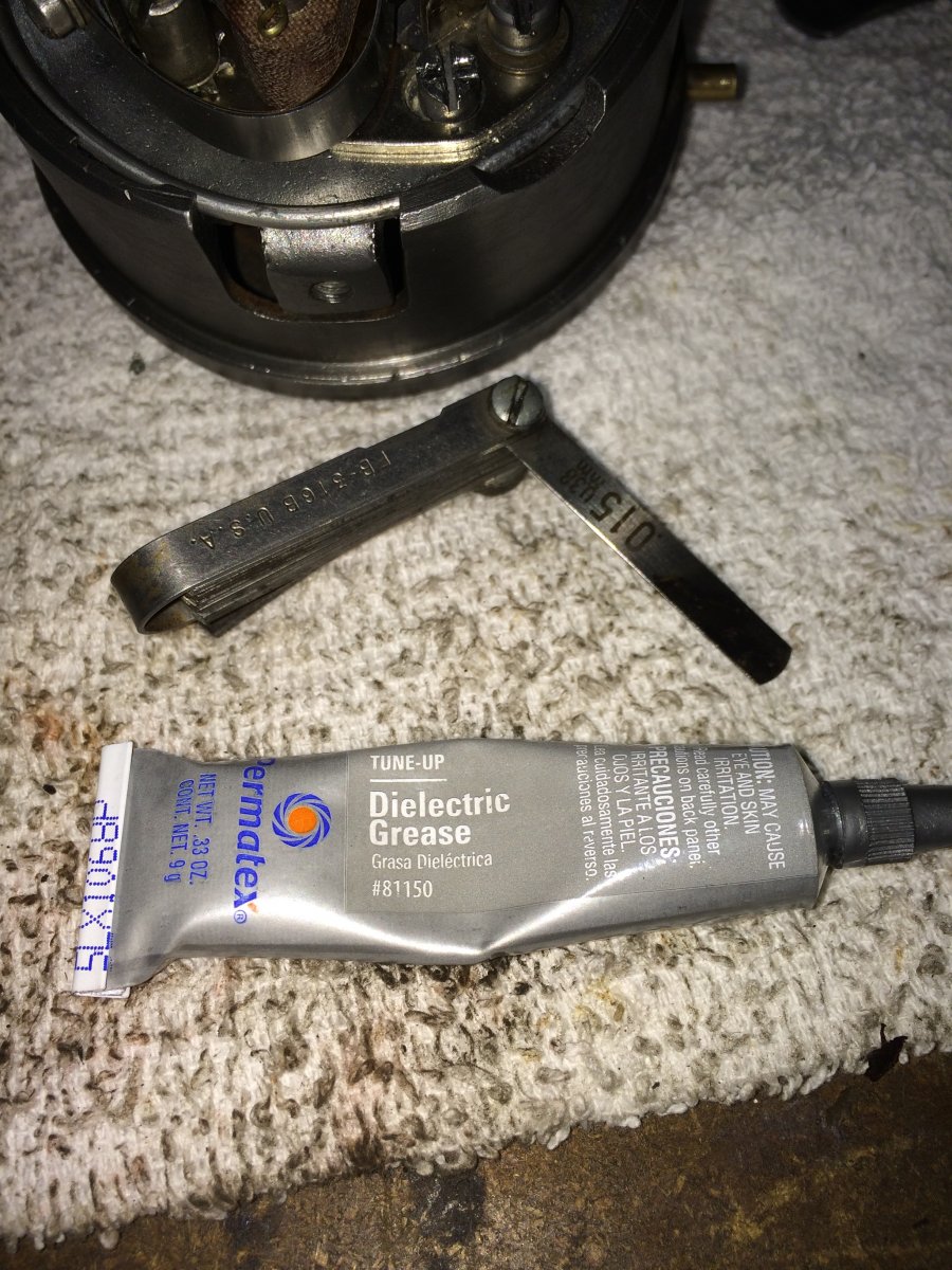

    Bruce or anyone...gonna finish up my dizzy in the morning, will set both points at .015. Any idea where I should set the advance using the graduated scale plate attached to the distributor...actually, any tips for setting this dizzy up would be helpful thanks Ron

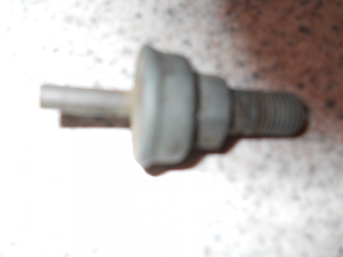

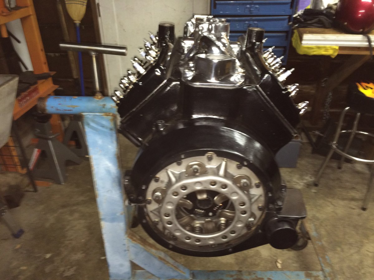

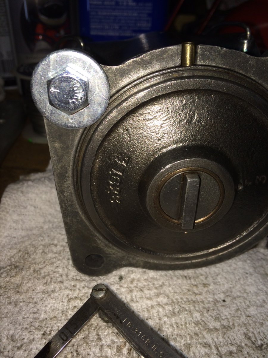

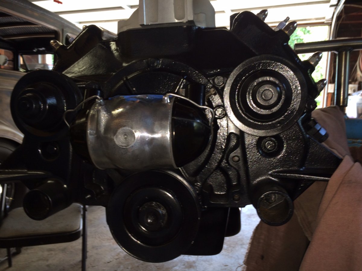

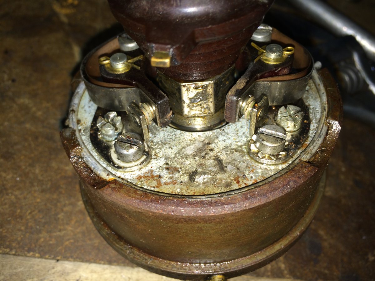

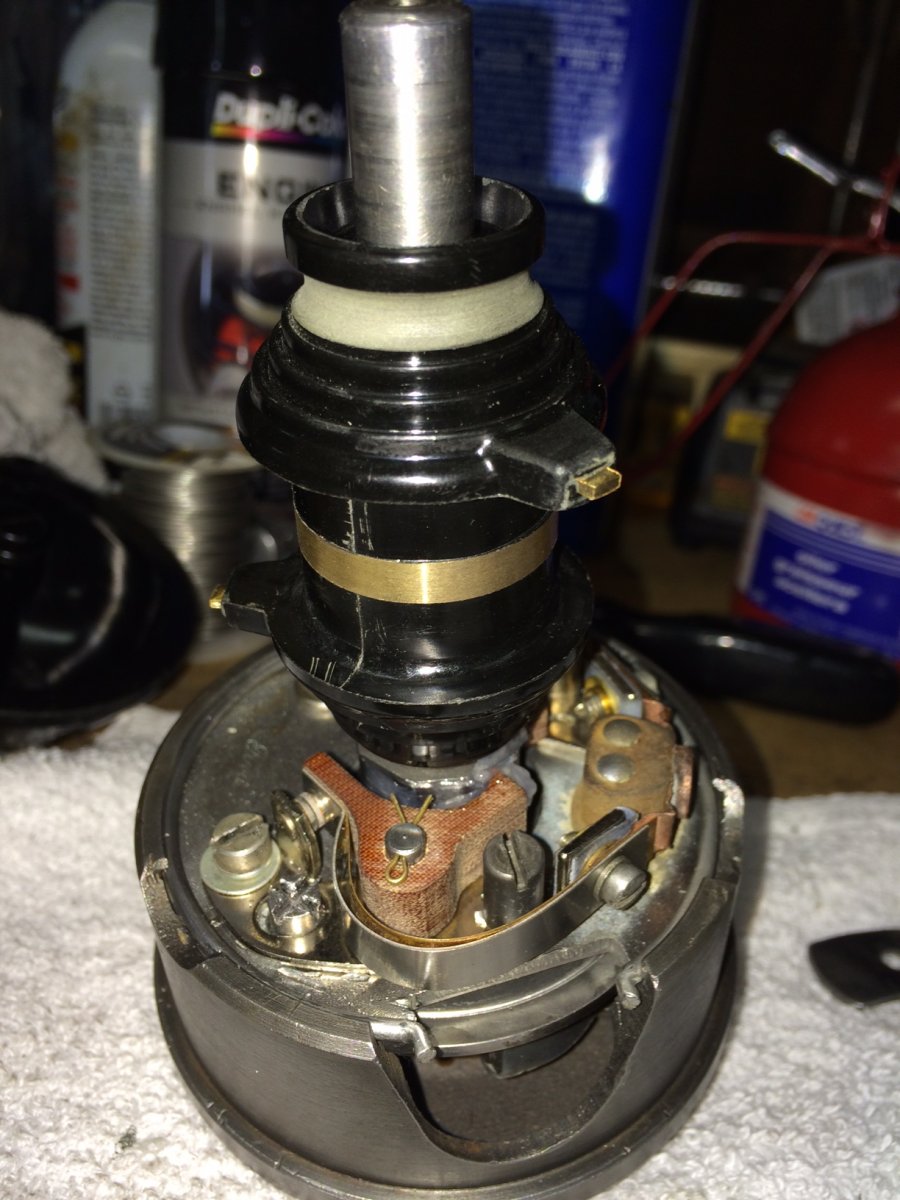

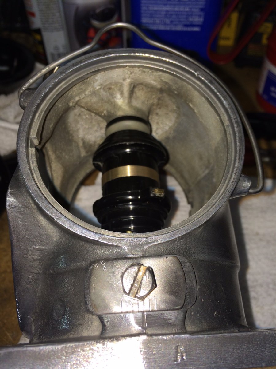

    image.jpeg image.jpeg image.jpeg image.jpeg image.jpeg image.jpeg image.jpeg image.jpeg image.jpeg Well here we go...my first time dinkin with one of these dizzies and for anyone interested, here is how it went.
    Pics 1 and 2. this cruddy *** thing is how it looked during teardown. Completely dis***embled down to the last screw and circlip and soaked overnite in Berrymans carb cleaner.
    Pic 3. this is after re***embly and cleaning...couple things, I found that putting a small flat washer under the points lock down screw made it easier to tighten after point adjustment. I also found if you dont install rotor during this stage the center shaft has too much slop up and down...installed rotor and slop goes away, so install rotor during point adjustment.
    Pic 4. to keep ***embly from coming out of dizzy housing I installed a nut, bolt and washer to keep it all in one place.
    Pic 5 and 6. make sure both shaft bushings are very clean and well lubed. I also found that these small ignition feeler gauges by Snap On easily fit into housing and made adjustment a snap. I adjusted both sets to .015 and lubed the cam and point contact pad. Use dielectric grease for this instead of axle grease or something. Dont want grease and sparks flyin all around like a wild woman ****s. Had to slightly bend the points at the point pad as I couldnt get the points to open up enough. It didnt take much so dont get western with them.
    Pic 7. adjusted timing to third notch from right just as advised by someone who probably actually knows what they are doing.
    Pic 8. found rotor tips were just clicking on cap ******s. I dressed the rotor down with a small file just enought to clear about .010 or .012. When installing new caps and covers, make sure you use a gasket, not only to keep dampness out but it makes your bail wires fit nice and snug as well.
    Pic 9. Tada.........now, if it will only start I wont have to come back and edit this post at a later date.
    Remember...this is my first shot at one of these. Im sure some of you REALLY old farts can find a bunch of stuff wrong, please let me know ( if you can still find your readin gl***es and get your great grandkids to post on a computer for ya). The way I see, worst case, it just wont start.

    Got a question for all you flatheads out there. My engine has the internal draft tube that vents at the front of the oil pan. The intake I have is ported for an external draft tube. Can I still run the external draft tube or a PVC off this port and still utilize the internal draft tube setup, both at the same time, or do I need to plug one or the other.
    1947knuck likes this.

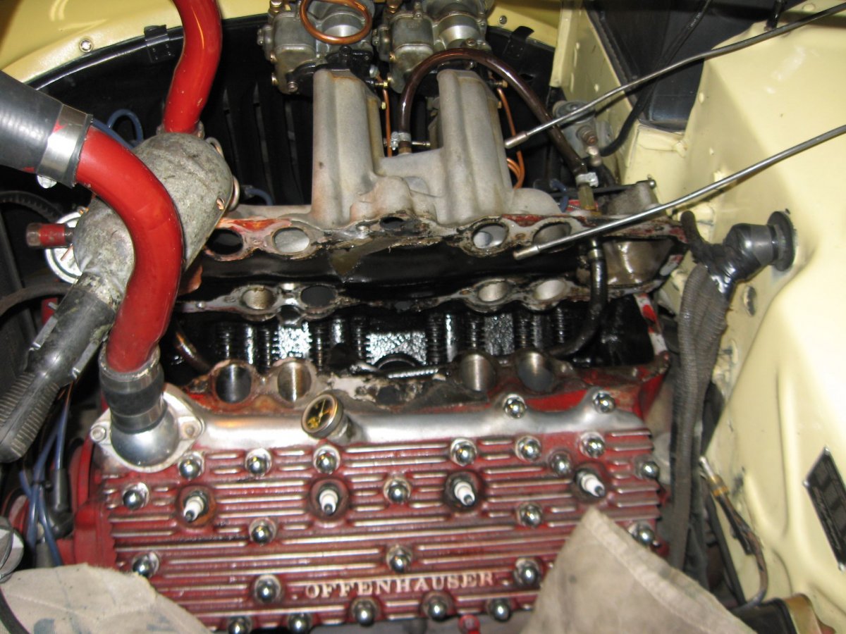

  26. Petejoe
    Joined: Nov 27, 2002
    Posts: 12,784
    Petejoe
    On my 8ba (49-53) in the coupe. I installed an 59ab Thickstun intake which forced me to find other means to ventilate the valley. This was 14 years ago and many miles. I understand you are trying to install an 8ba intake in your 21 bolt. Stay with me. I am going to show you the positive effects of running a PCV.
    This engine has the front internal tube exiting out of the valley. I installed a fuel line connection on this tube after welding the top of the tube shut. The fuel line ran in the valley and exited out a drilled hole on the intake after installing a fitting there and ran right into the intake near the Oil fill tube.
    Now a few years ago I was chasing an intake leak and removed my intake.
    I found my valley to be as clean as a pin in there.
    Now you can see how clean its running.
    No evidence of condensation. The engine probably has 30-35,000 miles on it.
    On the picture of the removed intake. You can actually see the pcv hose connections fairly easy.

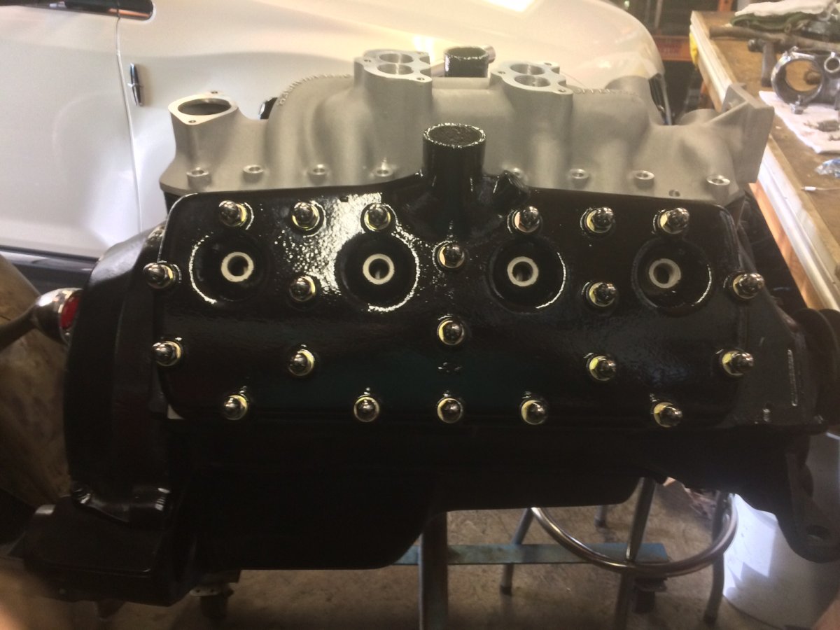

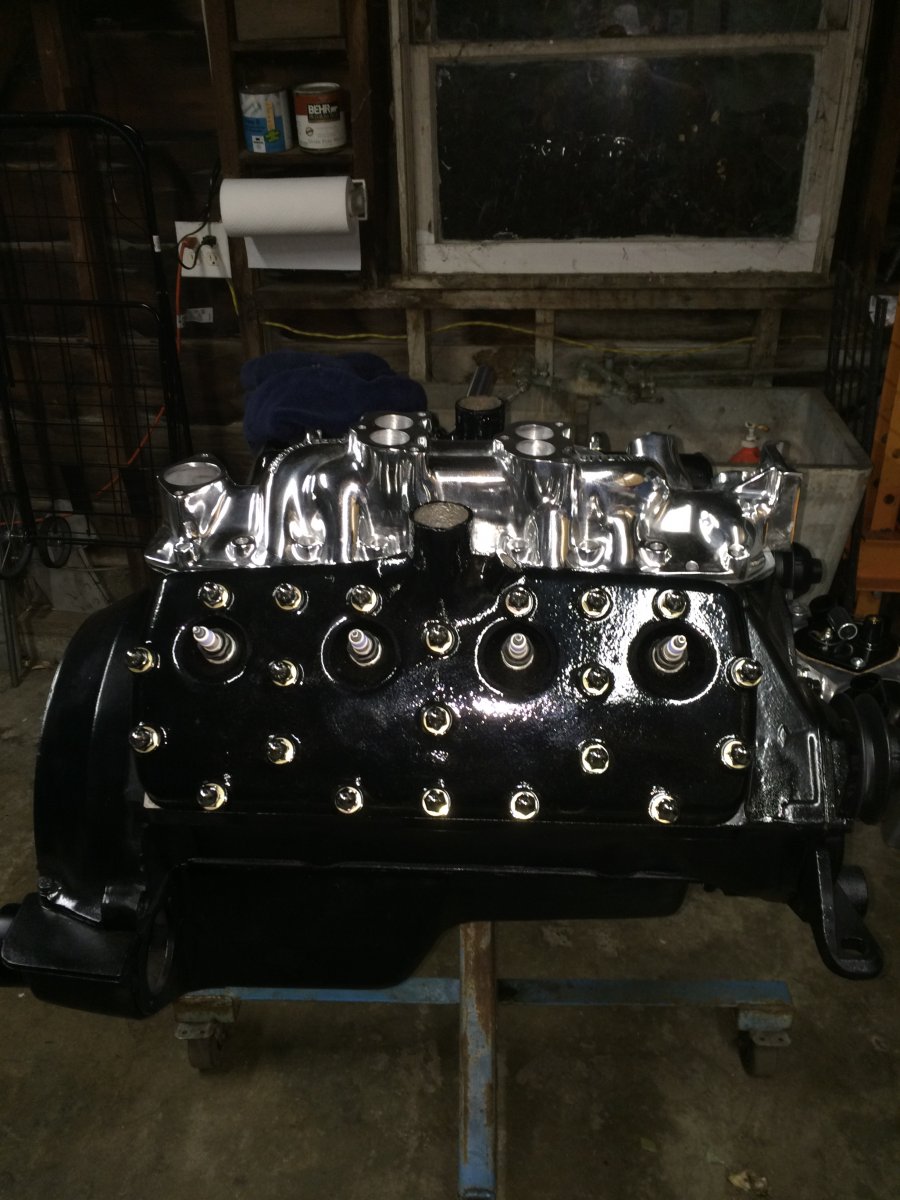

    image.jpeg image.jpeg image.jpeg Got my manifold back from polishing and will work on the whole crank vent PCV issue next, clutch is in and ready to pull off stand and into motor cradle so I can wed the ******. I may not be installing this set up in the sedan as I talked the little lady into letting me build a coupe so I will be picking up stuff toward this end, frame, banjo, radius rods and such as I can and will keep an eye out for a coupe or roadster body to build a fenderless hot rod on.
    On a side note my dad has a friend that puts on a show every year for drug and alcohol abuse recovery and wanted to be there, so he took my f100 and I took my Sedan and the Sedan took 1st and the f100 2nd place in the unfinished cl***. I almost never enter shows but it was a good cause and gave me a chance to spend some more time with my 81 year old dad....Good day and glad I did it.
    Again, thanks to all you on the HAMB for your input and help. Makes the hobby even more fun than it already i.
