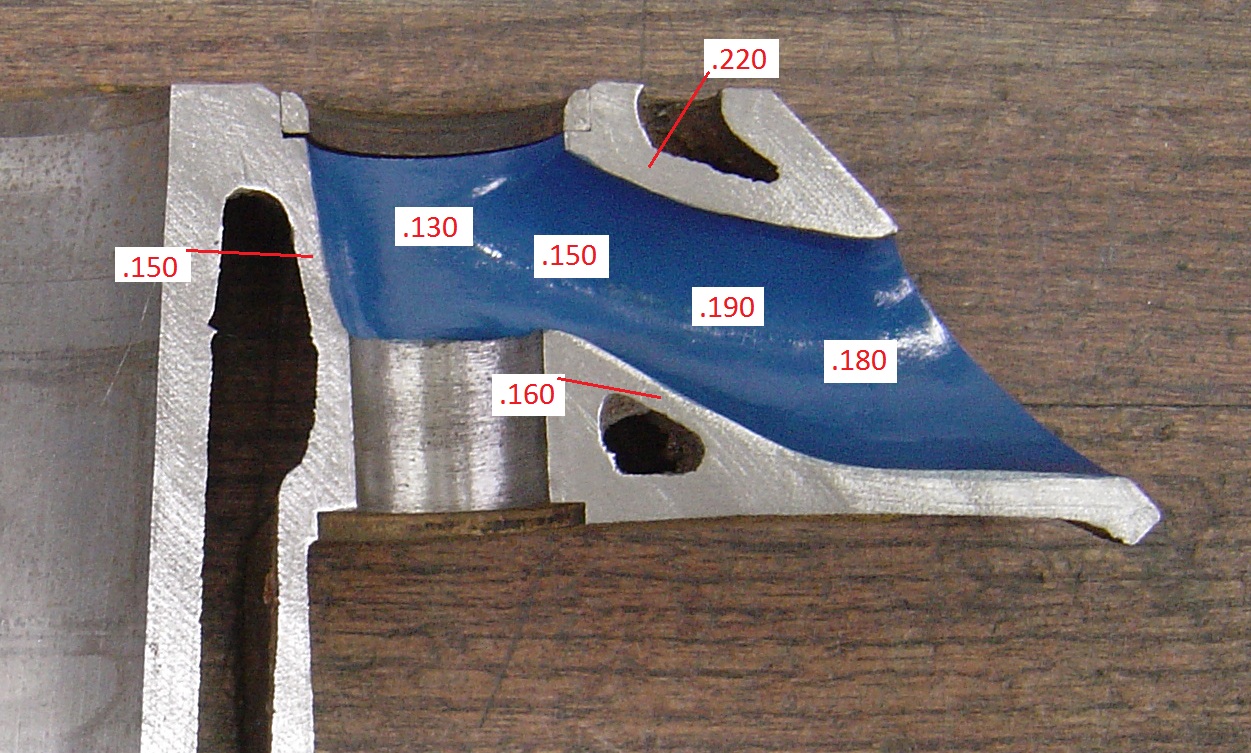

    Maybe others may be interested in this for port thickness testing or bore wall thickness checking. Its a modified digital outside caliper used in woodworking
    got mine from Rockler Woodworking Tools. $25
    Grant
