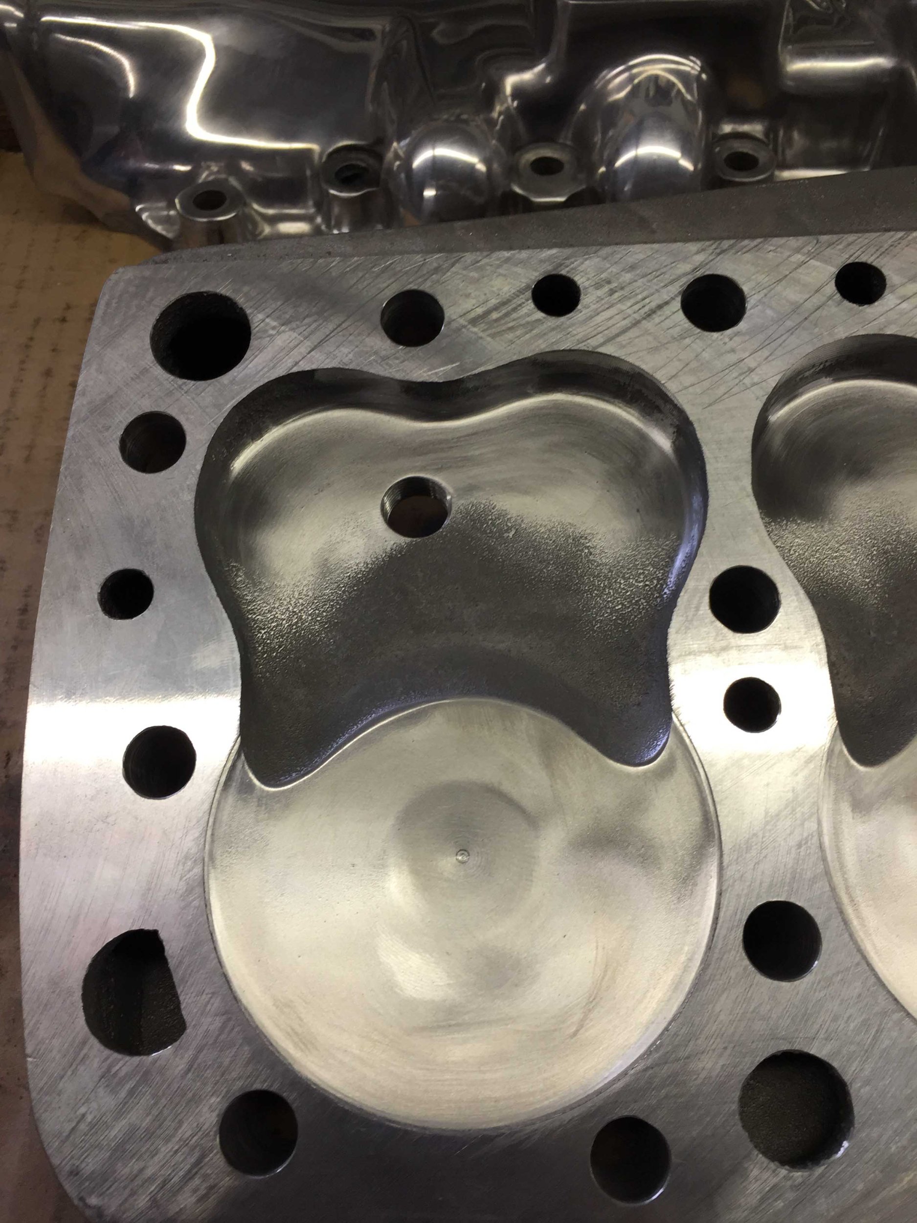

    Also for none blown applications Master Flat-Head genius Ken Kloth developed, with the help of his Flattie wind tunnel, a different combustion chamber shape.....
    Plus and amazing Port Divider for the center exhaust port
    :) Kenny Kloth Cylinder Head Shape.JPG

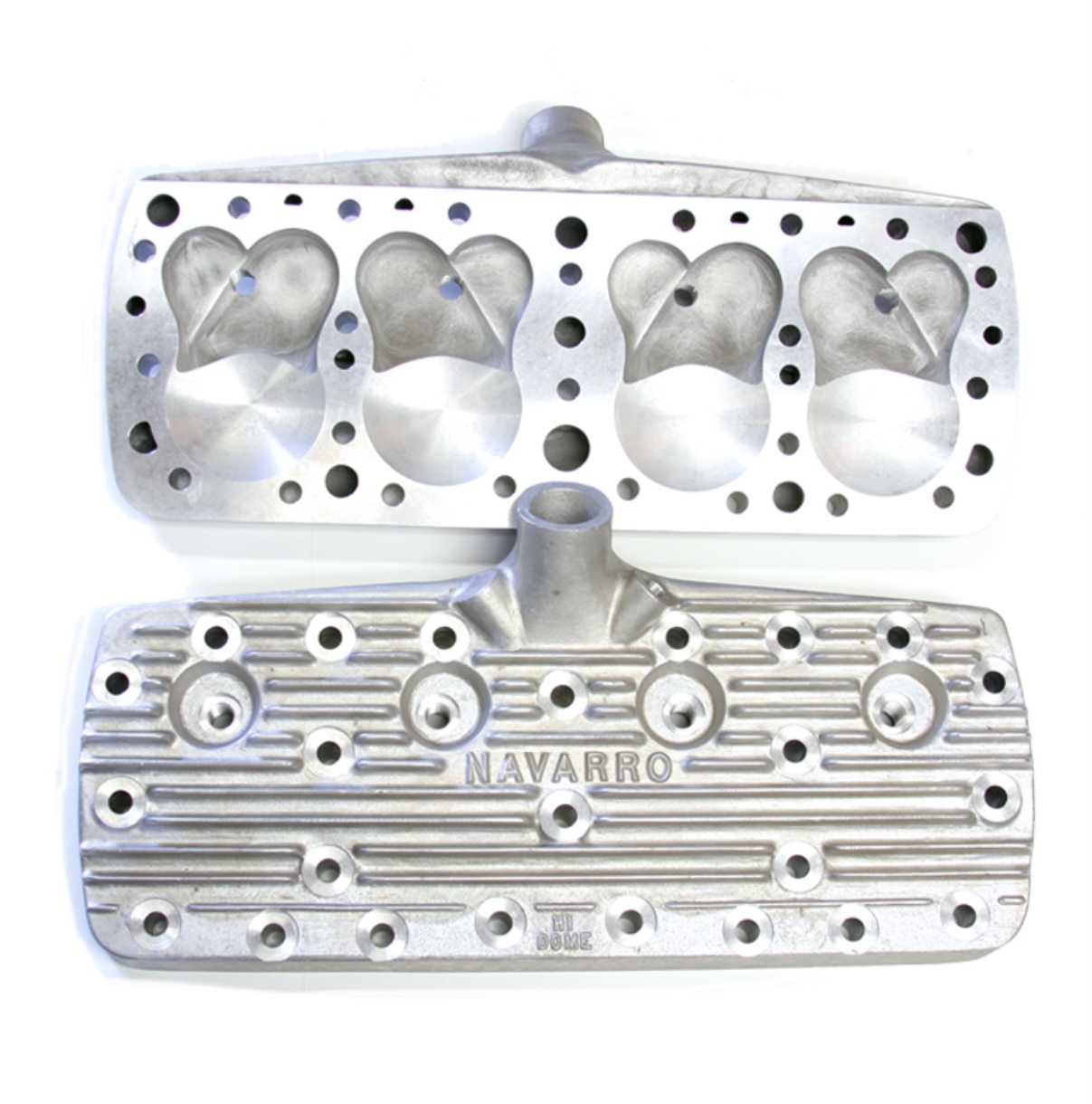

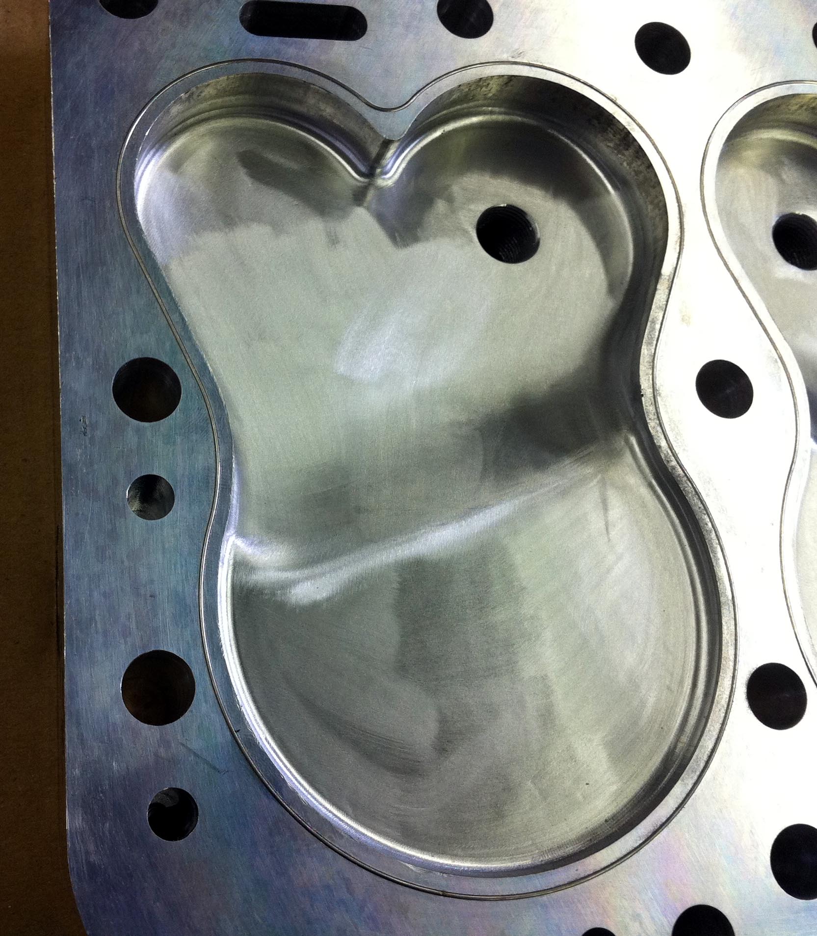

    My understanding is the 1st picture (not my shot) is the new Navarro head.
    The second picture is a version of the Harley KR head used by a Flathead racer more recently for a Flat-Head Cadillac :)
    New Repo Navaro Head.jpg KR Harley Style Chamber_HandPolished B'Vllle Caddy Flathead.JPG

    Yes! I have seen those before, I believe Bored & Stroked posted them.
    I believe the Navarro head posted is one of their standard heads. Here is the Hi Dome head, a lot more like the KR Also, notice the moved spark plug location.

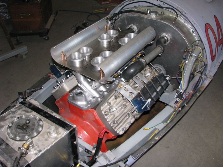

    That’s a nice intake. I was thinking along similar lines as the bottom section and adding mechanical fuel injection for bonneville.

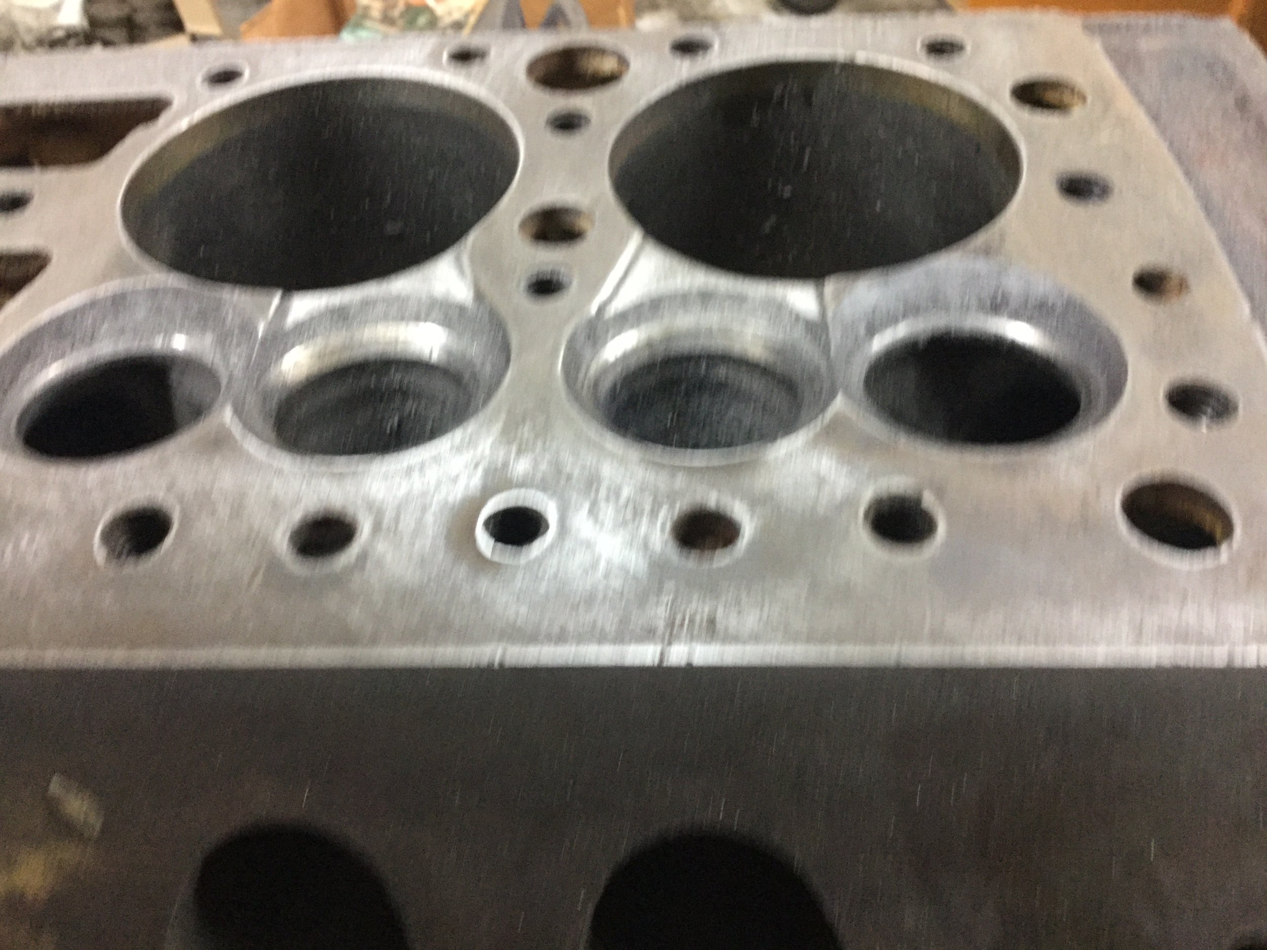

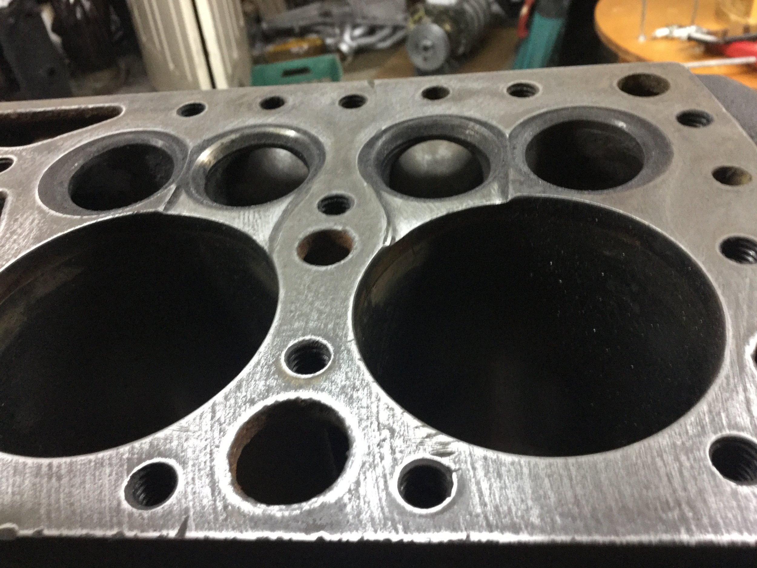

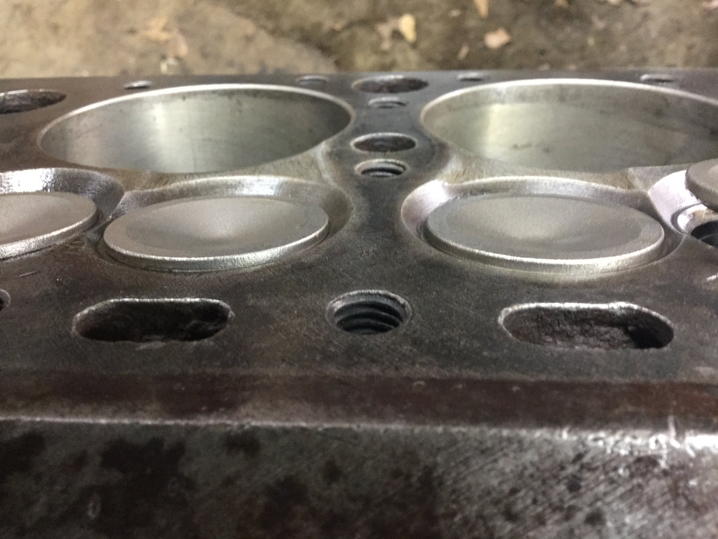

    Check out these Factory 1950 Ford Cylinder Heads. The engineers at Ford must have found something in this specific shape. Look at the offset Spark Plug location, a small "V". The combustion chambers are offset per valve locations. Still not a lot of Compression. They were just loaded with Carbon before I got them even this clean. Heads1.jpg heads 3.jpg 5t Head.jpg Heads1.jpg heads 3.jpg

    Interesting”V” feature. It would be interesting to see what tech they had back then to do any research on the combustion flame front process. Not that it would probably matter on a flat head, but a sharp feature like that would seem to be a place for pre-detonation to occur - no?

    I'm wondering if it was a relief for the cast iron machining operations ..... the centerline of any milling cutter is effectively stationary at all/any RPM and that feature is on the machining C/L.
    Just found these CI heads online with a similar C/L relief too.

    Went back snd pulled some pics of my heads that came off of a C69A I rebuilt. Has similar mark(s)/feature.

    These '50 Ford heads are 100% cast. No machining in the combustion chamber, other than spark plug treads.
    The "Swirlls" over the pistons are most likely from the "Mold", then these marks were transferred to the "Green-Sand" for casting. I don't think the little V is going to cause "per-detonation". The gas back then had lots of "Lead" (Tetraethyead {TEL}) in is back then.
