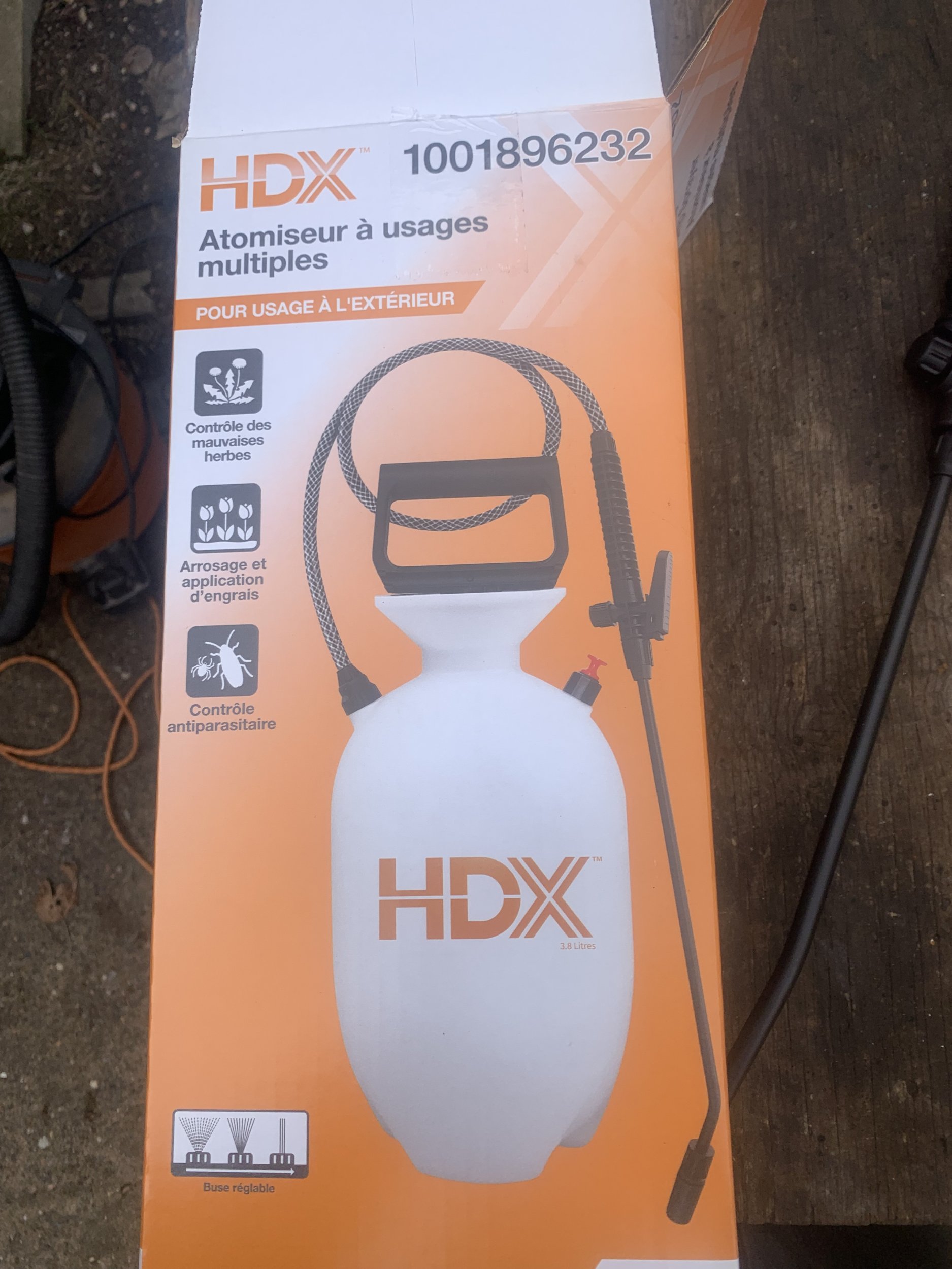

  16. fabricator john
    Joined: Mar 18, 2010
    Posts: 334
    fabricator john
    from venice fl.
    I did a full build on my flatty then pondered the same thing ,,saw a fella online somewhere do this and it worked for me , went to home depot , bought 20 buck pump up garden sprayer, whacked up the hose and screwed it onto the oil pressure fitting on the block , threw a couple quarts in it and pumped the **** out of it , then waited 20-50 took a few minutes to all get in there but it did the trick , had plenty of lucas ***embly lube on everything , and plenty of cam paste on the cam lifters and valve tips , VH-1 high zinc and a bottle of lucas break in lube , so my only real reason for priming was to fill the oil pump and get the air out of the galleys for the inital hit so oil pressure would come faster , and spun it on no plugs first before firing and made like 50 psi on the starter! , worked like a champ was uncomplicated and cheap !!

  17. Ziggster
    Joined: Aug 27, 2018
    Posts: 3,061
    Ziggster
    I think I’ll do just that. Thanks!

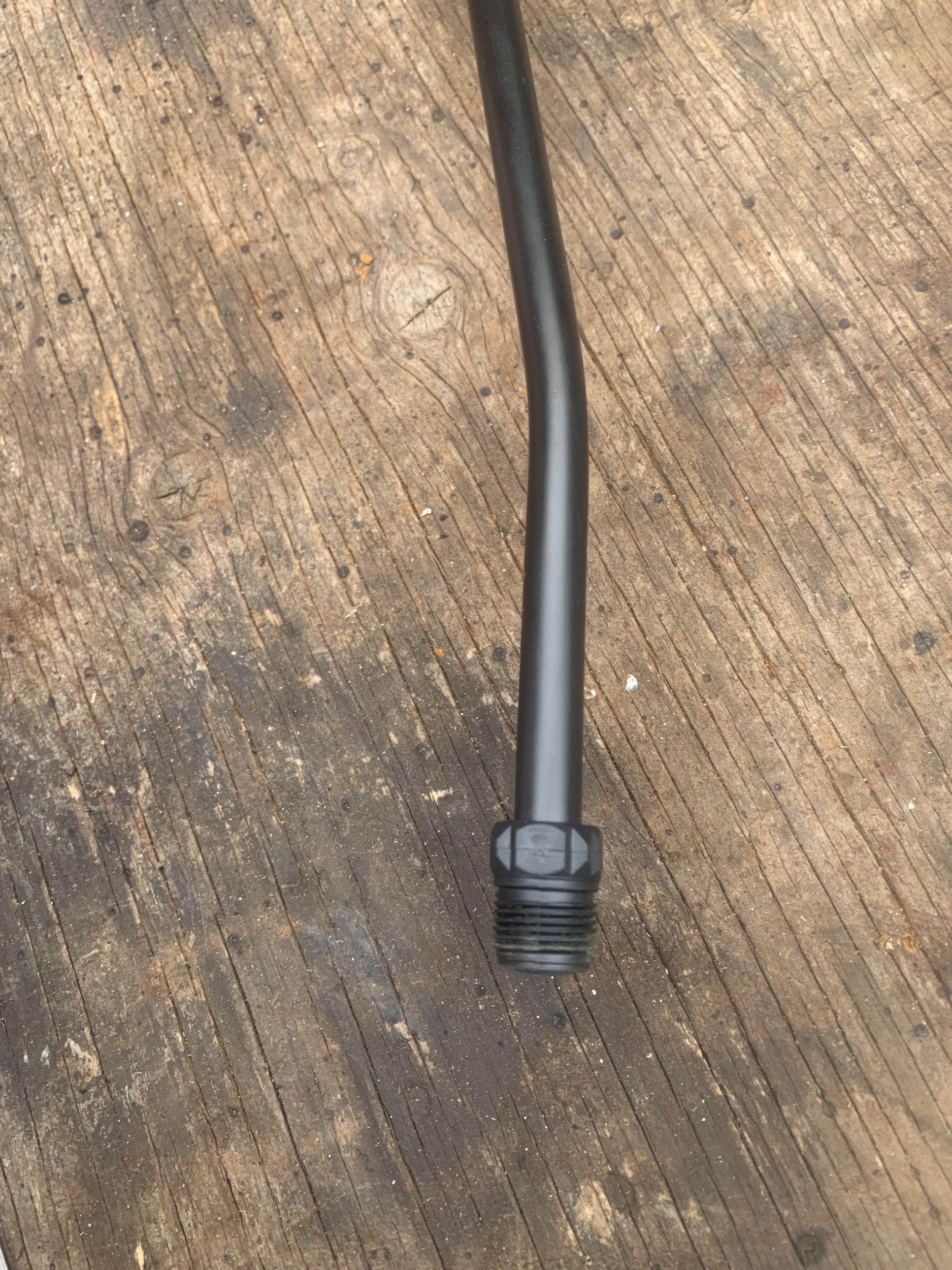

  18. Ziggster
    Posts: 3,061
    Ziggster
    So, picked this thing up yesterday for CAN$25 thinking easy peasy. Been to a couple places and cannot find the correct fitting to attach to the end of the wand. Really don’t want to cut the tube. Nothing I touch is just plug and play…

  20. V8 Bob
    Joined: Feb 6, 2007
    Posts: 3,168
    V8 Bob
    I cut the end off the wand and used a compression nut and feral. "Easy Peasy"! :)
    Ziggster likes this.

  22. Ziggster
    Posts: 3,061
    Ziggster
    Thought about that. Problem is the OD of the wand is like 0.412”. Not std.

  24. Ziggster
    Posts: 3,061
    Ziggster
    My Makita cordless drill died this morning, so back into town as today is the last day for a sales promotion at the local fastener place. Found a fitting (female nut) that fit the threads. Says it was for an airbrake system. Decided to get some br*** NPT fittings with a hose barb. Will cut tube if I use this setup and use the br*** ******.
    Will also look further into using the other setup with tank. I’m a little confused since IIRC someone stated that the Ford filter was not full-flow. Not exactly sure what that means. I always thought it was the internal factory oil p***ages that led it to being not a full-flow system.

  25. Ziggster
    Posts: 3,061
    Ziggster
    So, for $hit$ and giggles, I added about a quart of fresh Mobil 1 5W-30 syn to the HomeDepot sprayer. Was about 60F outside. Pumped it up to about as far as I dared thinking the handle would bend/twist if I continued. Seemed the pressure relief valve was far from popping. Removed the nozzle from the tip of the wand. Oil just squirted out about 3” - 4”. Could hold back the flow no problem with my index finger blocking the opening at the end of the wand. I have no experience priming a freshly built engine, but seems to me that this would have a hard time forcing oil throughout all the p***ages.
