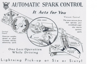

    The vacuum brake slows advance when accelerating. Vacuum keeps the piston away form the breaker plate. As vacuum drops when you open the throttle, a spring forces the vacuum brake piston to contact the plate and stop it from advancing. I don't think it is your problem.

    Vacuum brake works like this: My vote is on "fuel" not ignition....
