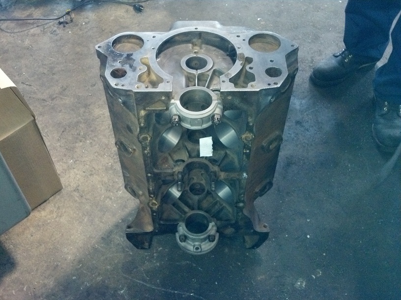

    Distributor, water pumps, oil pan removed, what a mess in side the block...sludge city!!! LOL!!! So far I can't see any cracks.

    And more, Almost ready to bring the block to the machine shop for claeaning and a mag test for cracks. If all OK then a pressure test...I desided that I will bring the block to Eastwoods Auto Machine...
  6. LSJUNIPER
    Joined: Aug 17, 2010
    Posts: 254
    LSJUNIPER
    from ct
    The block does not have any cracks in it and it p***ed the pressure test. Crank is good too....

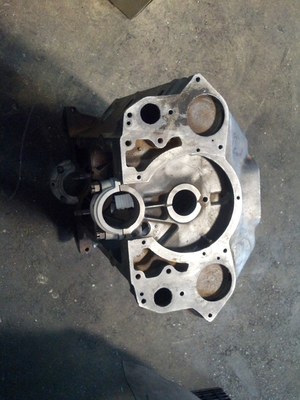

    made a bracket to hold the motor from the exhaust ports...

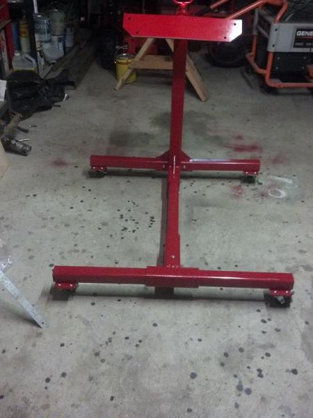

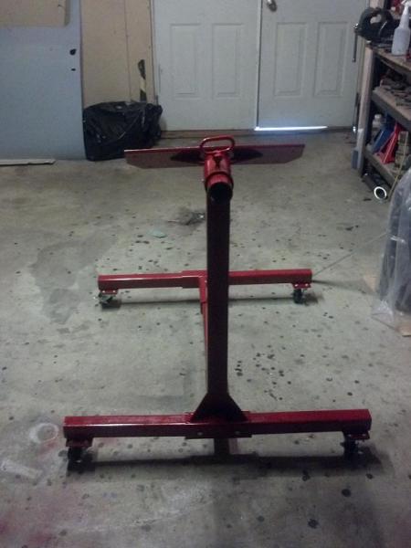

    This is the stand for the flathead block....

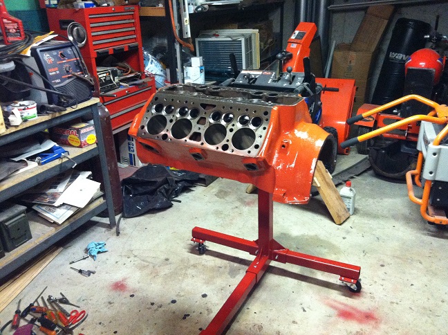

    Block is cleaned and painted.

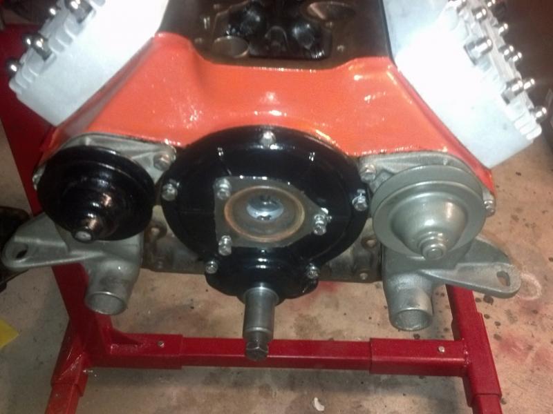

    Starting to re***emble the motor.

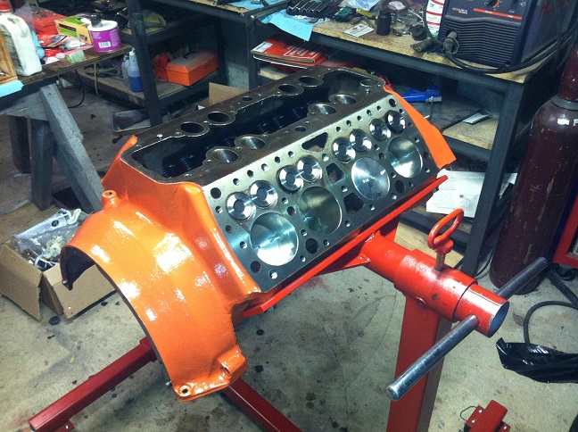

    Posts: 254
    LSJUNIPER
    from ct
    The pistons are now in!!!!!! Along with other parts too.........
    junkers72 likes this.

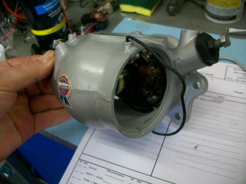

    This post is from Bubbas Hot Rod shop... This is who rebuilt the distributor for me.....
    Distributor update.
    When this project started i hoped that lsjuniper would use the factory helmet with the build. You just cant beat the helmet when set up and ready to go.
    The picture shows the before and after , we have a very mad and dead spider , we named him Henry..
    I have to replace the coil and hope to have a good used one to test tomorrow. The old coil had a shorted (open) primary coil and was junk....
    Anyway heres todays update......
