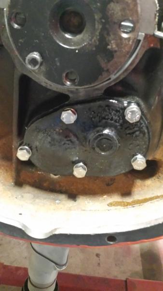

    Oil pump cover is on.

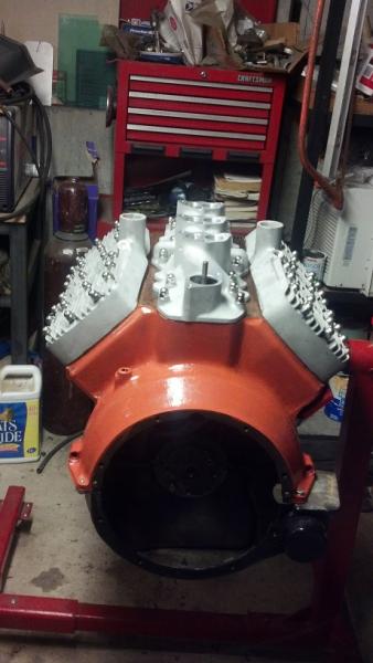

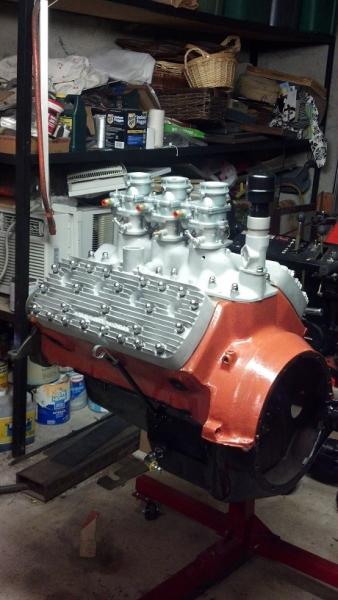

    Gotta ask, is your engine block painted red or hugger orange ?
    Looks good either way.
    LSJUNIPER likes this.

    GREAT job! I'm doing one, too... .040" over 59AB. That engine color grabbed me, too. For a minute there, I thought you might be that young non-conforming hero that was gonna drop it in a cool '55 Chevy tudor! No matter, though...

    Orange, purchased it at POR15.com

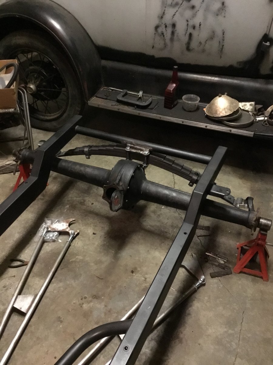

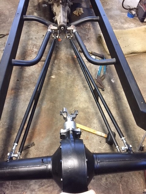

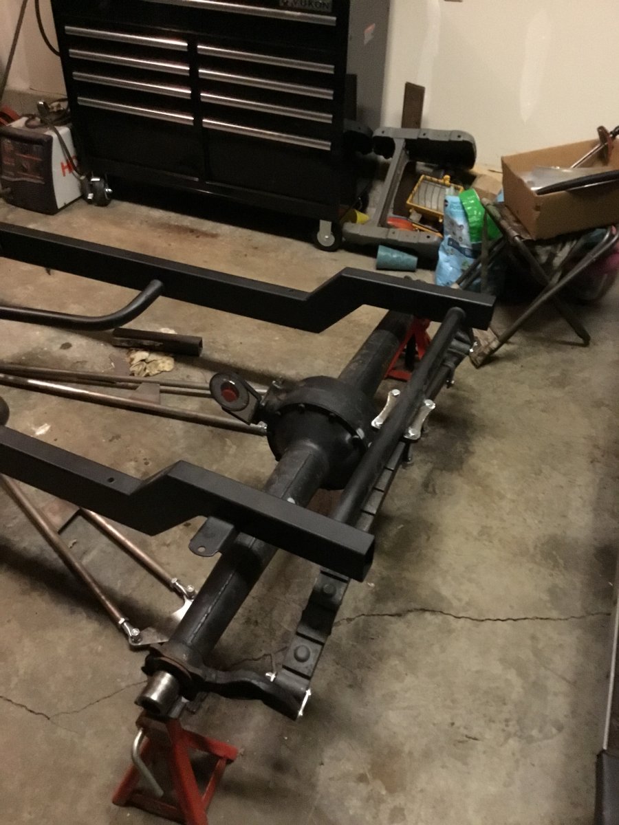

    Yes, The rear axle is almost all in except for the shocks. I hope to ****on that up this week. Here are some pics.

    Drill the lifter bores down low works best. Only takes about 30 minutes. Buy some very long drill bits. Cut the out side of the lifter bores down about 1/8" to get a wrench on the adjuster bolt. Only takes about 30 minutes with a die grinder. Now you have saved several hours of adusting time. PS; I even slimmed down the wrench to get in there.

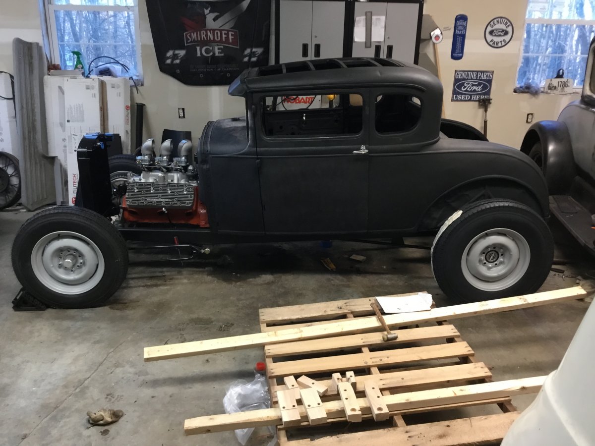

    Test fitting the body to the frame. 81737534-1651-42D6-882C-FA32B62F5E5E.jpeg

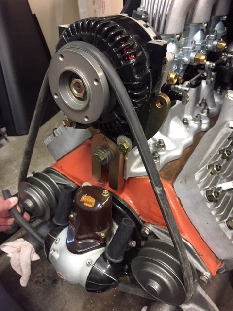

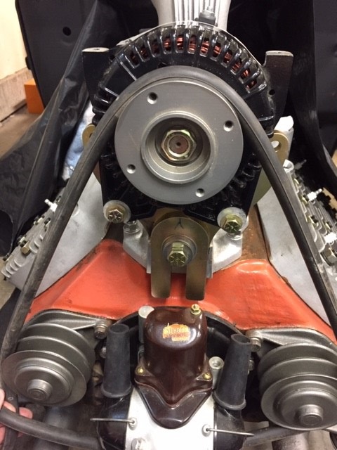

    Here is an update, been awhile. took awhile to figure this out. Went with the dual pulleys to align the alternator pulleys and have the 3 carb setup. 1.jpg 2.jpg
