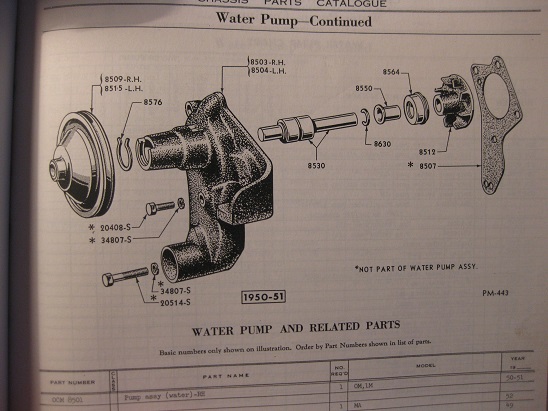

    I just pulled 49-51 Mercury pumps OFF the motor.
  7. 19Fordy
    Joined: May 17, 2003
    Posts: 8,372
    19Fordy
    F-ONE likes this.

    If you have the room, the Mercury Pumps will be the simplest route. You will need a spacer as the Mercury pumps mounting ear is a couple of inches higher than the Ford Pump.
