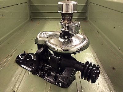

    Better picture of one out the car

    I hate to sound stupid, but I've never seen one of these! Is that round part hollow? Does the compressed air from the pump flow through it to the intake? My buddy took the pic that I posted so I didn't actually see it in person.

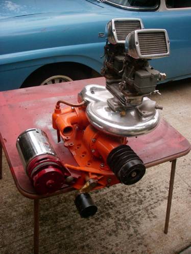

    39mc.jpg Its a centrifugal supercharger. Very similar to the Graham Supercharger that was stock on Graham cars pre war. The impeller, much like the compressor on a modern turbocharger, spins inside the round part. Air and gas enters from the carburetor, and is spun out and pressurized the same as in a turbo. It then flows into the intake manifold that it is mounted on and into the engine. Another picture.

    Thanks for the explanation! I'm guessing that these are pretty rare. I've been around cars most of my life and can't remember ever seeing one.

    Hi. That is one of the things that many of us dream about finding at a garage sale. Even better if it turns free by spinning the pulley.
    It is one of the things that would be hard to hide my excitement when I asked how much.
    I do not even own a flathead but I would scarf it up quicker than free ice cream as I know I would have some great trading for something to fit my Chevy Coupe with that. Or it would convince me I needed a flathead.

    One of the "supposed" drawbacks of the McCullough super charger is that the spiral bevel gear that is vertical within the case does NOT like violent acceleration; heard it was on the "spindly" side. Don't know if it is a true statement,just "heard" that over the years.
