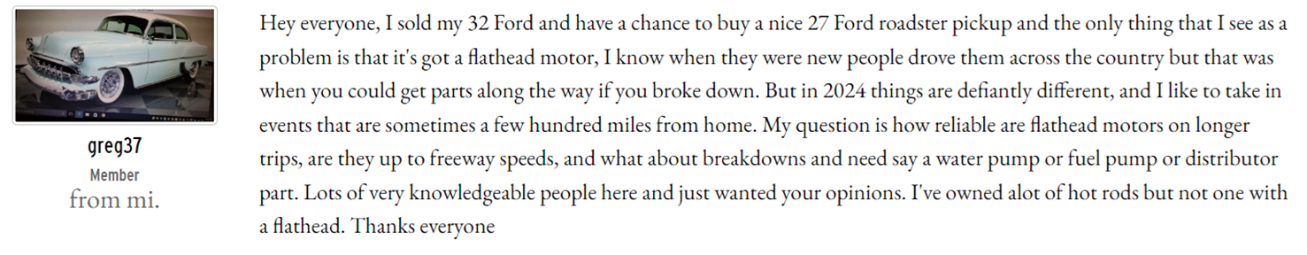

    Hey everyone, I sold my 32 Ford and have a chance to buy a nice 27 Ford roadster pickup and the only thing that I see as a problem is that it's got a flathead motor, I know when they were new people drove them across the country but that was when you could get parts along the way if you broke down. But in 2024 things are defiantly different, and I like to take in events that are sometimes a few hundred miles from home. My question is how reliable are flathead motors on longer trips, are they up to freeway speeds, and what about breakdowns and need say a water pump or fuel pump or distributor part. Lots of very knowledgeable people here and just wanted your opinions. I've owned alot of hot rods but not one with a flathead. Thanks everyone

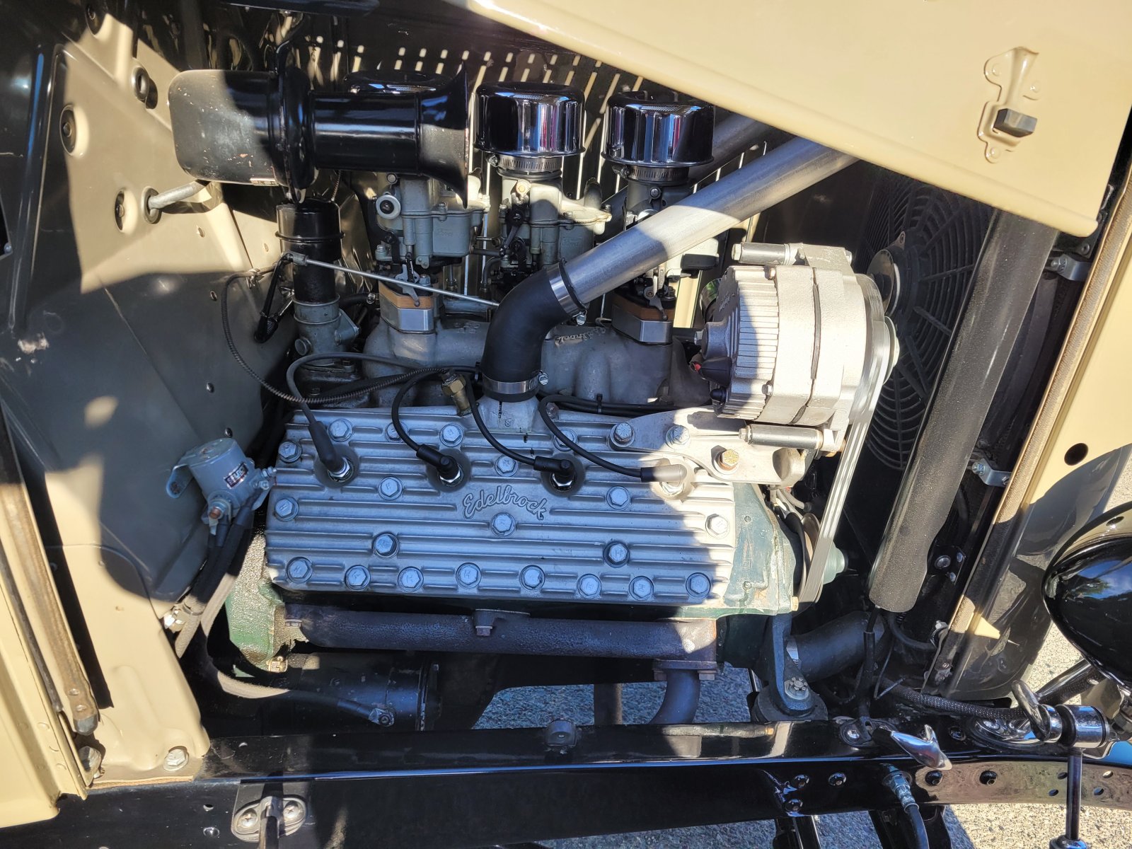

  19. 20240618_113327.jpg 20240616_073003.jpg This one joined us on a 4200 mile trip this June. Never skipped a beat. Included everything from sea level to 11,000 foot mountain p***es. Travelled at around 65mph with a Mitchell overdrive and 4:11 rear gears.
