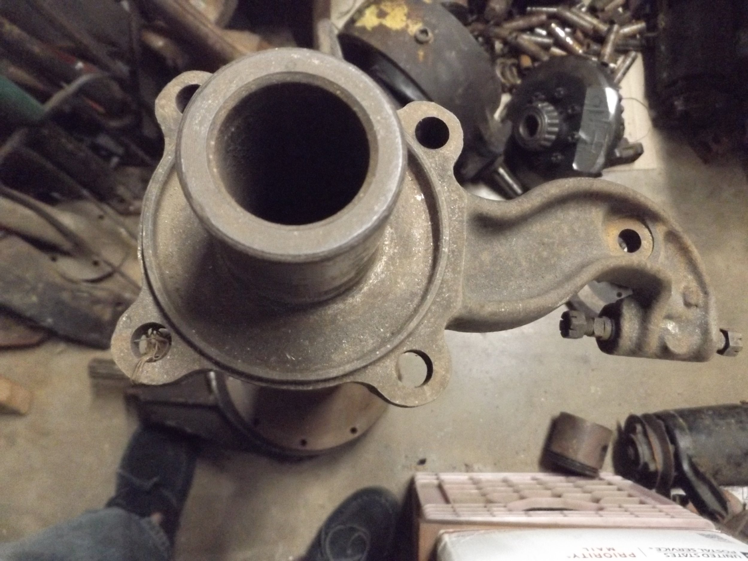

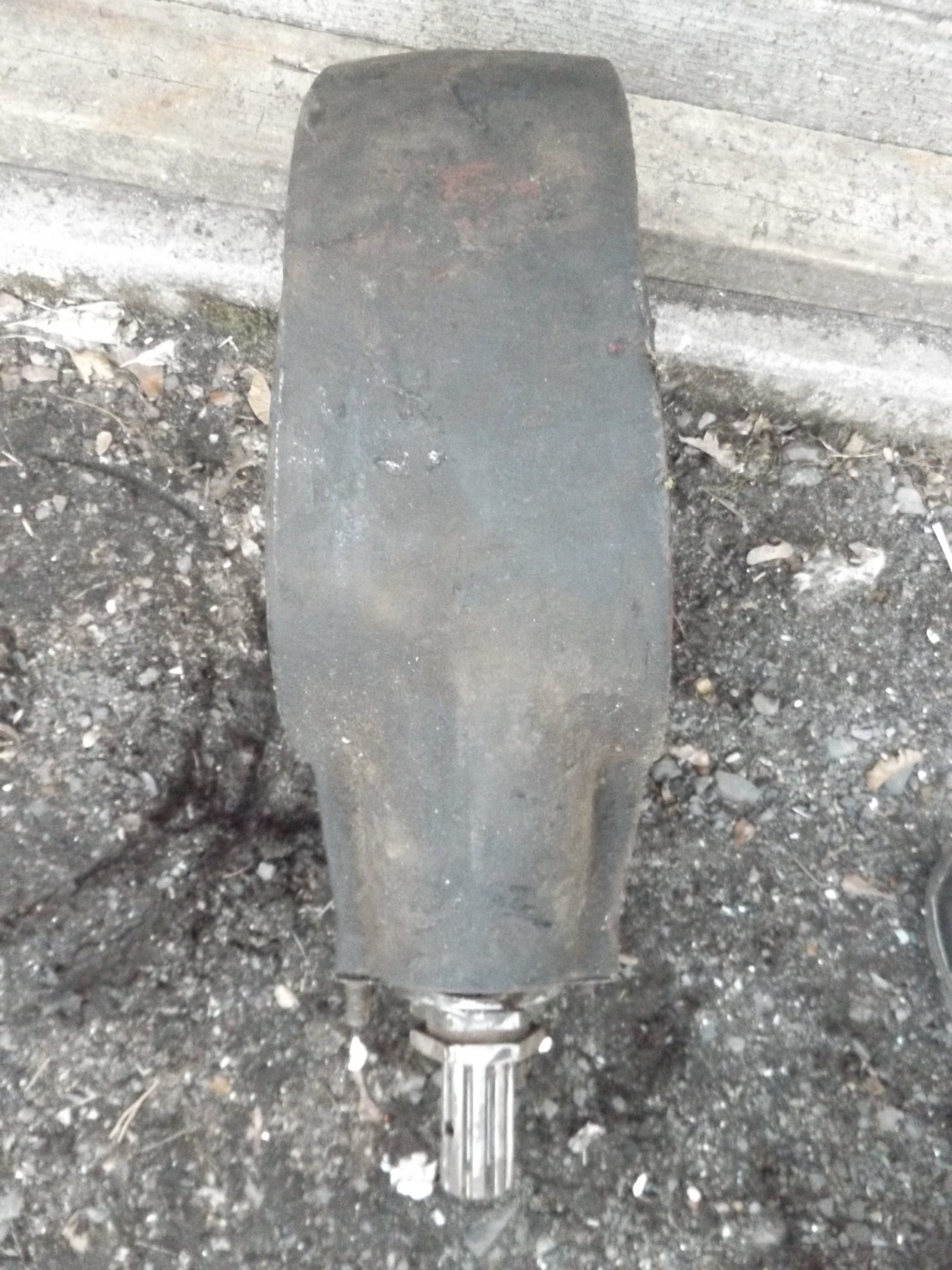

    Flathead V8 stuff is new to me, is this a truck item or late production car? Back tomorrow with a gear count, pinion is much larger than most.
  2. That is most likely a Lincoln center section.
    Carter likes this.

  4. Dave G in Gansevoort
    Joined: Mar 28, 2019
    Posts: 3,770
    from Upstate NY
    Is it my eyes, a trick of the angle of the photo or is that ring and pinion off center, i.e. hypoid?
  5. alchemy
    Joined: Sep 27, 2002
    Posts: 22,734
    alchemy
    Yes Lincoln. Extra bolt holes for sure, I never even attempted to see if the Ford housings bolted up.

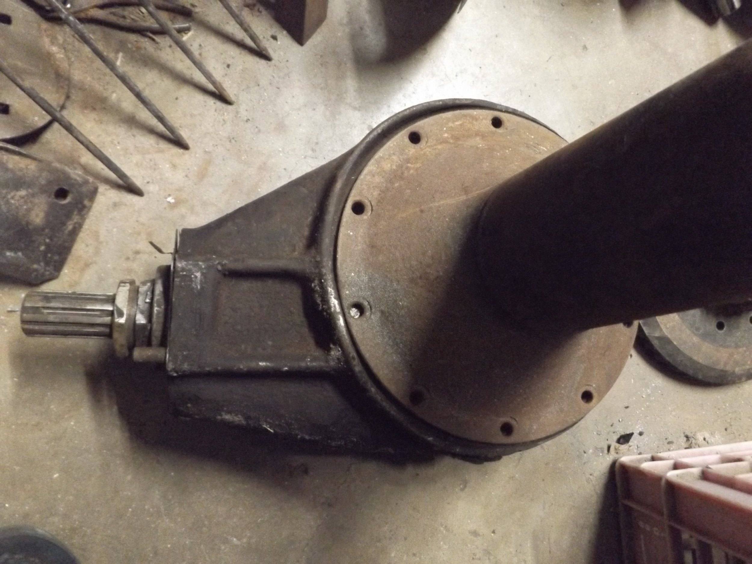

    Bolt holes all line up, you would have to drill and tap the one that isn't. Can you tell what year that trumpet is?
    Bob
  8. alchemy
    Posts: 22,734
    alchemy
    I think it’s a 46-47, but can’t guarantee from that angle.
    The37Kid likes this.
  9. banjorear
    Joined: Jul 30, 2004
    Posts: 4,825
    banjorear
    Length determines the years from '39-'48. What is the overall length of the bell?
