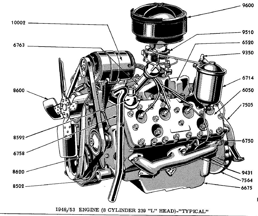

    What are my options for road draft tube replacement? I tried looking around and can't really find decent pics of what others are doing. The reason I ask, is I want to dress up my engine a bit with some wire looms and it's smack dab in the way. The engine is a 52 8BA.

    It's on the front of the engine, isn't it? How is that in the way? Maybe trucks are different?

    I take the "road draft tube" out and replace it with a PCV valve. I use the PCV grommet that fits in the back of any fuel injected 5.0 Ford. If you go to a Ford dealer tell him the basic # is 6A631. It is a sleeve type grommet just a tad small for the road draft tube opening in the manifold. Simply use some good RTV and glue it in place. Let it cure and put the PCV valve of you choice into it. I have used the PCV valve for the 5.0 Ford a few times but on one engine it proved to be a bit much so I went to 3.8 V6 PCV valve. Worked fine.

    I converted to PCV using HELP! grommet #42052, or use Dorman #493-212 for GM engines from '68 - '95. I had to put a thin shim around the HELP piece to make it tight, and used some RTV on it to be sure. Then use a Fram # FV294 PCV valve, I believe it's for a 3.8 Buick. I got an AN fitting to connect to the manifold, a piece of hose, and it was done. No issues whatsoever.
