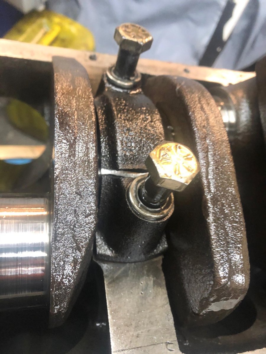

  7. soonrodder
    Joined: Jan 22, 2011
    Posts: 107
    soonrodder
    from germany
    Hi you all,
    I pulled the engine, what was a pain in the ass.
    But I did it.
    Looking to the oil pump, I can not find an issue.
    Also bearings seem not too bad, but have not opened them till now.
    I will forward the engine to Cheater Pete, a friend of mine, who is a great flathead guy.
    He will check everything in detail an will make it bullet proof.
    I will let you know what the problem was. as soon as I know it.
    Thanks a again for all your support.

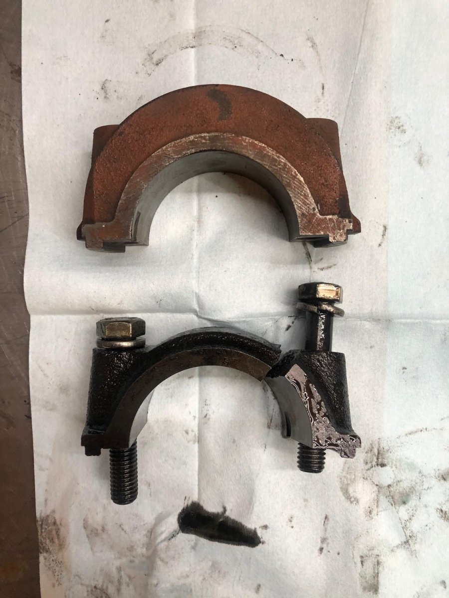

  11. soonrodder
    Posts: 107
    soonrodder
    from germany
    Hi all,
    Here is what we found!
    The answer to the question.
    Broken Main Bearing!!
    So this is why the pressure decrease in high gear - the crankshaft moves beside than...
    And without gear and heavy load there was still pressure..
    Thank you for all help and opinions!
    Crankshaft is ok and healthy!

  13. Wow....well done :eek: Glad you found the problem before it got worse !
  14. triumph 1
    Joined: Feb 9, 2011
    Posts: 601
    triumph 1
    Holy $hit! Good thing you took it apart before it grenaded

  16. harpo1313
    Joined: Jan 4, 2008
    Posts: 2,589
    harpo1313
    from wareham,ma
    That could of been nasty. glad you took the right route.

  18. Blues4U
    Joined: Oct 1, 2015
    Posts: 7,963
    Blues4U
    from So Cal
    Didn't see your video from the a week or so ago, just saw the thread again today. Wow, that bearing cap! Well, that goes along with our guess about what was happening, doesn't it? When placed under a load the cap would allow increased clearance at the bearing, allowing oil to escape, and pressure to fall. This is a good one! Thanks for coming back and showing us what you found.

  20. redoxide
    Joined: Jul 7, 2002
    Posts: 771
    redoxide
    Question now is, what caused the cap to crack ? defective part, ( bad casting) previous poor assembly, ? serious detonation or wierd load stress loading it up from slower speeds in OD ? Will you be line boring the mains since your fitting a replacement cap ?
    A buddy on mine suffered a catastrophic crank failure on his French flathead, the crank broke at the mains journal, slow speed in O/D ( columbia) .. These engines will pull from walking pace in top 1:1 but the stress to pull from 10mph to running speed while in OD must load them up pretty bad .. Its just a theory / question ive pondered . I have no technical experience of loads and stresses..

  21. wulf powis
    Joined: Jun 19, 2017
    Posts: 64
    wulf powis
    wow thats great you found out the issue, let us know if the crank can be saved, or if has been reground too much already/ just curious if the movement did more damage to the caps and crank.
  22. joel
    Joined: Oct 10, 2009
    Posts: 2,671
    joel
    Now I see why people add supports to the center main cap. Good luck on the repair. If the crank is still true, main and rod bearings and an align bore and hone should get it done. Here's hoping.
  23. soonrodder
    Posts: 107
    soonrodder
    from germany
    Hi all,
    I am back with more info.
    Please see the picture.
    We found a matching bearing cap from a french flathead, which makes it much stronger! f30afff7-4ace-4ab2-8e7a-2645b83c02b8.jpg
    Bearings and Crank were ok.
    I will take the engine back on its place soon..
    ottoman, waxhead and Blues4U like this.

    Budget36
    Something different about FHs that don’t need to be align bored with different caps?
  25. sdluck
    Joined: Sep 19, 2006
    Posts: 3,332
    sdluck
    I wondered that too.
  26. Kiwi 4d
    Joined: Sep 16, 2006
    Posts: 3,790
    Kiwi 4d
    Well that’s A Lead foot Louie break right there, never would have suspected that one, great diagnosis @soonrodder
    Not being a machinist but I would have thought when you swap main caps from something else It was essential to align bore all the main caps . Well I for one would , to be sure of no bind. French cap looks great.
    waxhead likes this.
  27. joel
    Posts: 2,671
    joel
    I suppose you could check cap alignment and bore diameter with a dial bore gage and then have the block "touched up"
    with an align hone. I had a block squared once and the first thing he did was to check the mains by just touching the block with a hone. In your situation, I'd have it align bored and honed. JMHO
    waxhead likes this.
