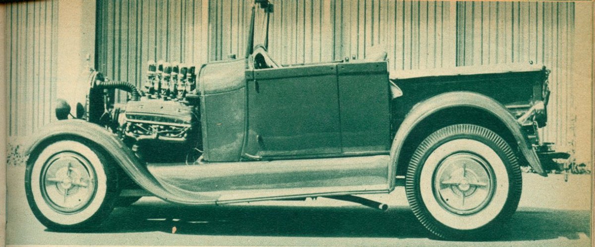

  21. Stovebolt
    Joined: May 2, 2001
    Posts: 3,669
    Stovebolt
    Here's the car built by David dias.
    This car still exists and was "restored" at Brizio's shop a few years ago

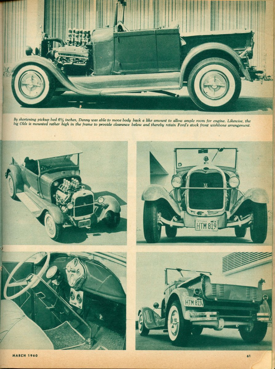

    Danny Hildebrand also built a model a rpu with the body set back.
    And how it sits today:
    This is the jimmy powered A roadster also mentioned.
