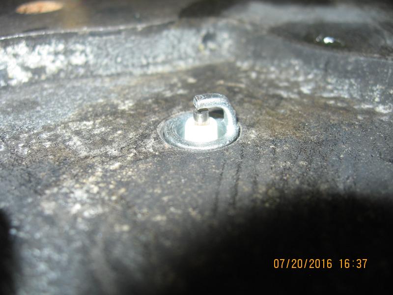

    Here's what the body of the plug should look like when screwed into the head. (This not a perfect example, since these are Edmunds heads. On Edmunds heads, the spark plug location has been moved enough so it is not directly over the exhaust valve; this allows the use of extended tip plugs.) These are L82YC. In Champion nomenclature, "L" means 1/2" reach (full 1/8" more than stock) and the "Y" means "extended tip", which you can run with Edmunds heads. The important thing is that the bottom of the plug body is flush with the combustion chamber in the head.

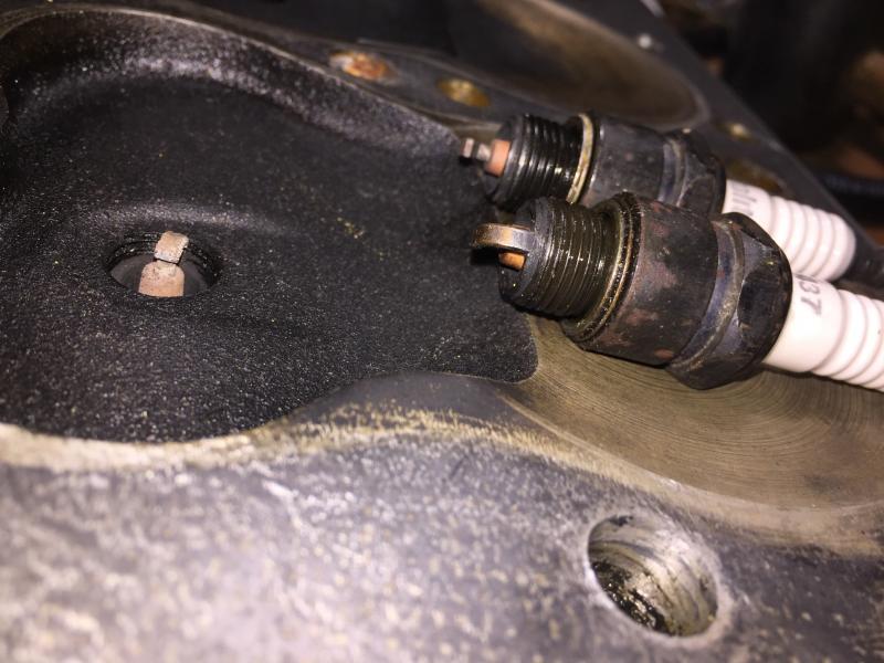

    BTW, here is a picture of a stock (3/8" reach) plug in an Offenhauser head. Sure, the engine will run, but that doesn't look optimum to me. How about the color of the deposits in the transfer area; sumpin' ain't right,
