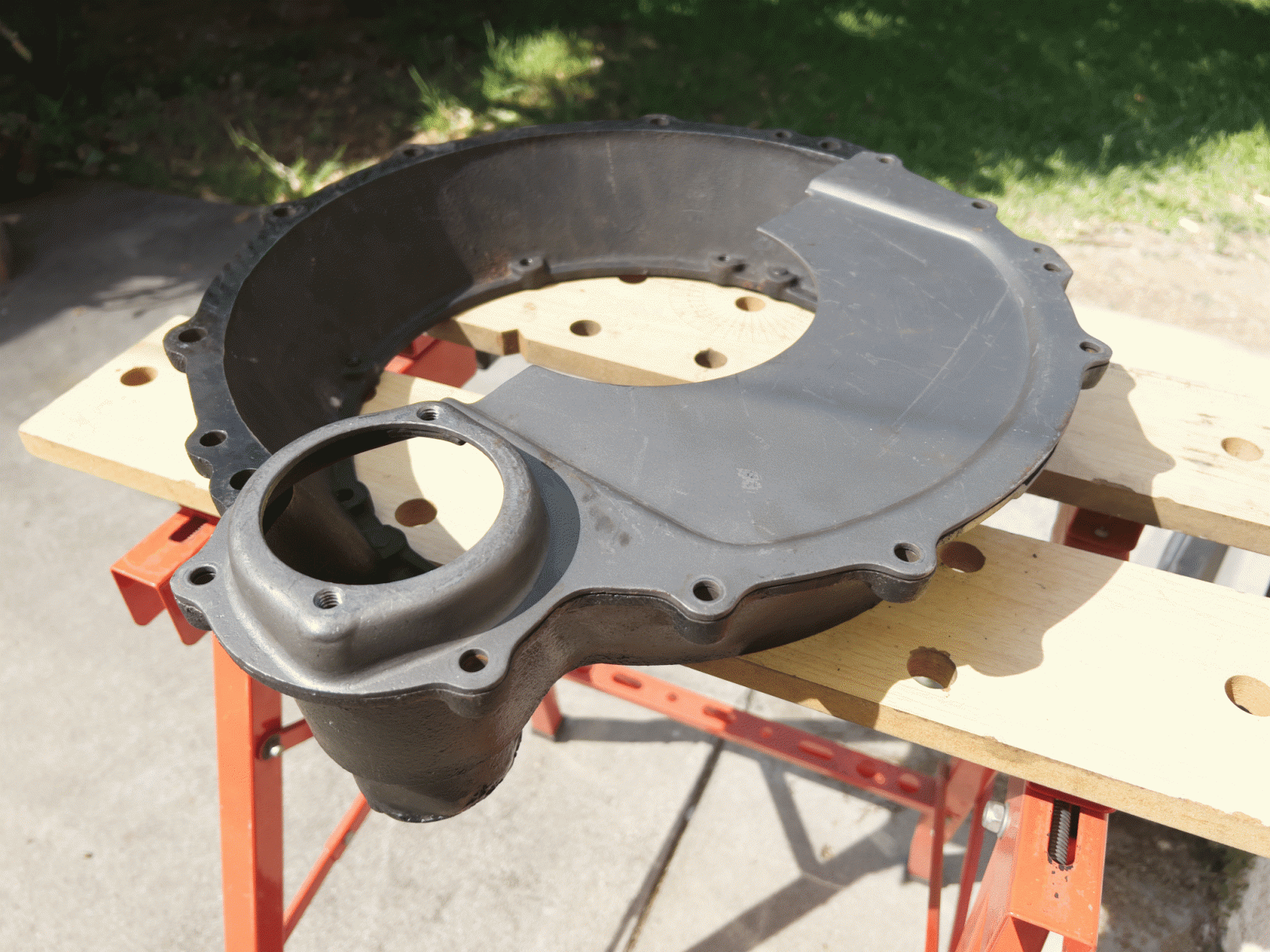

    Are you using a cast aluminum 8RT truck bellhousing or stamped steel? The 8RT bellhousing is for an 11 in. clutch.

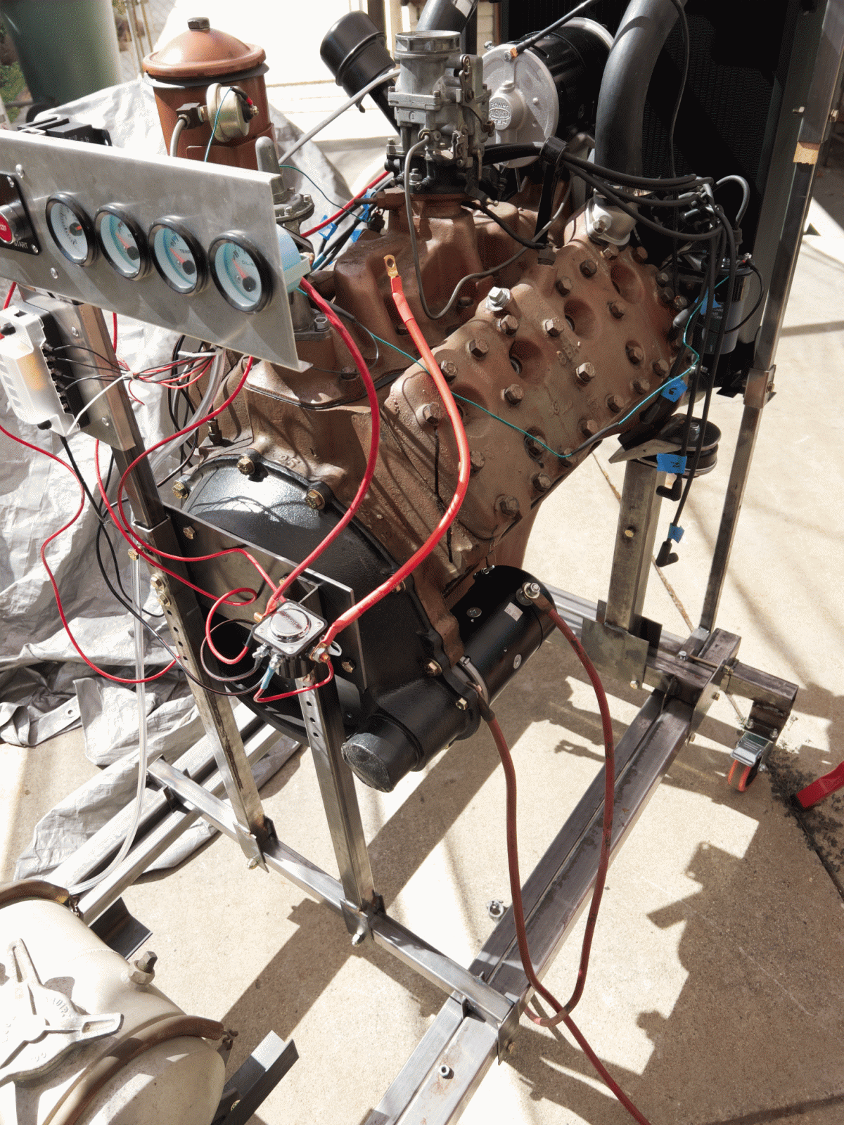

    Are you working on the engine bolted to an engine stand using the bellhousing bolts?
    If so, you will not be able to mount your bellhousing and starter plate to the engine block.
    If possible, please post photos showing your entire engine with the bellhousing and starter plate attached to it along with the starter you are using. This will permit us to see "the big picture".
    Perhaps I am missing something but, in your photos I cannot see the edges of both the starter plate and the stamped steel bellhousing where they bolt together on the engine. You will see what I mean in the photos below.
    You must be able to FIRST install your bellhousing (with the starter plate already attached) to the engine block. Both your bellhousing and starter plate must be ***embled on your engine in order for the starter to fit.
    Then the starter will fit correctly. Below are many photos I just took of my 50 Merc bellhousing with starter plate ***embled on my 8BA. In 1951 Mercury changed their starter plate design during the year. The Van Pelt site shows the 2 different types of Merc starter plates used in 1951. Which one are you using? The one on the left is the one you need.

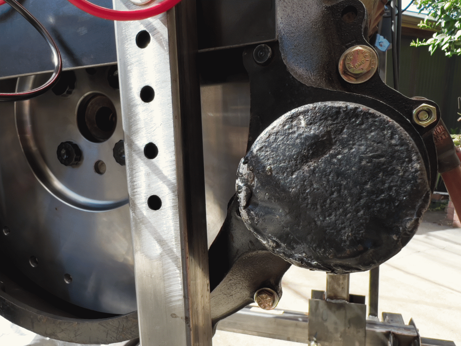

    Gave it one more go today this time with real battery cables and not jumpers. Starter motor engaged and clicked like before but still no turnover. Before someone asks yes there are two red cables and the one on the starter was hooked positive and the one on the bell housing bolt mount was ran to the negative terminal.
    Unless anyone can see something obvious in the following photos regarding the mounting of the starter motor, bell housing, etc. I guess my next move is to try another starter motor.

    Can you pop the can off of the backside of the bell housing so you can see the ring gear and starter engage? The one on my Flathead was already missing So maybe it's easy enough to pop it off.

    I use the same starter on my 8BA flathead. I did have a little issue with it originally. I used an aluminum starter plate from Flathead Jack. That plate bounced around due to the torque of that little starter so it would not remain engaged in the flywheel.
    Here is the starter with a heat shield on it and it is clocked so the cabling is away from my headers.
    To cure the issues I removed the cone from the back of the bell. Sounds easier than done, I wanted to save it and reinstall but I utterly destroyed it taking it off. I still run it without the cone but I really should make something and shove it in there.
    However, it did give me access to view the engagement of the starter and flywheel so I could shim and align the starter.

    The starter plate and bell housing on the left is the one you need. Notice that in 1951 Mercury changed its design during the model year 1951. That's shown on the right.
    The rare #6411 rubber seal is not needed to make it all fit together properly.
    The VanPelt site also shows correct 1949-50 Merc bellhousing with starter plate.
    http://www.vanpeltsales.com/FH_web/flathead_trans-adapters.htm
    It would be great if you could post photos of the starter plate and bellhousing you are working with. Hope it all works out.

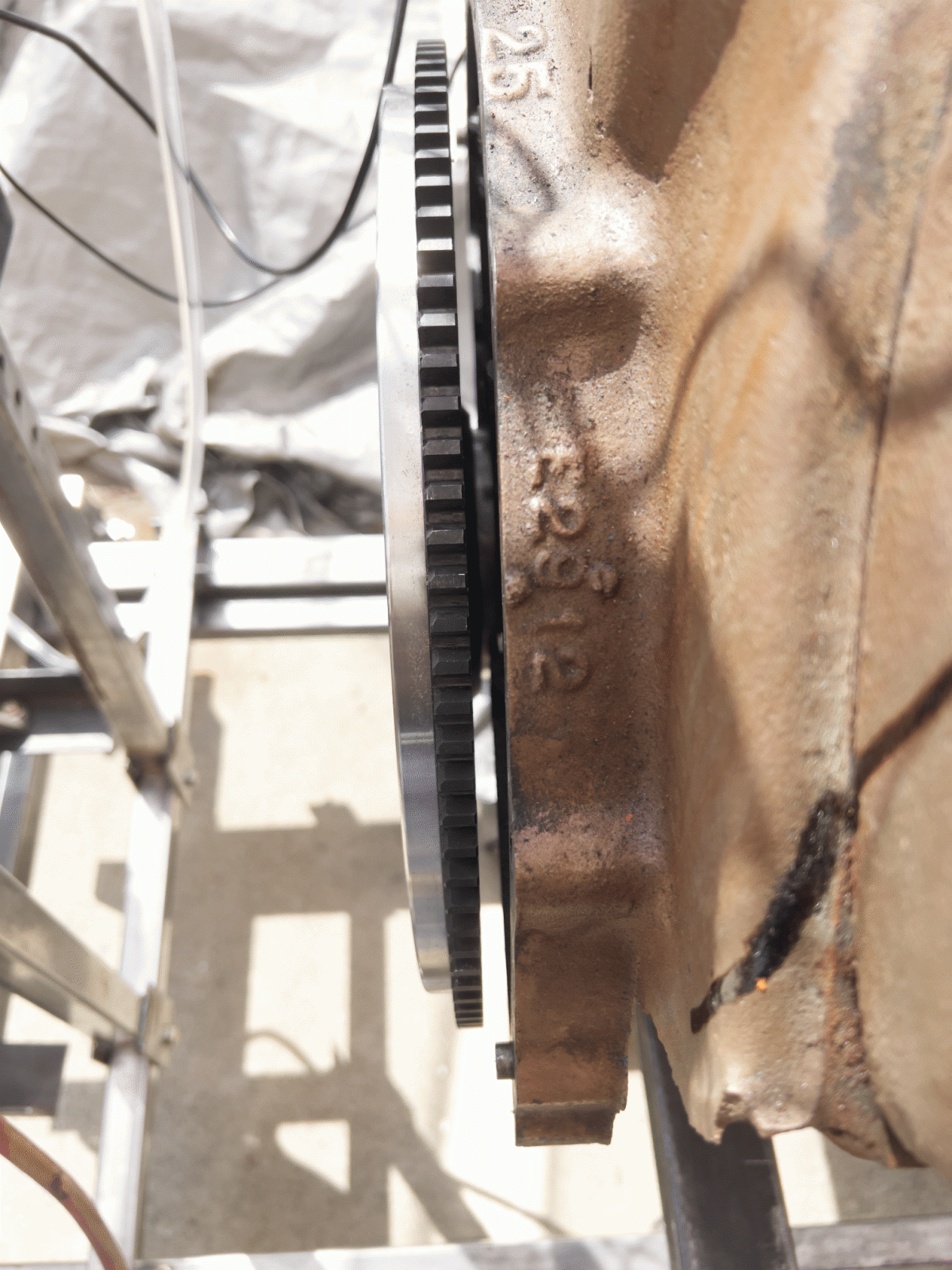

    Pulled the bell housing and starter plate off today. Double checked the starter plate and both mounting holes for the starter motor were parallel and the same distance from the plate bottom. Both bell housing and starter plate mount together flush with no signs of one or the other not being parallel to the engine block.
    Rotated the crank pulley to check the fitting of the flywheel and ensure it is parallel to the block. Visually everything looked ok but haven’t put the gauge on it to measure precise run out if present yet.
    I then proceeded to attempt to remove the cup from the bell housing. Hammering did not work so I thought bringing it over to the hydraulic press would do the trick. I stopped when some hairline cracks started to appear on the bell housing near the cup. It looks like these cups are quite set in there with the ends of the cup opening flanged after being pressed into the bell housing hole. I think my next move will be to cut off the cup with an angle grinder and leave about 1/2 inch of the tube length so I will have somewhere to weld a cap or fabricated cup when that time comes. Once I cut the cup end off then I will be able to see more clearly (I hope) what is going on between the teeth of the flywheel and the starter gear.
