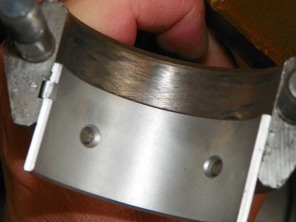

  4. ok below are the pics i have of the bearings, tangs, and connecting rod caps. the rod and cap is for one of the evens (i dont remember which one). the bearings fit the odds correctly. so the mounting tangs on the caps and connecting rods are on different sides for the evens and odds. the plastiguage was even if i recall correctly. i will try to check it again tonight and if its not still on there i will run the test again. when i tore the engine apart i stamped the bottom of the caps with the number and an arrow idicating to me front. as soon as i had one pulled out i put it back together so that the caps and rods did not get mixed up. i later found that the caps and rods were stamped with the number so that they can be matched up.

    Does using the shells shown in the other half (cap or rod) put them right? It looks like it would.
  6. are you asking if those bearing are correct to be used in the odds (rod and cap)?...
    if that is what you are asking then yes. those pics was from when i first got the bearings and was told they would work. but clearly they didnt. so then i got a differnt set of bearings just for the evens and they match with the tongs in the correct place.
  7. i dont have any other pictures are this point. but if you all need some. tell me what pics you want and i will get them. also sorry about the giant pics. i dont know nothing about re-sizing them.

    You have a wrong bearing set !! That engine uses 2different rod bearings , FM numbers are 1995CP for the evens and 1995CPA for the odds. Get the correct bearings for the odds and all will be fine. That engine is a take off of a Continental F series industrial engine andthey did the same thing. Sold part for both for years.

  11. for the bearings i have what i am going to call 3 set. i have 1 set (2 bearing parts for each rod. so a total of 6 individual bearings). for the evens. so each rod has the correct number and orientation of bearings.
    i then have 2 sets for the odds. (2 bearing parts for each rod. so a total of 6 individual bearings; x2 so 12 individual bearings)
  12. JohnEvans
    Joined: Apr 13, 2008
    Posts: 4,883
    JohnEvans
    from Phoenix AZ
    Bearings are considered as a pair [ieupper and lower] for one journal ,so what you have is 6 pieces equaling 3 pairs for 3 journals -rods. Cont used that odd setup on several engine series . As I said what you now need is 3 pair of 1995CPA in your needed size ,or another brand that interchanges with the FM number. This seems to be a common issue nowadays with off shore repo parts ,the ***es don't know what they are doing. Also some suppliers don't know/realise that the extra letter [A] makes a difference. Those bearings were used in all the Cont "F" series engines 4 &6 cyl. Those engines were in welders ,farm eq.,fork lifts etc.
  13. but i already have the correct bearings. they fit in the rods correctly. the pics i showed are from before i got the correct set. i have 3 pair of 1995CPA. my issue now is the ***emble locking up when i try to rotate it. the locking up only happens with the even numbers.

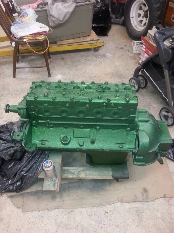

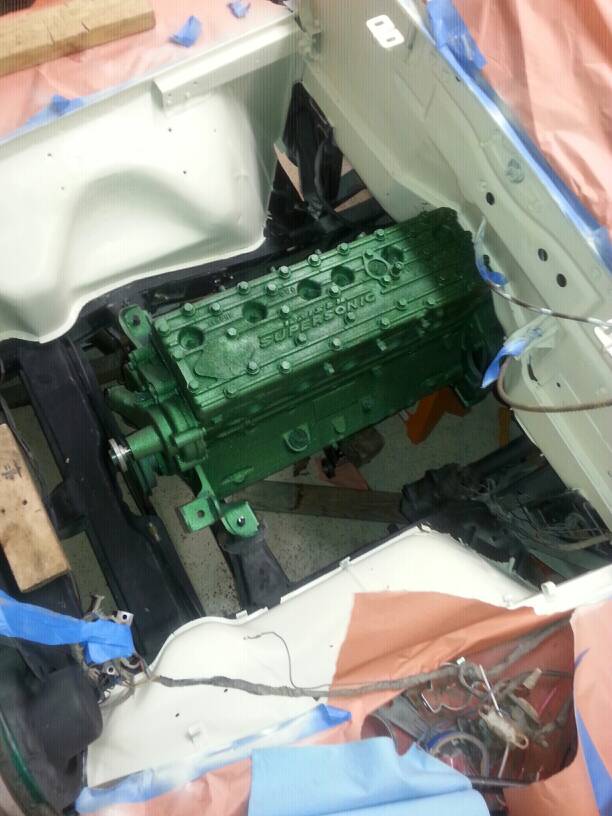

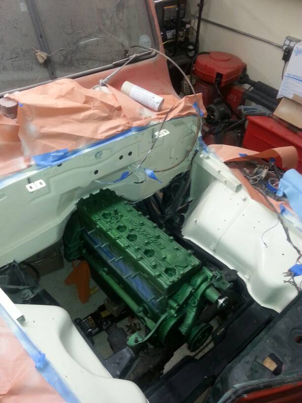

  27. Well engine is finally sitting in place.
