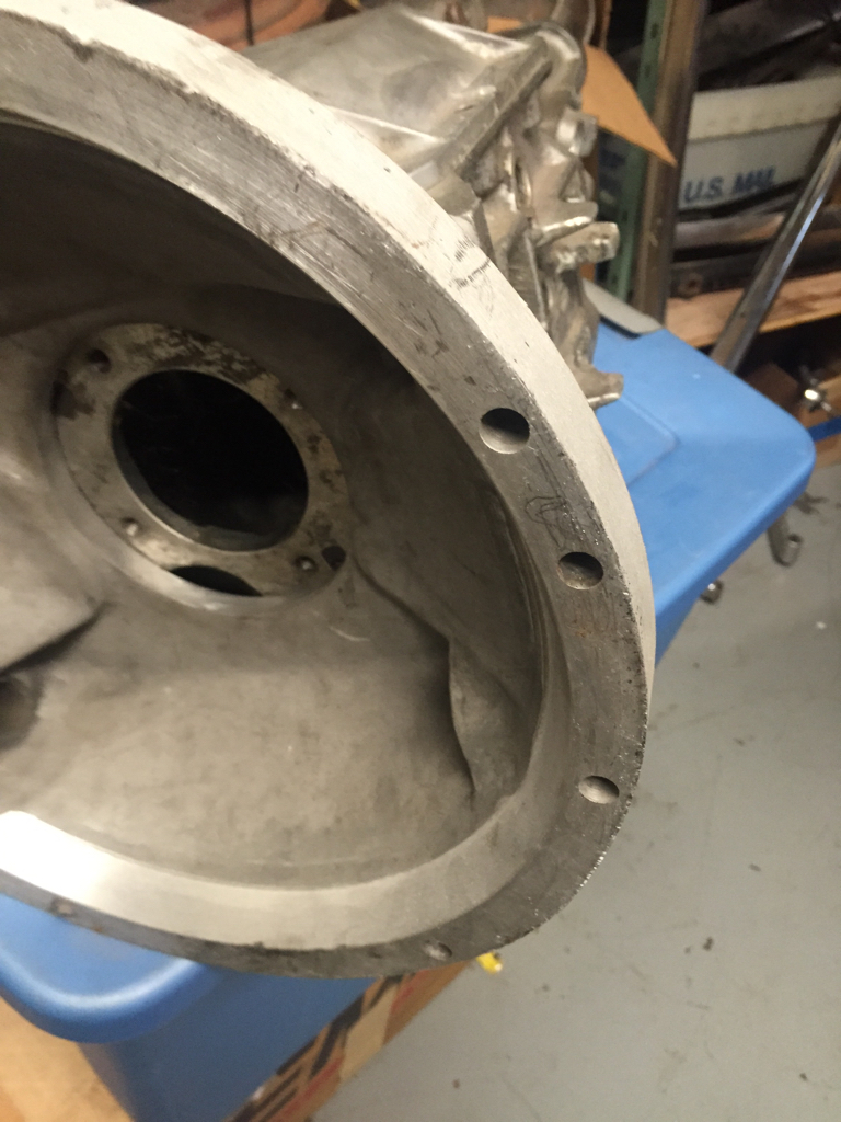

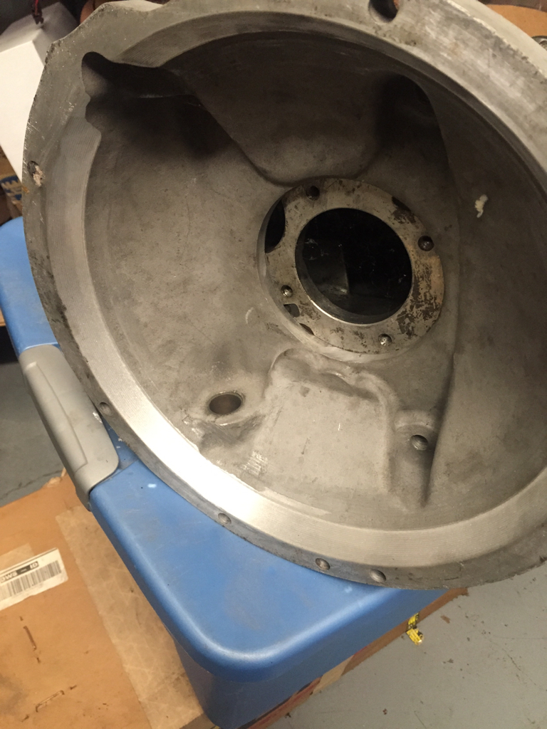

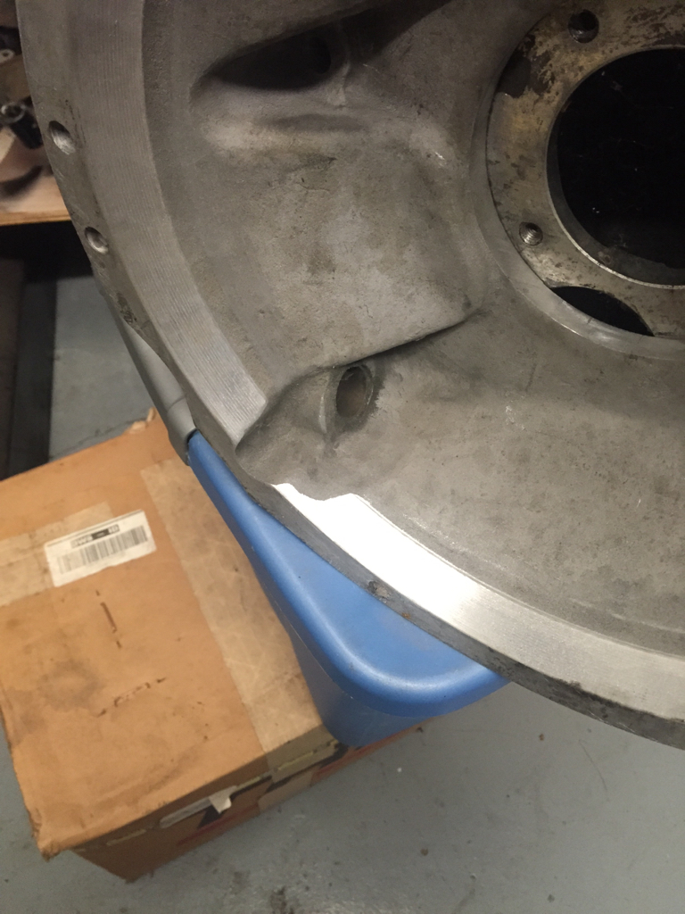

    Just circling beck here. Went with a diaphragm style plate per Cornhusker (krylon32 in this thread) and there are no issues at all so far. Plenty of clearance and the stock ford bits (bearing and fork) worked fine. Was able to drive it down the block and back into the garage no problem. No noise.
    Pedal feel is nice and light and has a sort of "breakover" to being super light as you get further into the pedal travel. (I've read this is typical with a diaphragm plate)
    Ended up spending some quality time with a flap wheel to make things right – my hat is off to Cornhusker. THANK YOU, SIR!
