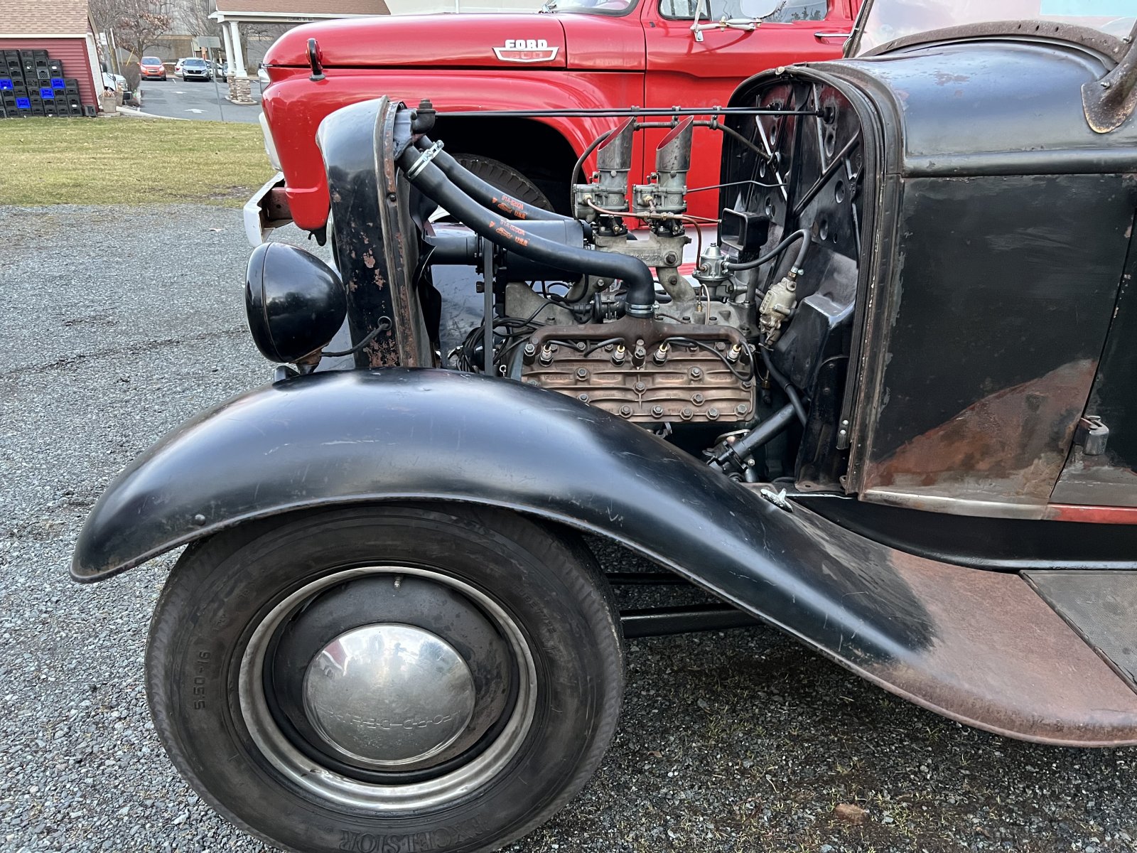

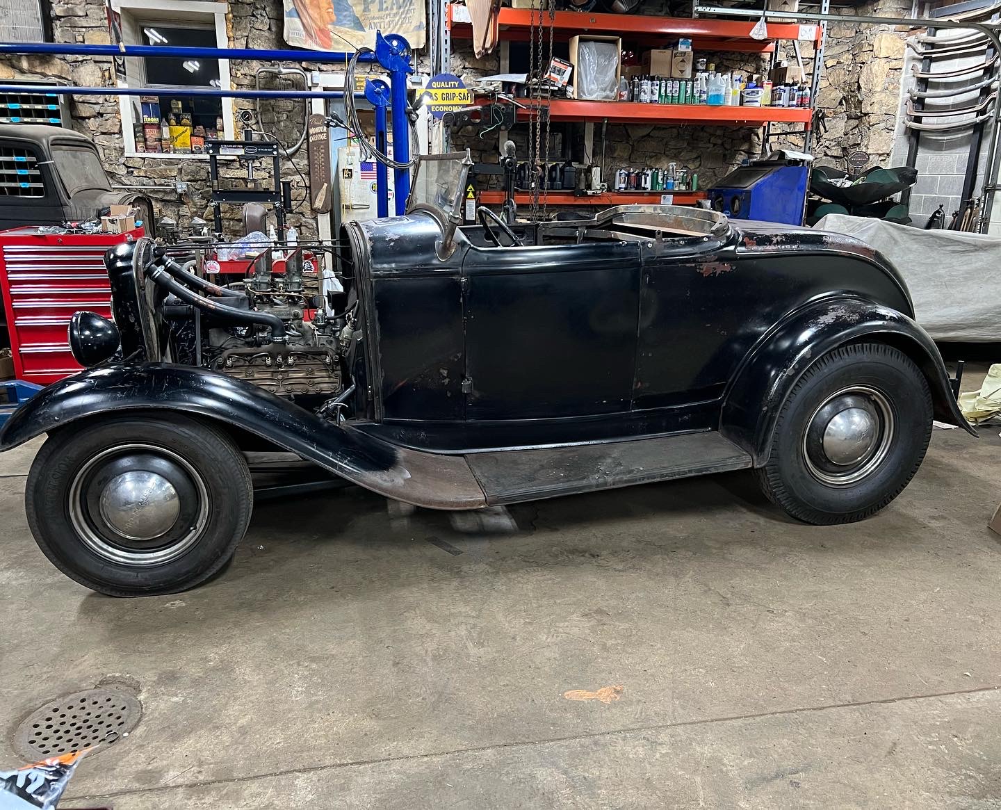

    On the run stand I think from ambient air temp to 190F the Federal Mogul Heads only got to 190F one to two minutes faster than the Weiand “S” aluminum heads just idling with no fan. That’s such a close number I’d call it negligible.
    CCB949F3-82F6-4CFB-81F8-89B2AB187727.jpeg AE7628EA-625D-4F9E-B91D-6A8D58089585.jpeg
    From what I’ve seen thus far driving the car (only driven it a small handful of miles because it’s middle of winter) the engine gets “heat” into it (from ambient temp to say 120F) more quickly than aluminum heads but it stalls out and then climbs slowly and at about the same rate as aluminum heads up to 180-190F. I can’t see running without water pumps at least on the street. Certainly some mystery around these but I can’t see the McGee car getting driven far/much without water pumps but hard to say!
